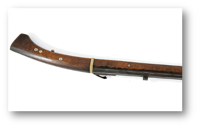

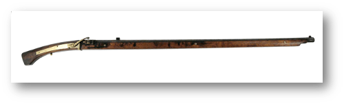

Caracal Posted January 5, 2021 Report Posted January 5, 2021 Hello I bought this Teppo many years ago and now I wonder when it may have been made. Do It differs from other rifles in manufacturing appearance etc .. // Robert Quote
Geraint Posted January 5, 2021 Report Posted January 5, 2021 Dear Robert. Your pictures are too small to tell a great deal. The overall design corresponds to what Sugawa calls flat butt guns. Have you dismounted the gun to see if it is signed? All the best. Quote
Bugyotsuji Posted January 6, 2021 Report Posted January 6, 2021 Kunitomo used to make this style of gun, a kind of simplified Tazuke-Ryu style. It will be Edo Period. Have you checked for a signature under the barrel? Quote
Viper6924 Posted January 6, 2021 Report Posted January 6, 2021 I agree with Piers. There’s a Kunitomo feeling to it when I see shape of the Hibasami (serpentine) and design of the sights. A very simplified version of a Tazuke ryu matchlock. If not Kunitomo, then surely Sakai 🙂 Jan Quote

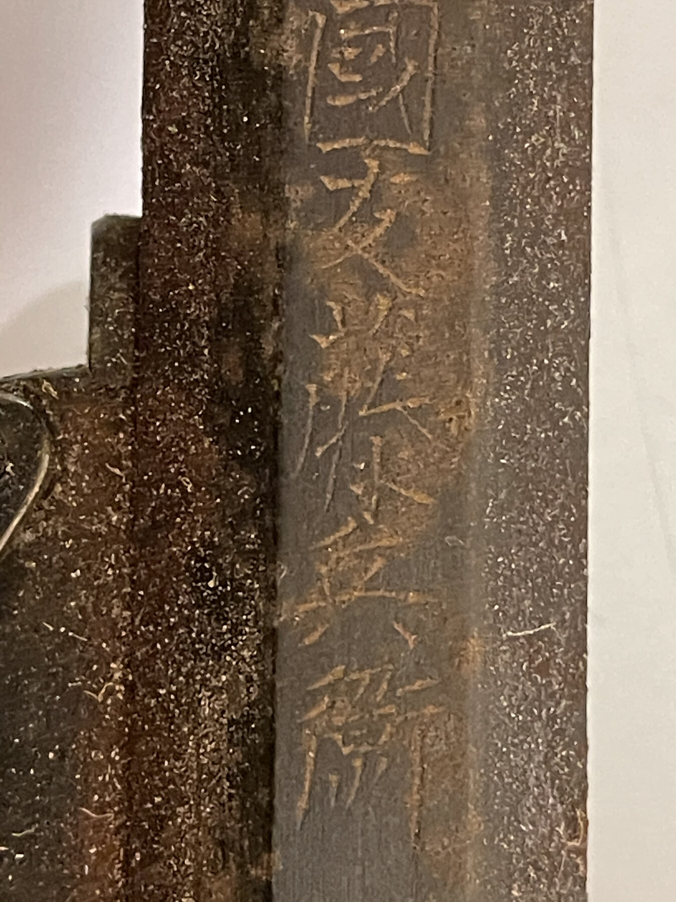

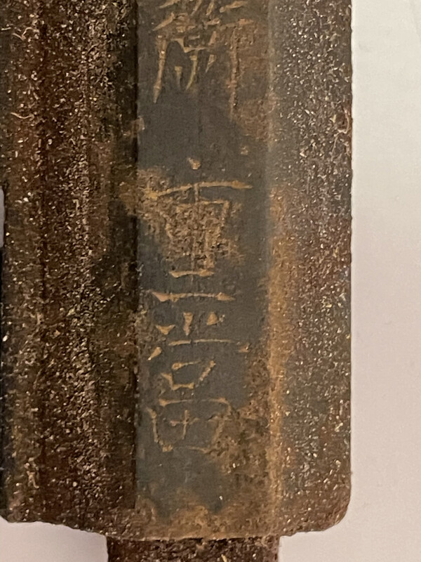

Caracal Posted January 25, 2021 Author Report Posted January 25, 2021 Hello, Now I have managed to open my Teppo. It was very hard at first. No one has opened it in many years. I found a signature and hope someone can interpret it for me. I do not know if the pictures are upside down but I hope you see it. All information about this Teppon is gratefully received // Robert Quote
