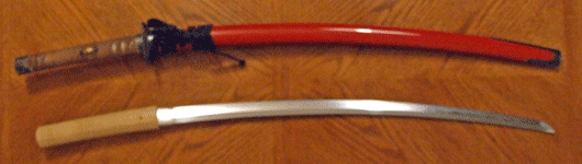

Hi Peter, What makes you attribute the koshirae as being a Satsuma rebellion piece? They are fairly distinctive and have certain characteristics. Are you going by the colour of the ito? I am not trying to interfere, just wondering. Here is a pic of one I have. Not a great pic. It has very simple plain iron fittings, tan ito, mass produced tsuba and a common red urushi lacquer. Not for sale, but, what I thought of as typical. John

The whole koshirae gives the impression of being hastily assembled. The tsuka is not original to the sword and has been adjusted to fit in the 19th century, same with the habaki. It has the typical ito you find on Satsuma rebellion blades and tortiseshell lacquer.
It's not rare to see bundles of Satsuma rebellion swords turn up in the UK, presumably a result of trade with Satsuma in the 19th century?
Your koshirae looks much nicer than the ones that turn up here. Quite often the tsuka's are made from broken saya and you can see the original lacquerwork under the ito. It is quite suprising what blades you can find in these mounts, a friend found an 8th generation Tadayoshi.

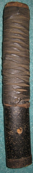

This one might remember something to someone... it sure remind me of a good lesson.
I can safely say that it is the most horrilbe mount that i have ever seen, for reference only Mr Stewart, as the blade is unavailable for photo.
This tsuka was taken from a Satsuma rebellion katana. The tsuka is made from an old lacquered saya. You can see the kozuka pocket slot on the inside of the tsuka. No menuki just a roughly done binding.

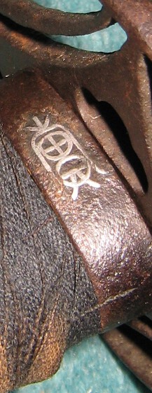

This fuchi with the Shimazu clan mon was present on another sword I had in rebellion mounts. Conclusive proof it was from Satsuma.
Peter
