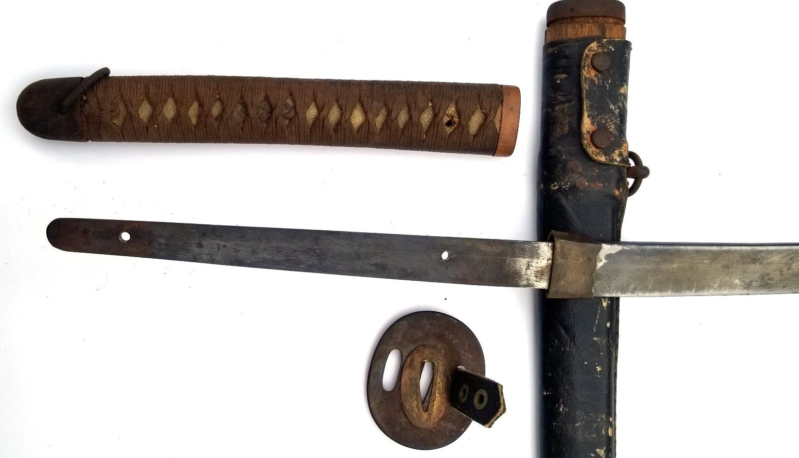

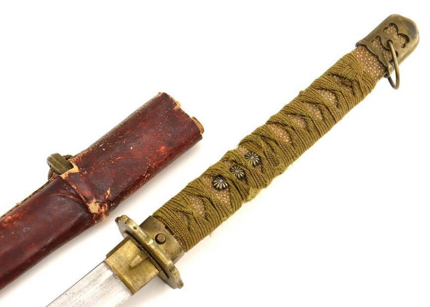

Kiipu Posted January 8, 2022 Report Posted January 8, 2022 (edited) On 12/15/2021 at 3:59 AM, Bruce Pennington said: Another one currently at a Sofe Auction: Expand This seems to be a variant of the plain brass Chinese version; however, the menuki is of a different style than the others that are pictured on the various forums. The small differences that appear in these Chinese versions could indicate production from more than one location? The survival rate seems high and this would seem to indicate a decent amount of them were manufactured during the war. Several have direct connections to veterans that brought them back. Another unusual sword Quote This is one of the poorly made swords likely made as replacements. I have owned several of these and all have had the identical silver tsuba and poorly shaped tangs. All of the ones that I veteran purchased were found in China. I have always thought that these were made in theatre and were to serve a purpose until a proper replacement could be had. None of the ones I have ever handled have any temper in the blade. This is a model sword rarely encountered. Most collectors have looked at them as being fakes but in my opinion, they are just poorly made swords. Expand ww2 sword?, Post #18 Edited January 8, 2022 by Kiipu 2 Quote
Kiipu Posted January 10, 2022 Report Posted January 10, 2022 And another one that I ran into by accident over at SFI, it appears to be the plain version that I associate with Chinese use. Japanese samurai sword ??? 2 Quote

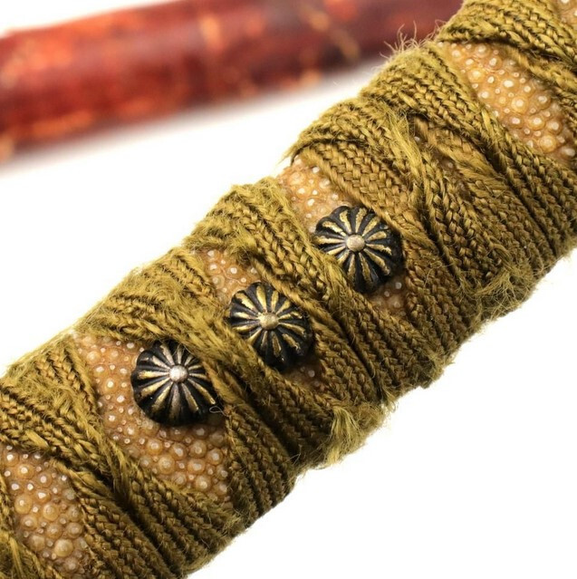

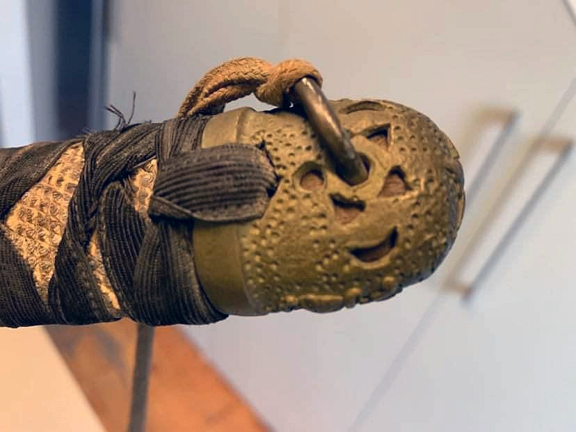

Kiipu Posted November 4, 2022 Report Posted November 4, 2022 On 10/23/2021 at 5:52 AM, Bruce Pennington said: There is an interesting gunto posted ON THIS RUSSIAN SITE, that I think is original. Dated Feb 1945, it has poor quality Type 98 tsuka/tsuba, but really poor quality RS saya, black painted. Expand I have been working on this one for awhile and today I finally closed the books on it. The maker is Yoshitada 義忠 and I think he hails from Gifu Prefecture. I base this on one that has a small Seki 関 stamp that is for sale on eBay. WWII Japanese Army officer's samurai sword shin gunto Untouched Mint WW2 @mecox 4 Quote

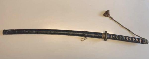

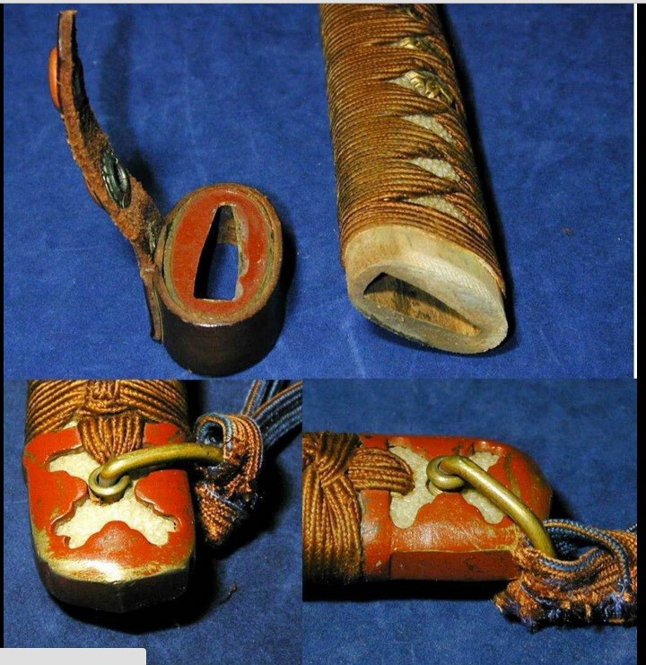

Bruce Pennington Posted November 7, 2022 Author Report Posted November 7, 2022 Found one of the 'standard' late-war kabutogane on this frankenstein: Could be a pieced-together very late war gunto, or just a Bubba-job post war. It's missing a tsuba, but he seppa has what's left of a leather retention strap: so it would imply the wooden saya came with the sword. Making it worse, though, is the blade is a Showa-stamped Yoshimitsu. The Showa stamp died off by 1942, so if this was a late-war monster, the blade would have had a re-fit at the end of the war. Quote

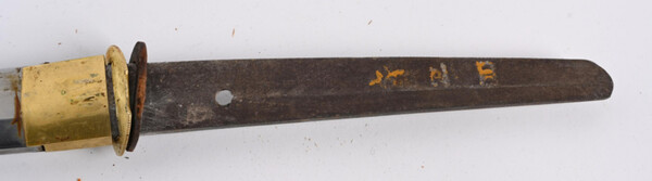

John C Posted November 30, 2022 Report Posted November 30, 2022 Bruce: Could this be a variation of a late war emergency stamp? https://www.ebay.com/itm/295367094149?hash=item44c5402f85%3Ag%3AFYQAAOSwGvZjgUs0&amdata=enc%3AAQAHAAAAoE2vtf1G0e6%2BYCRzQdr5e1FQNMgrEltgGeArcOmW7ZbSnRt2aUALk6H6UmPegZB3KZaTm9VpsjRGd%2BJcf9Bp8DOQiviWJgLA%2BQsAEM5XixxkYgVQ0IXqhjD%2FMWgB%2FzNRiGrMzBRb4VmyPhekf5%2BHOvMmhmIHPntWMq4xGMKSBBBjYDx6lZyE7fjUZxHj0%2FF%2BtKq6H3IjPf5QJygz0VMdhI4%3D|tkp%3ABk9SR8iMk-iYYQ&LH_ItemCondition=4|10 John C. Quote
BANGBANGSAN Posted November 30, 2022 Report Posted November 30, 2022 On 11/30/2022 at 3:23 AM, John C said: Bruce: Could this be a variation of a late war emergency stamp? https://www.ebay.com/itm/295367094149?hash=item44c5402f85%3Ag%3AFYQAAOSwGvZjgUs0&amdata=enc%3AAQAHAAAAoE2vtf1G0e6%2BYCRzQdr5e1FQNMgrEltgGeArcOmW7ZbSnRt2aUALk6H6UmPegZB3KZaTm9VpsjRGd%2BJcf9Bp8DOQiviWJgLA%2BQsAEM5XixxkYgVQ0IXqhjD%2FMWgB%2FzNRiGrMzBRb4VmyPhekf5%2BHOvMmhmIHPntWMq4xGMKSBBBjYDx6lZyE7fjUZxHj0%2FF%2BtKq6H3IjPf5QJygz0VMdhI4%3D|tkp%3ABk9SR8iMk-iYYQ&LH_ItemCondition=4|10 John C. Expand upside down 順 Quote
Bruce Pennington Posted November 30, 2022 Author Report Posted November 30, 2022 On 11/30/2022 at 3:23 AM, John C said: variation of a late war emergency stamp? Expand I see the vague similarity: The pictures aren't great on that sword, but I'd bet it's an occupied territory sword. On 11/30/2022 at 3:33 AM, BANGBANGSAN said: upside down 順 Expand Trystan, any idea of meaning or significance? Quote
BANGBANGSAN Posted November 30, 2022 Report Posted November 30, 2022 On 11/30/2022 at 1:57 PM, Bruce Pennington said: upside down 順 Trystan, any idea of meaning or significance? Expand Success/Well/Smooth Quote
Bruce Pennington Posted November 30, 2022 Author Report Posted November 30, 2022 We are starting to see a small collection of stamps on these collaborator swords. No way to know if they are each from a smith, or a shop/forge. In the old days, I would have said they are simply random Chinese kanji to imitate Japanese markings. But I think the forge idea is shaping up to be the case. 1 Quote
Dave R Posted December 2, 2022 Report Posted December 2, 2022 On 11/7/2022 at 2:27 PM, Bruce Pennington said: Found one of the 'standard' late-war kabutogane on this frankenstein: Could be a pieced-together very late war gunto, or just a Bubba-job post war. It's missing a tsuba, but he seppa has what's left of a leather retention strap: so it would imply the wooden saya came with the sword. Making it worse, though, is the blade is a Showa-stamped Yoshimitsu. The Showa stamp died off by 1942, so if this was a late-war monster, the blade would have had a re-fit at the end of the war. Expand Just to say that from the Japanese perspective 1942 is "very late war" to quote... "The beginning of the war is conventionally dated to the Marco Polo Bridge Incident on 7 July 1937, when a dispute between Japanese and Chinese troops in Peking escalated into a full-scale invasion. Some Chinese historians believe that the Japanese invasion of Manchuria on 18 September 1931 marks the start of the war. This full-scale war between the Chinese and the Empire of Japan is often regarded as the beginning of World War II in Asia." .....https://en.wikipedia.org/wiki/Second_Sino-Japanese_War It was the wartime shortages of needed resources that drove Japan to war with the US and UK in 1941, primarily oil, but also steel and other materials. Nicely summed up by this US propaganda leaflet dropped on Japan. 3 1 Quote
Bruce Pennington Posted December 2, 2022 Author Report Posted December 2, 2022 On 12/2/2022 at 10:45 AM, Dave R said: from the Japanese perspective 1942 is "very late war" Expand Yes. When you read their stories/book of WWII, it was an 8 year war for them! It's interesting that several changes started occurring in '42/'43 like manufacturing regulations, SMR changed their mei, and even inspector stamping procedures. I think the term is used mostly, in Sword-World, though to denote the dramatic changes we see in swords of the final year of the war. Quote

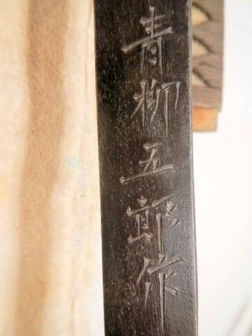

BANGBANGSAN Posted December 9, 2022 Report Posted December 9, 2022 @Bruce Pennington Here is an interesting one,長江興亜刀 Yangtze River Koa sword,青柳五郎作 Gorou Aoyagi Saku. I think it's could be a Japanese swordsmith or IJA Gunto repair team member who made this sword at the location near the Yangtze River in China during ww2. The fitting is very similar to an territory/island swords I've seen before. This is the territory/island sword that I mentioned. Nothing on both sides of the tang. 4 1 Quote
Bruce Pennington Posted December 9, 2022 Author Report Posted December 9, 2022 On 12/9/2022 at 1:06 AM, BANGBANGSAN said: 長江興亜刀 Yangtze River Koa sword, Expand That's quite a fascinating mei, Trystan! Any idea what it is trying to say? Was it part of a group taking a Yangtze river area for the "United Asia" effort? Quote

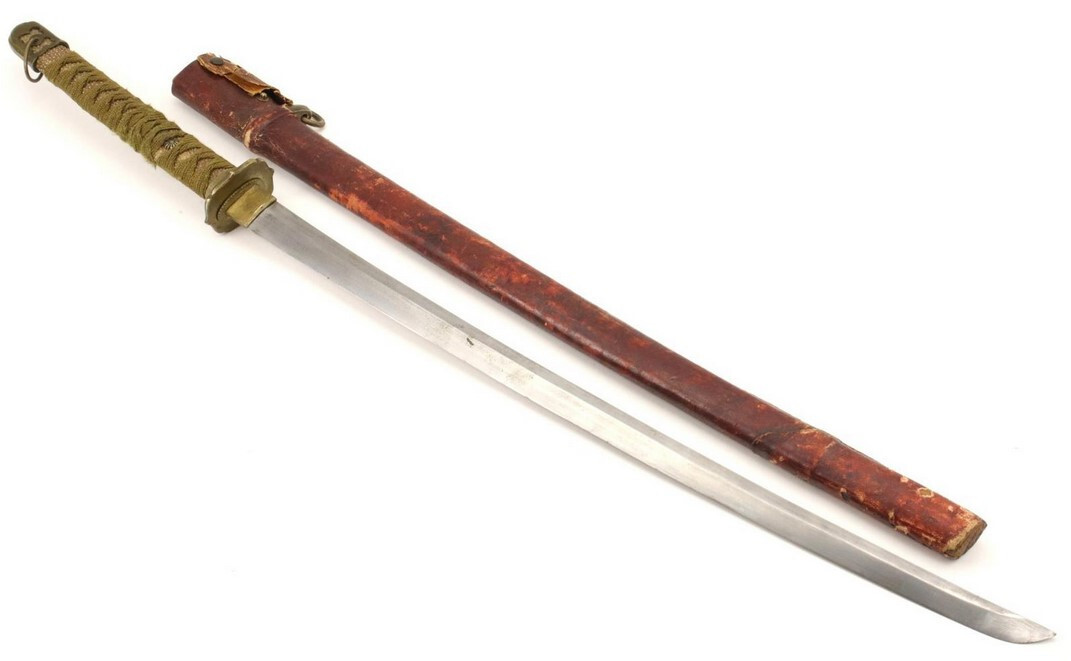

Bruce Pennington Posted December 12, 2022 Author Report Posted December 12, 2022 Here's one with the standard late-war kabutonage. Braxtons Auction- Hibid 1 Quote

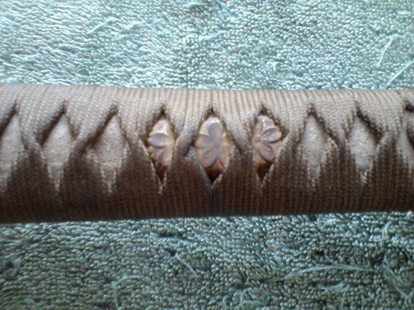

Dave R Posted December 13, 2022 Report Posted December 13, 2022 On 12/12/2022 at 4:44 PM, Bruce Pennington said: Here's one with the standard late-war kabutonage. Braxtons Auction- Hibid Expand I think that is one of the Chinese made swords. This is one of my late war examples from Japan. 1 Quote
Dave R Posted December 13, 2022 Report Posted December 13, 2022 ... Here is another... which looks perfectly standard, til you use a magnet and find all the metal is stamped iron or steel and plated to look regulation.. 1 Quote
Bruce Pennington Posted December 13, 2022 Author Report Posted December 13, 2022 On 12/13/2022 at 12:06 PM, Dave R said: Chinese made Expand I think you're right. Purple'ish same', poor wrap, and long thin sarute. Quote
Bridges Posted December 13, 2022 Report Posted December 13, 2022 @Bruce Penningtonnice read, I would get this easily confused with a fake due to the poor quality Quote
Bruce Pennington Posted December 14, 2022 Author Report Posted December 14, 2022 On 12/13/2022 at 11:46 PM, Bridges said: I would get this easily confused with a fake due to the poor quality Expand And that has been what's plagued this 'genre' of sword for so long. The quality of the Chinese territory and 'island made' swords was so poor compared to mainland Japan, that they are near impossible to distinguish from the modern fakes. But we have been discovering documents (thanks to Kiipu and Bangbangsan) showing swords were being made 'over there' and we're building some experience in spotting them. 1 1 Quote

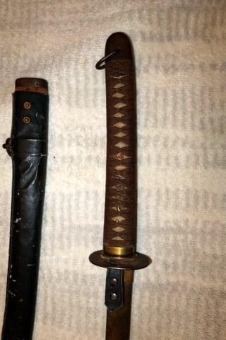

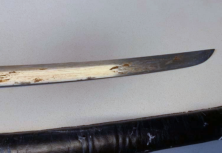

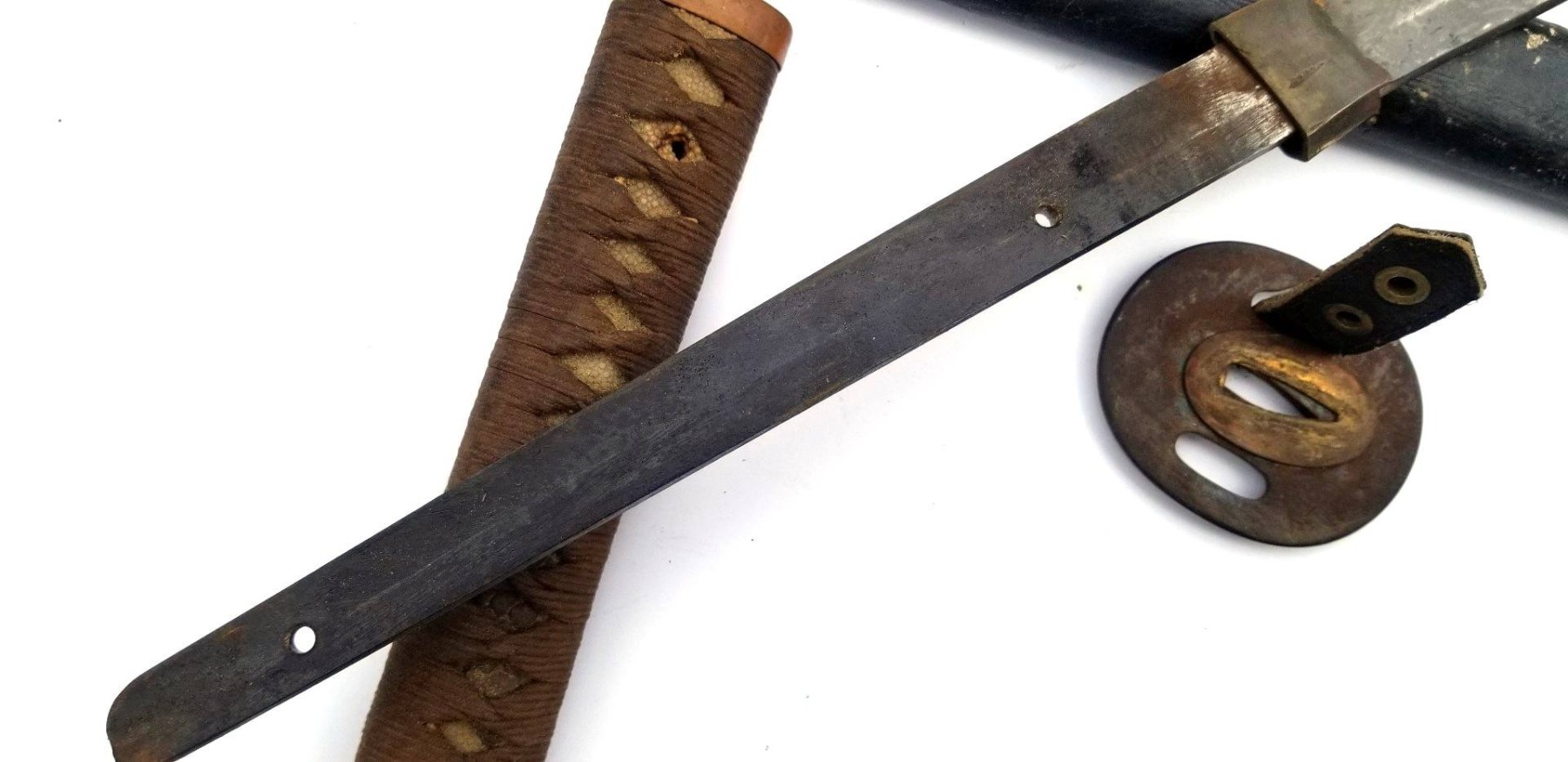

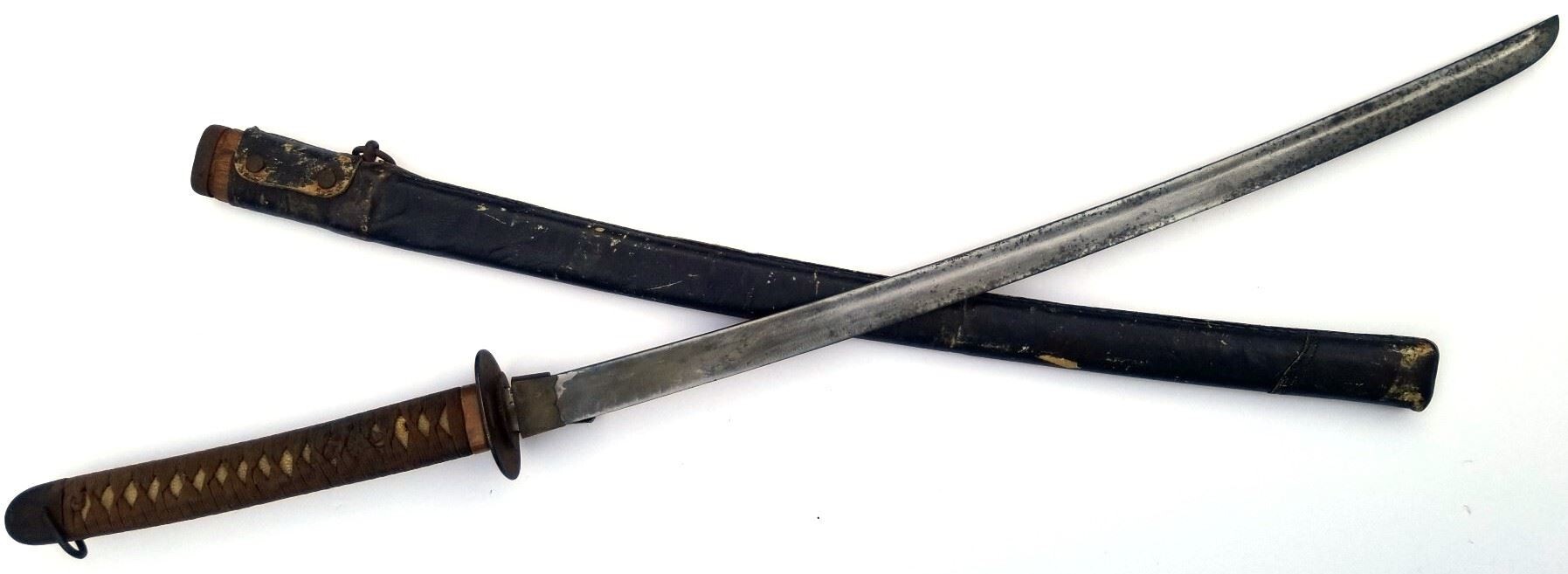

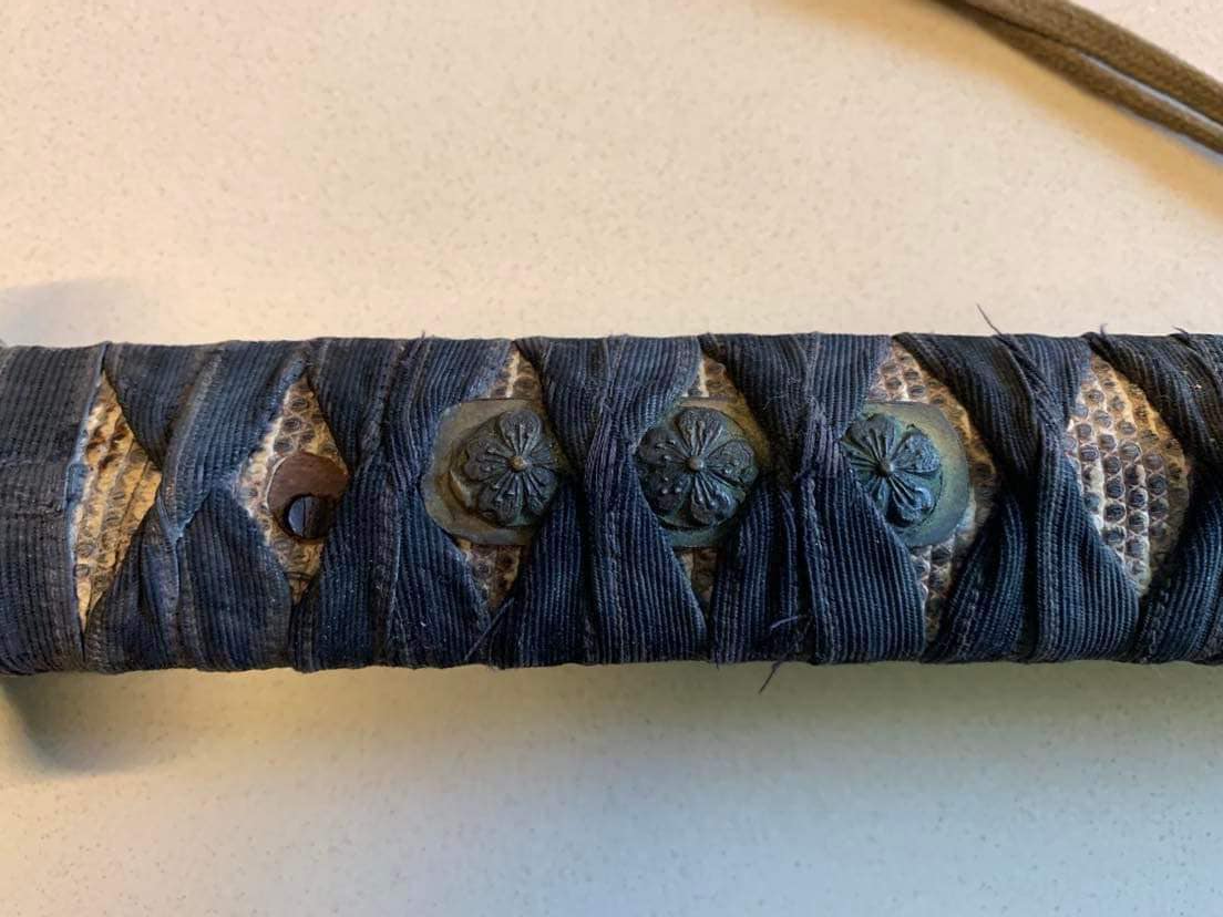

vajo Posted December 17, 2022 Report Posted December 17, 2022 Found that in the Nihonto Collector Group in Facebook. I told the owner to ask here in the board. Could that be a island sword? What you think? The sword is rough made with improvised cast fittings. He said it is a family heirloom from his uncle who had it from a Japanese officer in guinea. It's obvious not Japanese made but it looks not like the typical chinese made repros. The ito looks like made from stripes of cloth, a blue jacket or trousers. The same is iguana or something else. 1 Quote
Brian Posted December 17, 2022 Report Posted December 17, 2022 I saw the FB post. The fittings are crudely cast, with not much effort made to replicate originals. I vote a roughly made island sword, maybe made in the occupied territories. It's not a modern fake, but maybe even made just after the war for sale to soldiers? 1 Quote
