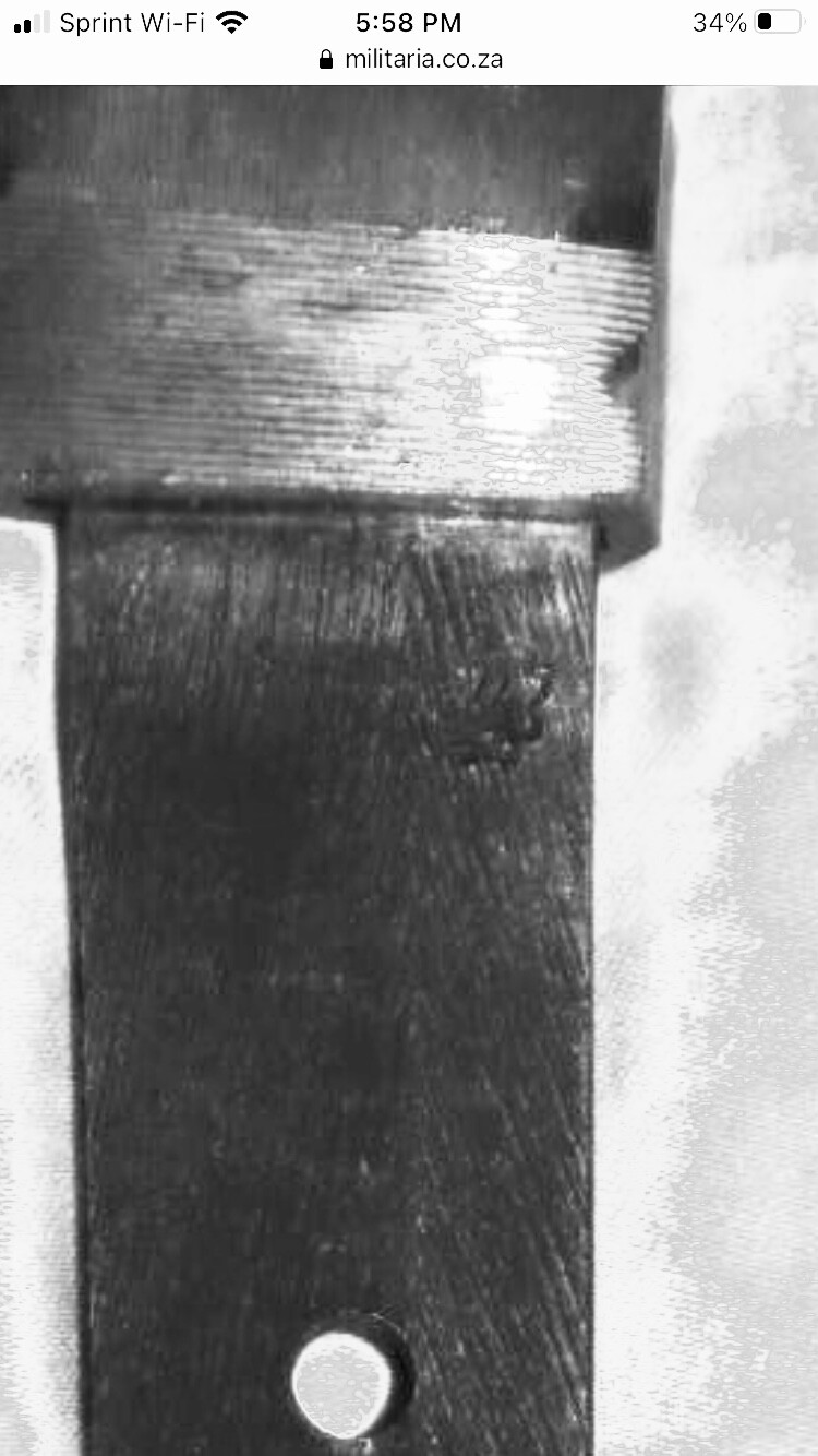

On 12/28/2020 at 2:04 AM, Bruce Pennington said:
Improved the pics a bit.  Just got to my computer, and you are right about it being a Showa stamp.  When you get the sword, check the other side for a date, if there is one.  I'd appreciate it.
Hello,
With apologies for the delay updating this, I now have the Kanenao sword in hand, so I have been able to take some new pictures of it. It now looks to me like there is some very faint writing on the opposite side of the nakago, and possibly also something just below the signature itself:
I don't see anything under the signature.
The reverse side has painted markings on it - we usually call them assembly numbers, probably used to help match the sword with its intended furnishings. In this sword it looks like it says 白八 (white 8).
Thanks for the added photos Etienne!  I noticed your dating question from back in Dec of 2020, sorry no one tried to answer yet, but both blades were made during the war.  As they are not dated, it's really not possible to pin them down to a specific year.  The Kanenao, with a Showa stamp COULD be in the 1940 plus/minus range.  Most dated blades with the Showa stamp, in my survey, are 1940/41.  I'll post my chart below.  The problem lies in that out of the 176 Showa-stamped blades I have on file, only 42 of them are dated!  So, when were the non-dated blades made?  No one can say for sure.  You'll find the same issue on old Nihonto.  There are far more undated blades than dated.
The mostly likely year for the Yoshimitsu blade would be 1942.
