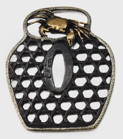

Brian Posted December 25, 2020 Report Posted December 25, 2020 Was asked off the forum what anyone thinks of this: https://www.bonhams.com/auctions/22815/lot/156/ It's good. But I don't think Omori good. Quote

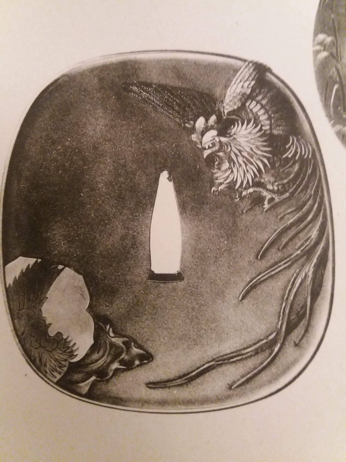

Gakusee Posted December 25, 2020 Report Posted December 25, 2020 Brian, I am not Tosogu expert but this is a late replica and not that good. Also, if you notice the careful language Bonhams have used. Always beware when they say “after”, “in the style of”, etc. Clever language indicating that it is an imitation. Herewith attached for reference the real thing. 1 Quote
Ford Hallam Posted December 25, 2020 Report Posted December 25, 2020 A careful examination of the enlarged images shows quite clearly that this is a modern cast copy. Steel casting with electroplated details in silver and gold on an initial copper flash plating. The copper base plating is typical of industrial processes, it adheres well to the steel so that the silver and gold has an easier bond to the copper rather directly onto the steel. 3 1 1 Quote
Surfson Posted December 25, 2020 Report Posted December 25, 2020 It's also usually helpful to look for any evidence that a tsuba has been mounted. The seppa usually cause wear and protect the seppadai from corrosion, or cause corrosion in the seppadai, depending on the metals. There is no evidence that this tsuba was ever mounted. The plate also doesn't look like it was forged. Quote

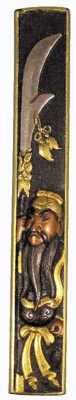

kissakai Posted December 25, 2020 Report Posted December 25, 2020 Sorry to sidetrack Do you think this is OK Quote
Yasaka Azuma Posted December 26, 2020 Report Posted December 26, 2020 On 12/25/2020 at 6:53 PM, Ford Hallam said: A careful examination of the enlarged images shows quite clearly that this is a modern cast copy. Steel casting with electroplated details in silver and gold on an initial copper flash plating. The copper base plating is typical of industrial processes, it adheres well to the steel so that the silver and gold has an easier bond to the copper rather directly onto the steel. Expand An image that proves your opinion. ↓As you can see, no translation is needed. https://twitter.com/yakozen777/status/1195466920281038848 1 Quote
Gakusee Posted December 26, 2020 Report Posted December 26, 2020 Grev/Kissaki In one word, ‘no’. Quote
kissakai Posted December 26, 2020 Report Posted December 26, 2020 (edited) Though so - at least this post wasn't side tracked for long! Edited December 26, 2020 by kissakai Added extra info Quote
Spartancrest Posted December 26, 2020 Report Posted December 26, 2020 Yas. Good work, there is a growing list of these 'good fakes'. We really must make a comprehensive list to avoid falling for them. If I had paid £ 2,125 (AU$ 3,795) to a bona fide auction house for that $20 replica I would be very, very unhappy! Grev. I personally think your example has a more pleasant visage of the man, certainly less surprised! [Authentic or not] 2 Quote
PietroParis Posted December 26, 2020 Report Posted December 26, 2020 On 12/25/2020 at 6:53 PM, Ford Hallam said: A careful examination of the enlarged images shows quite clearly that this is a modern cast copy. Steel casting with electroplated details in silver and gold on an initial copper flash plating. The copper base plating is typical of industrial processes, it adheres well to the steel so that the silver and gold has an easier bond to the copper rather directly onto the steel. Expand Are those greenish stains evidence of the copper base plating? I see a few of them even on the “iron” area near the rim. Quote

Rodenbacher Posted December 26, 2020 Report Posted December 26, 2020 Somebody in Germany tried to sell me another example of the rooster Tsuba which was exactly like that in the Bonham's auction and he even told me that it was the Bonham's piece, he won the auction. In fact it was just another copy of that. I had it in hand and on the first glance it looked okay, but on the second I could see that it was not made by a tsubako, no traces of chiseling, no nuances, no traces of wear or age - anything very lifeless, very industrial. But it was nearly perfectly made, don't underestimate the fakers, and I think without a lot of experience someone will easily step into that trap. 2 Quote

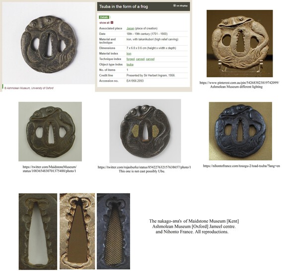

Spartancrest Posted December 30, 2020 Report Posted December 30, 2020 Brian, I will take your offer and post this picture of the tsuba from the opening post. If I might add another to ponder on, also from a Bonhams auction. https://www.bonhams.com/auctions/26087/lot/1147/ What thoughts on this piece? 1 Quote

Bernard Posted December 30, 2020 Report Posted December 30, 2020 The kozuka illustrated in Yakozen tweet (cf the link provided by Yas in post #6) reminds me of the kozuka I posted on this forum in 2013: Quote
Gakusee Posted December 30, 2020 Report Posted December 30, 2020 On 12/30/2020 at 12:34 AM, Spartancrest said: Brian, I will take your offer and post this picture of the tsuba from the opening post. If I might add another to ponder on, also from a Bonhams auction. https://www.bonhams.com/auctions/26087/lot/1147/ What thoughts on this piece? Expand Dale, Bonham’s has lately been selling a lot of these replicas or imitations. I have spent numerous hours also being tempted and even viewing items in person, hoping it would be a genuine article. Unfortunately, I have often been disappointed. As mentioned, notice the careful language: ‘Hamano-style’ and “After Iwamoto Konkan’. So, even though their descriptions correctly stipulate that both tsuba bear the name and mei of the famous maker, Bonham’s carefully directs the reader way from the actual master and points towards another maker. 2 Quote

Spartancrest Posted December 31, 2020 Report Posted December 31, 2020 Yas. They are getting better fakes every day - it is getting very difficult to tell from auction photos - you need to see in hand but that is not always possible. Michael. Yes they cover their tracks with those disclaimers, Bonhams though missed out badly on that Konkan [or is it Konkwan?], someone didn't do their research very well - they could have added some provenance on that guard as having once belonged to Marcus B. Huish a prominent early collector and writer on the subject. I was hoping someone would pick up on this when I included it in the post - sadly not. At least we have a rough time line when the piece was made - prior to 1912. 2 Quote
