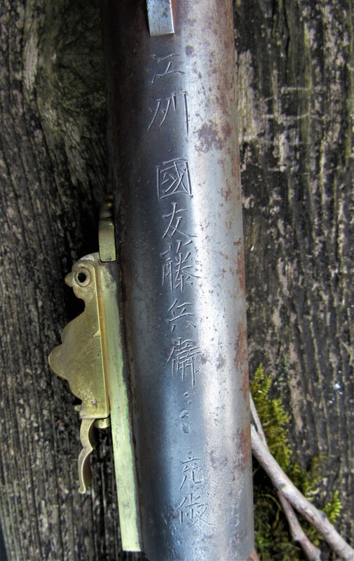

Bugyotsuji Posted December 24, 2020 Report Posted December 24, 2020 Hi Tom, and welcome. There is plenty of information here on this NMB site, and photographs too if you dig around. It is hard to judge what you have from that one shot, but I can say that it looks like a good quality Japanese Tanegashima matchlock of perhaps the early/mid 1800s. It was made in Kunitomo, perhaps the most famous gunsmith community, by 国友藤兵衛 the House of Kunitomo Tobei (the final individual artisan name 充淑 Atsutoshi, indicates that he was a child of the famous Kunitomo Ikkansai who was born in 1778). There were at least two main lock types, with either a visible external or hidden internal spring. So many questions from you in one post! The serpentine head drops yes, and not too violently, but does not stop in mid-air. It kind of hits the pan lid, or the open pan, enough to dump the burning match into the priming powder. Screws were not generally used as you say. Ramrods were generally a single tapered wooden rod, but new-fangled affairs appeared towards the end of the Edo Period. It is not clear from your post what you are describing. Is it a brass rod linked in some way to the muzzle? 1 Quote
Brian Posted December 24, 2020 Report Posted December 24, 2020 Piers, He has a link just above the pic, to an image gallery: https://imgur.com/gallery/N3hExgX 1 Quote
uwe Posted December 24, 2020 Report Posted December 24, 2020 The first two kanji “江州” (Gōshū) are the province. In this case “Omi“. I’ve struggled wit the last two characters of “Tobei”...... Thanks Piers! Nice teppo Tom!!! Quote

Bugyotsuji Posted December 25, 2020 Report Posted December 25, 2020 Tom, Mr Yoshida is a good man. Jan, Anthony and I spent many happy hours there with him a couple of years ago. He has given you a good answer. Some parts of your gun, such as the ribbed effect throughout the lock work are highly unusual. The zogan also looks of better quality, using precious metals such as silver. Perhaps this was a special order. The best ramrods were a straight tapering stick of 赤樫 Akagashi red oak with a flat head and a hole close to the narrow end to insert a cleaning cloth. Yours sounds like a Western addition, or a neat Western idea adapted in the mass of innovations and confusion towards the end of the Bakumatsu. I would keep it as part of the package as a spare. Again there are threads and pictures on this site somewhere! Look for keywords Karuka, ramrod, scouring rod, etc. *Note that Jushuku is an alternative reading for Atsutoshi and either would have been fine. Perhaps Jūshuku sounds more ‘classical’. Only the smith himself could tell you for sure how he wanted those Kanji to be read. Quote

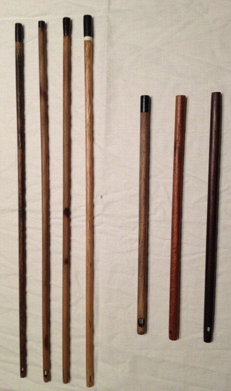

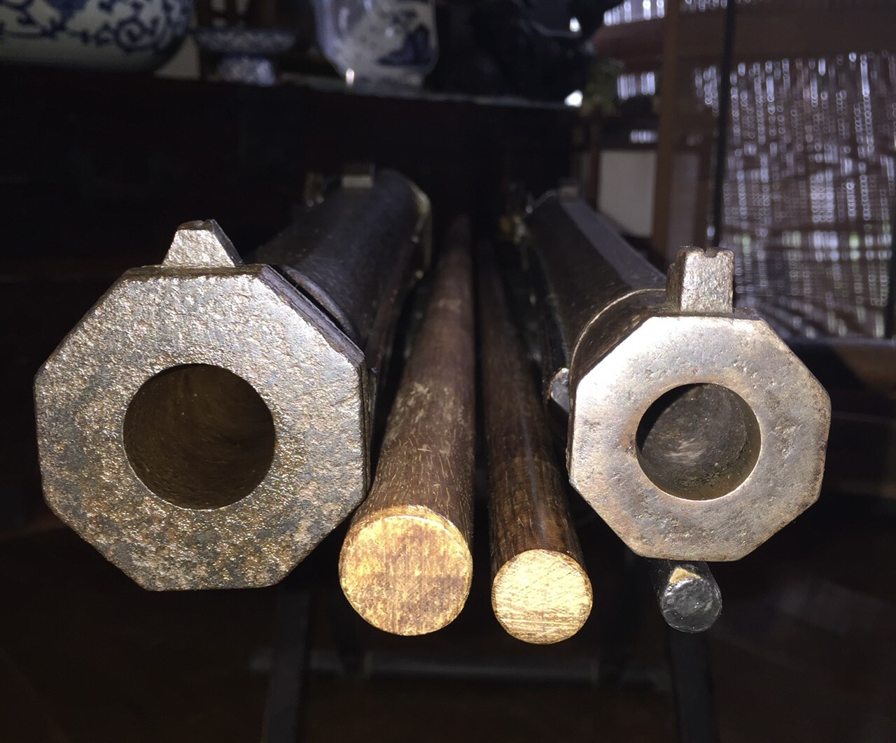

Bugyotsuji Posted December 25, 2020 Report Posted December 25, 2020 Well all my photos are already posted here and there, but here we are again with a couple. Quote
twines Posted December 25, 2020 Author Report Posted December 25, 2020 Thanks. Some appear to have tips. Can't tell if the tips are brass or steel. Quote
Bugyotsuji Posted December 26, 2020 Report Posted December 26, 2020 The tips are usually wood, (occasionally painted black) but towards the end of Edo some would indeed have a cap made from brass or iron. I have one original iron-capped ramrod (not pictured above) and some photos of a Daimyō pistol ramrod fancily capped at both ends in brass. (Pic 1, but hard to see in that single shot.) Quote
Bugyotsuji Posted December 26, 2020 Report Posted December 26, 2020 This original iron-capped ramrod is from the 1850s, an innovation on a Bizen Tabuse-Ryu long smoothbore matchlock. 1 1 Quote
