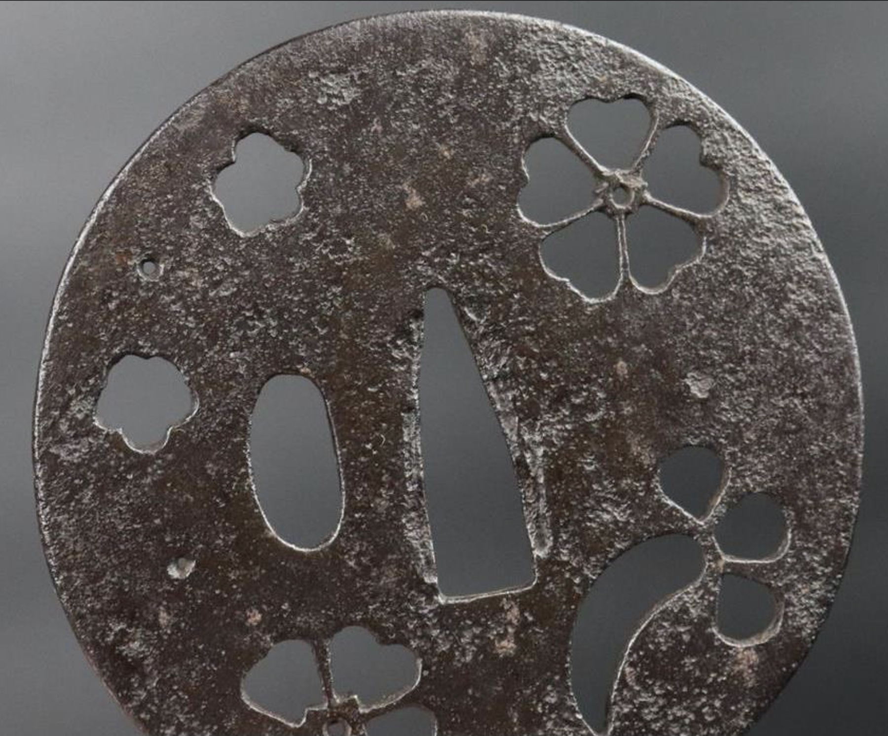

Surfson Posted December 17, 2020 Author Report Posted December 17, 2020 The files are huge. Also, oddly, there are only images of the front. Quote
Surfson Posted December 17, 2020 Author Report Posted December 17, 2020 The dimensions are 88mm diameter and 2mm thickness. It's my understanding that the older ones are thinner. I am curious how old it really is. The NBTHK left out "Ko" on the kantei, so what is the dividing line in date between Ko Katchushi and Katchushi? Quote

Curran Posted July 1, 2021 Report Posted July 1, 2021 From photos and your measurements, I would say Ko-katchushi. Papers are from 2015. I think my opinion is known. Quote
