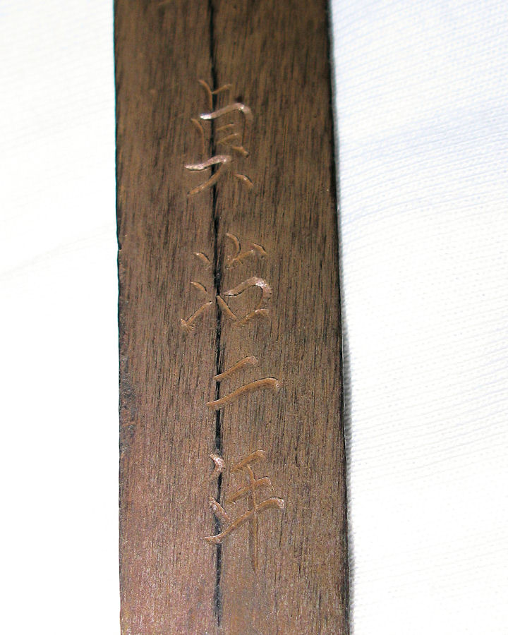

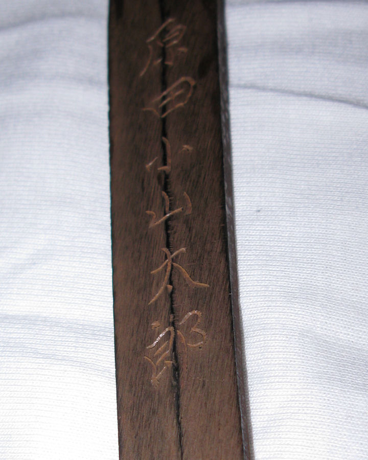

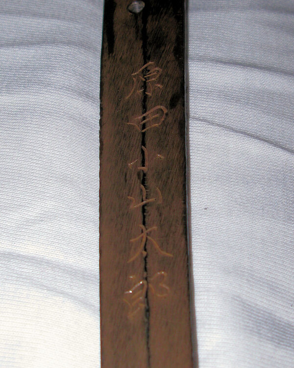

I just received my first katana, but I need help with the mei and date.
Can anyone offer any thoughts?
There are 2 different shots of the mei to show the characters better.
Thanks!
Mark
Hi Mark,
Sorry bro, looks like you have a chinese fake there. Click the fake sword tab above, and see what you think. From the mei, and Nakago, I would say fake for sure.
Sorry for the bad news.

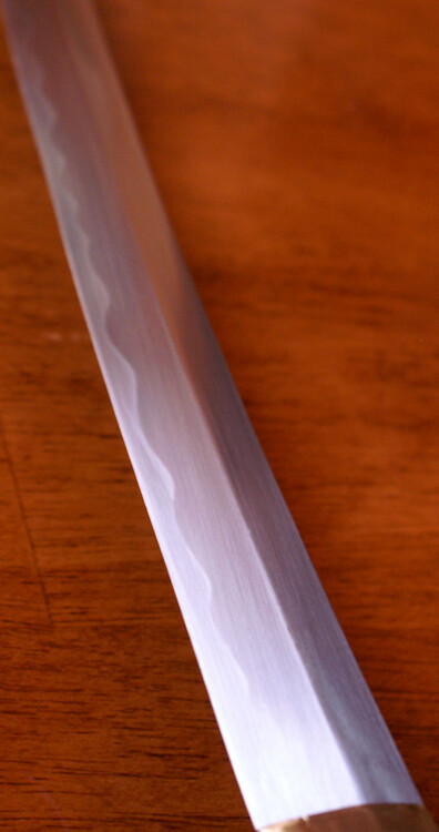

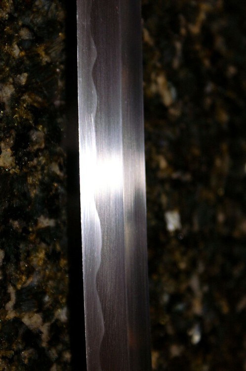

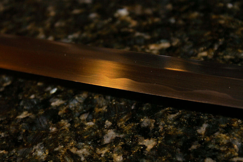

Here are some close ups as well as a pic of the entire sword.
Thanks again for the help!
Mark
Hi Mark
A rose by any other name?
Its the worst hamon i have seen.No activity and its so "flat" and "dead".
I wish i could just show a novice (sorry)what a true hamon looked like,then there would be not market for the Fakers.
Its a choice of "pussyfooting" or getting straight to the point.
If it was sold as genuine then send it back.
Out of curiosity what did you pay for it?
I would be surprised if the Chinese went to the effort of forging and tempering,it takes too long ,is too labour intensive and is not ecconomically viable,there will always be a market for fake swords of poor quality.
