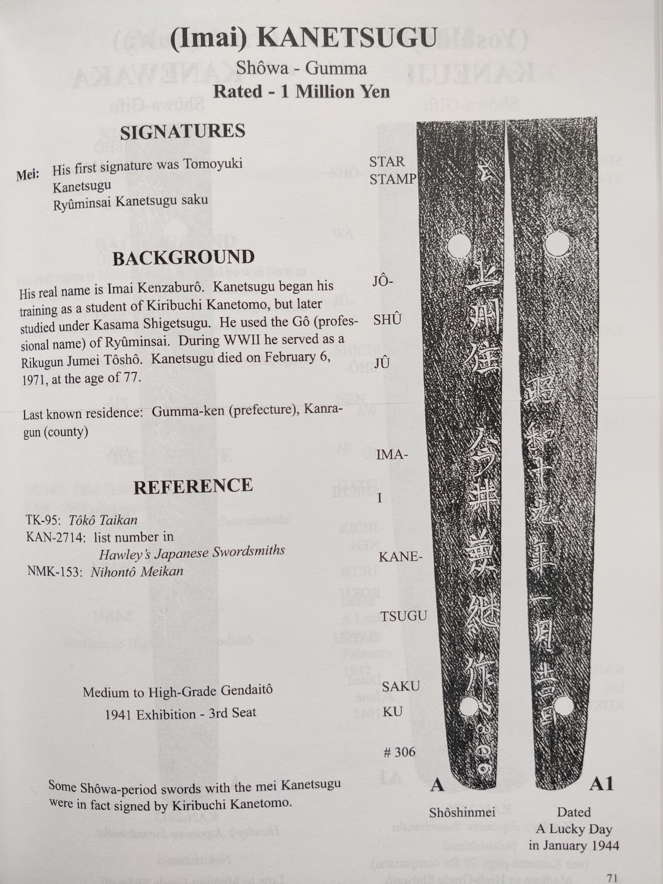

george trotter Posted December 11, 2020 Report Posted December 11, 2020 You already know the smith's name...maybe just look him up on-line? Joshu ju Imai Kanetsugu saku. Just for starters, he is in Slough p.71. BTW very nice looking blade/hamon. Have fun... 1 Quote
francois2605 Posted December 11, 2020 Report Posted December 11, 2020 In case you don't have the book George mentioned. 1 1 Quote
Bruce Pennington Posted December 11, 2020 Report Posted December 11, 2020 Edward, Does you nakago have the star at the top, like the one in Slough's page? How about stamped numbers at the bottom? Wondering why you called it a "gunto", too. The tsuka and tsuba are civil. Is the saya the leather-covered wood? Admittedly, Kanetsugu was an RJT smith, but there were actually some swords sold on the private, civil, market during the war too. 1 Quote

Edward Mahle Posted December 11, 2020 Author Report Posted December 11, 2020 I already saw the trashcan thing coming I'm sorry I was at work haha. So no star stamp or numbers at the bottom of the tang but signature's match perfect. Quote

Bruce Pennington Posted December 12, 2020 Report Posted December 12, 2020 Edward, Thanks for the photos of the saya! It was definitely mounted for the war, with the leather covered saya. I've seen a couple of these - swords made by wartime smiths, mounted with civil fittings, but then fitted with a military saya for the war. It would be interesting to know the story of the blade and the route it took from smith, to maybe a civilian, who then read the pleas from the Army for donations (the army would buy the swords from owners, too) for the war effort. 1 1 Quote

Bruce Pennington Posted December 12, 2020 Report Posted December 12, 2020 1 hour ago, Edward Mahle said: survived a gruesome war but its road ends in suburban America just doesn't sit right with me. Those of us who preserve history are the living conscience of our society. "Suburban" may be where we're located, but it has nothing to do with the importance of what we do. A P.S. on the "gunto" label - I just saw an expanded view of the tsuka and can see the army menugi. So, it definitely was a civil sword re-fitted for the war. 1 1 Quote
