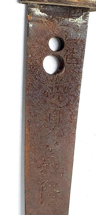

After carefully removing the pin,  abs disassembling the tanto,  these are the markings on the blade (included is also the markings on the smaller blade)
I did not try to clean the blade to see better...

岡山住逸見義隆 Okayama-jū Itsumi Yoshitaka.
Itsumi Yoshitaka is a famous smith from before the Meiji Restoration, to the early part of the 20th century. He truly was making swords for the last samurai, and then made a few ceremonial swords after that, as well as swords for the imperial family.

A few thousand dollars. The better the condition, the higher the value. Good condition means unmarred by amateur polishing or grinding, patina intact, and no cracks in the steel. Small imperfections are to be expected. The condition of the furnishings is not as crucial as the condition of the tanto itself. In your case, your saya and furnishings look as a 150? year-old item would be expected to look. This is a long way of saying the condition of your item looks fine for now, so no need to do anything but protect it from moisture and fingerprints. Read the link that Grey posted. He's given his contact details as well, so you can check out his site and get in touch with him if you want a more detailed discussion.
There were a couple of comments made about the mekugi, And whether it was metal or wood...  interestingly, it is a whitish translucent material...  my first thought was that it was maybe plastic,  or acrylic....  but Iv would think that witless mean it is not original to the piece,  given the time period...
Is there another option?
