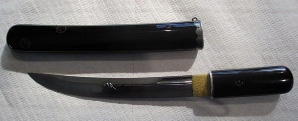

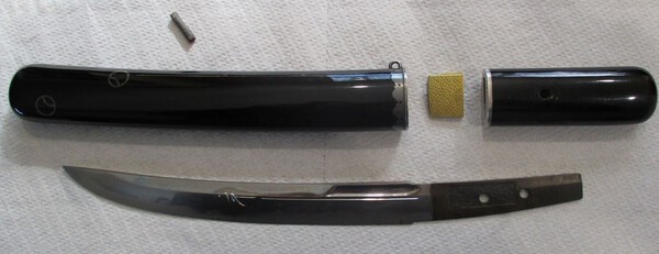

A Kwaiken, a concealable women's knife, great condition, about 16.8cm blade, originally a Kikutchi Yari cut down to make a small tanto in 1897 as per inscription on reformed tang. The maker's name is more obscure ?-Kane ? Koto period ?
Actually it was Mark then BaZZa who put me in some of the picture.
It is a lovely Kwaiken in my opinion.

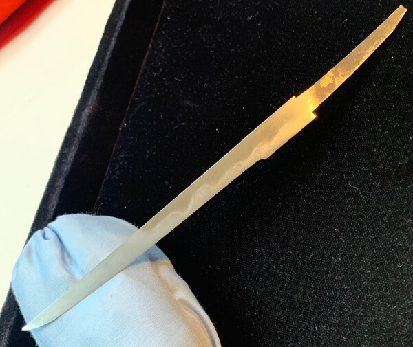

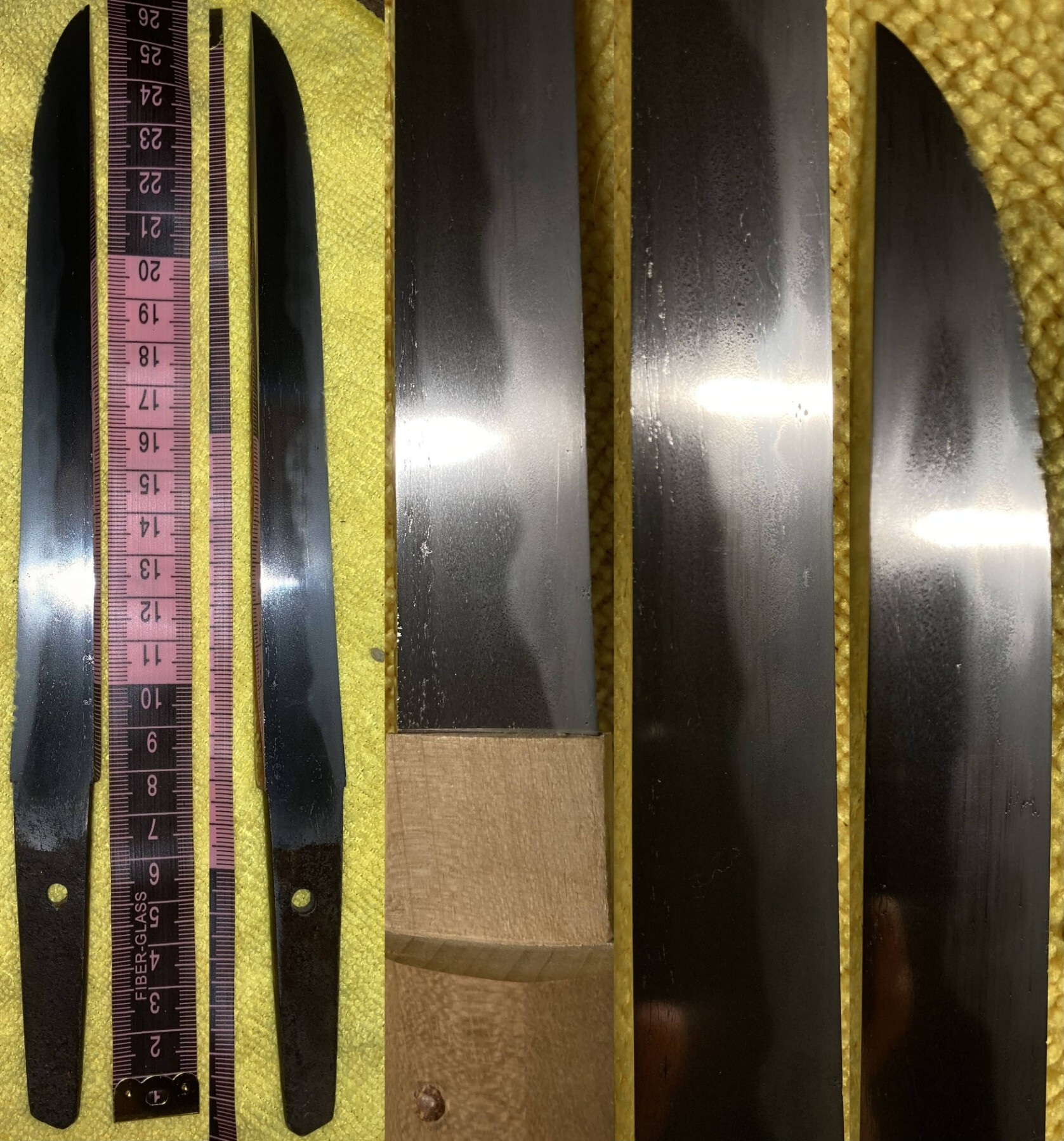

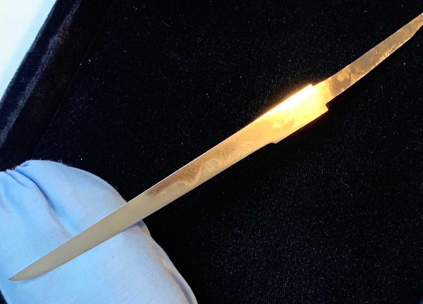

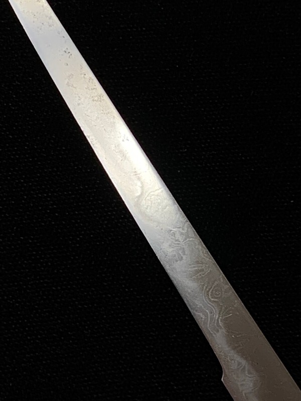

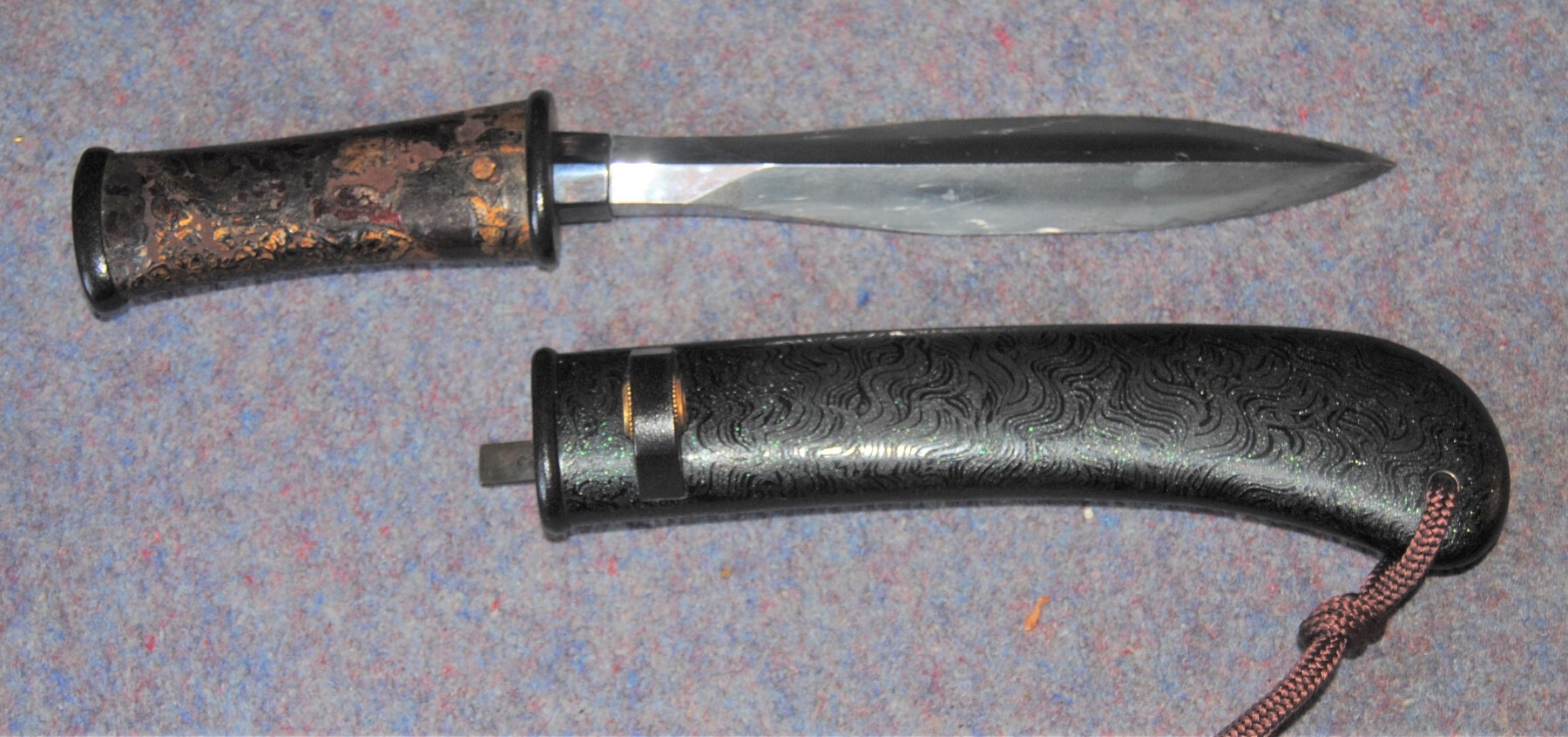

Hope this one is not too big but I've got a little dagger I'm fond of, I think it was a kaiken. It's mumei and I don't know much about it but I'm guessing the flamboyant hamon and masame at the bottom and mokume-itame elsewhere means it's probably from the Edo period.
True, I should remember just because a word is similar doesn't mean it's appropriate. If it is older than Edo that would be very interesting for sure. The kasane did certainly seem quite thick for a blade its size.
Is it possible to make a rough guess as to the jidai and what tradition might have influenced it? Thank you again for your help, I always wind up learning something each time come here.

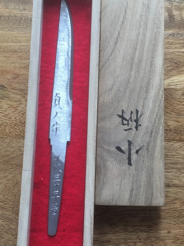

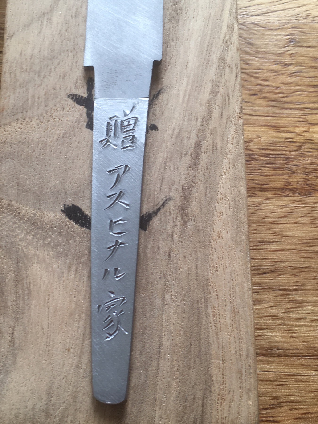

This was a gift from Enomoto Sadahito for purchasing one of his fathers blades.
A letter opener, all signed. Top dude, he really didnt have to do that but i was chuffed that he did.

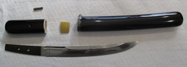

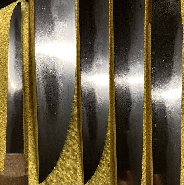

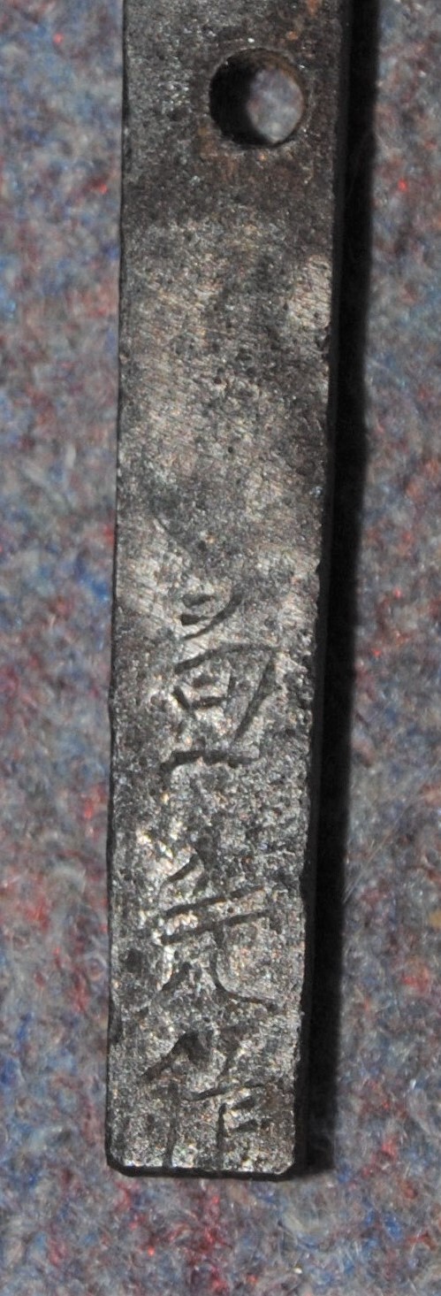

Bought this for my Christmas present from me to me. It is signed Kanesaki near the habaki which makes me wonder whether it was originally a yari blade that was shortened, which is much higher up than a normal yari signature, or is as made and is pretending to be a cut down yari.
Ian Bottomley
  • Like 4

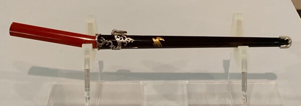

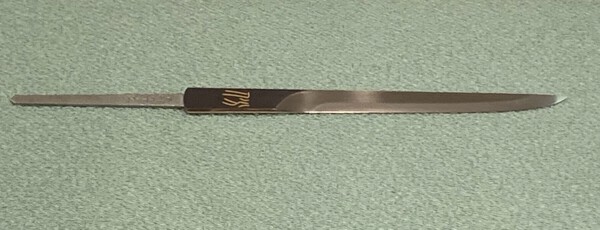

刀子
Small knife
Recently I came across a word that I should have known but didn't. 刀子, for which the English given was 'Tosu'. This piqued my curiosity.
In the exhibition of (O)mamori-gatana (see separate thread), was this specially made kozuka in a jewellery-like brightly-decorated koshirae, described as a To-su, or small knife. The blade and koshirae were a special order for the Manga artist Akiko Hatsu, 波津彬子 Hatsu Akiko.
https://en.wikipedia.org/wiki/Akiko_Hatsu
The Kanji suggested that the To- must be a long sound, as in Nihontō. Eventually I found that this word has been used in Japan throughout history to describe a small knife, and that it can be pronounced either Tōsu or Tōshi, (although the former seems to be more common).
Her name contains the Kanji 波 (Ha/Nami) for ‘wave’, so the koshirae has silver waves, according to the description.
  • Wow 1

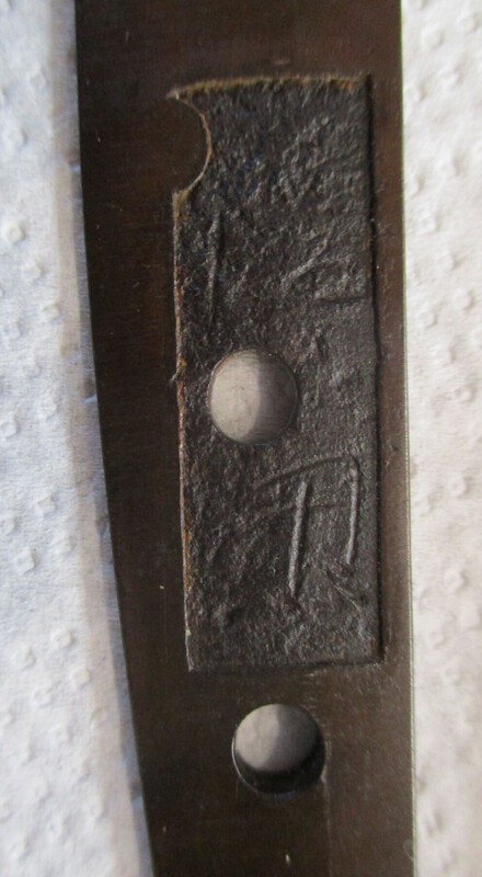

Dear Piers.
Sweet tosu but to go back to Ian's yari tanto for a moment.  Given the relatively small size of the blade I am pretty sure that this started life as a yari but with a modest tang length.  The mei is cut high up the nakago because the tang is wider there.  I believe the current nakago ana was added when the yari was mounted in this koshirae which accounts for the slight off set in placing.
The mekugi ana is very near the fuchi because the straight yari nakago fitting into the curved tanto koshirae soon places the metal outside the centre line of the tsuka, any further away from the fuchi and it would be in danger of missing!
This example demonstrates both the high mei and someone wrestling with the nakago ana alignment problem, in this case an off set mekugi ana and a copper insert to bring it into position to fit the tsuka.
All the best.
Geraint, I agree with all of that. (Although I think the Nakago have both been further shortened for their new lives.) Thanks for the thoughts, possible considerations and interesting illustrations.
Geraint, I think you are right on the point about the width of the original tang being too narrow and hence the signature placement. It seems that Kanesaki specialised in yari which again suggests it is a modified sasaho yari blade. Irrespective of shape, it would be a devastating little weapon to tuck into your obi. While I am at it, I have often wondered about the hole and shitadome at the bottom end of the saya. These often seem to originally held a leather tab. I may be wrong but their purpose may have been to help prevent the saya pulling out of the obi too easily when the blade is drawn. Ant other ideas?
Ian Bottomley

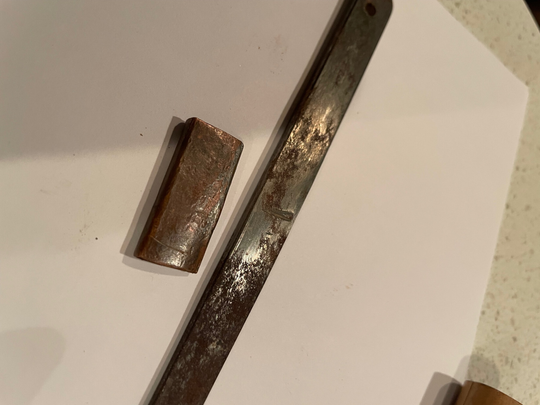

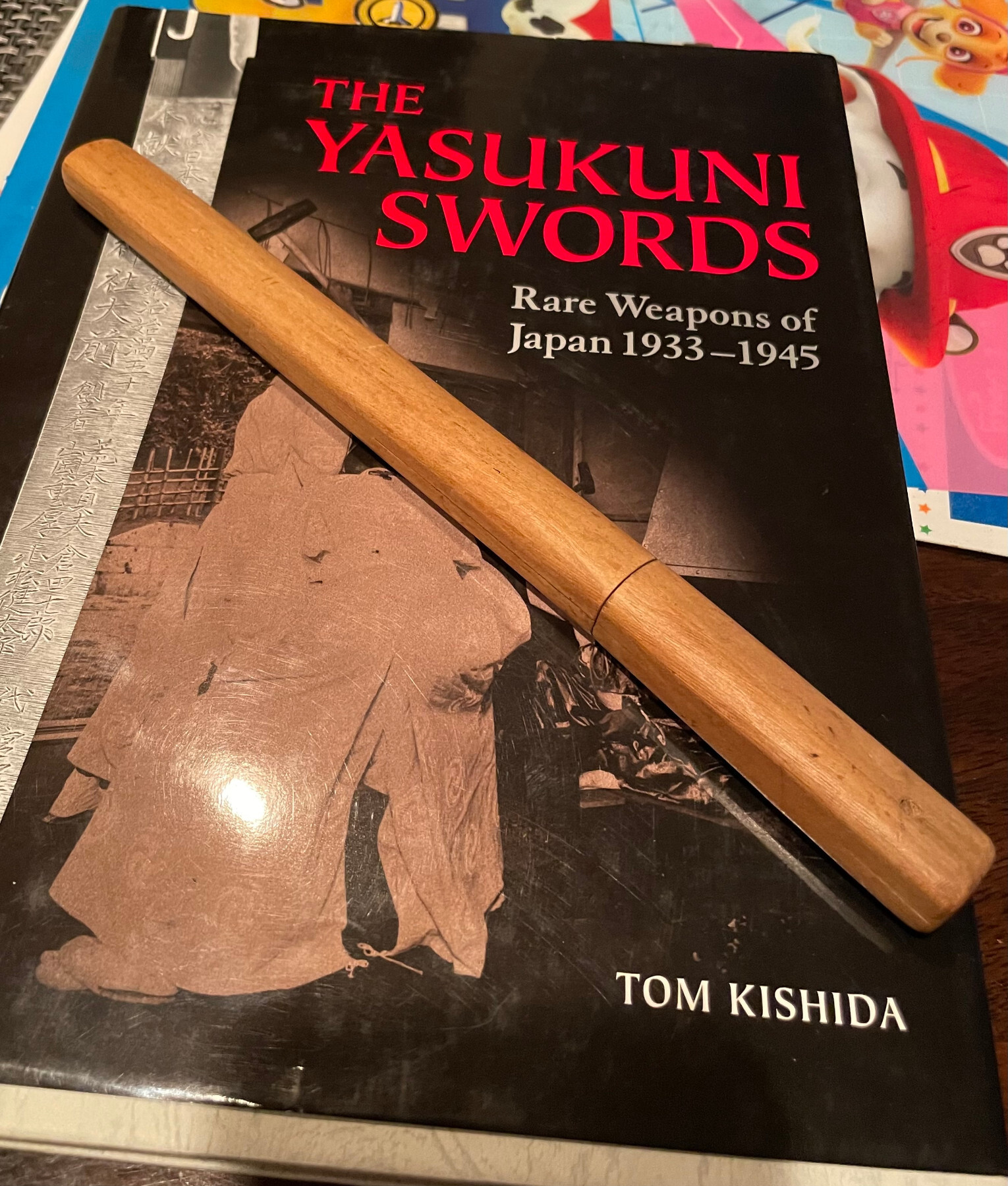

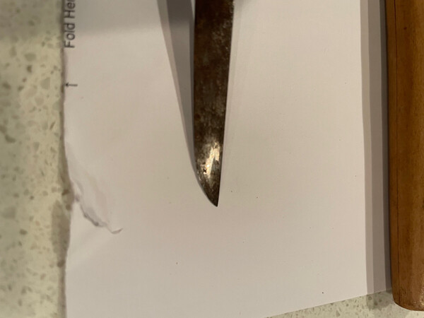

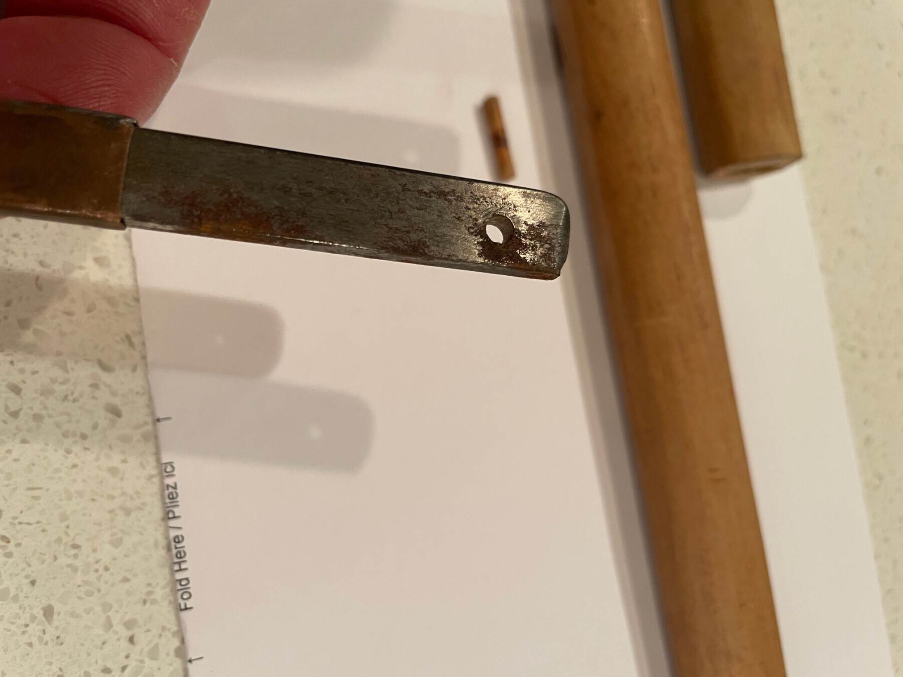

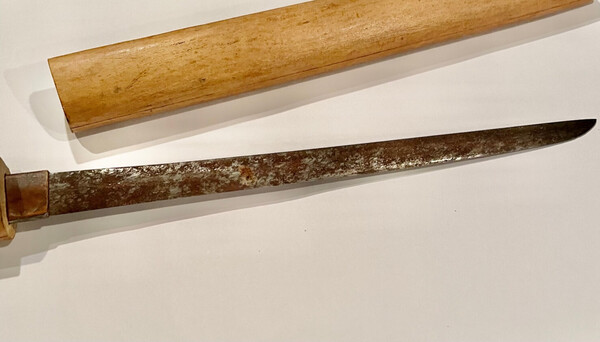

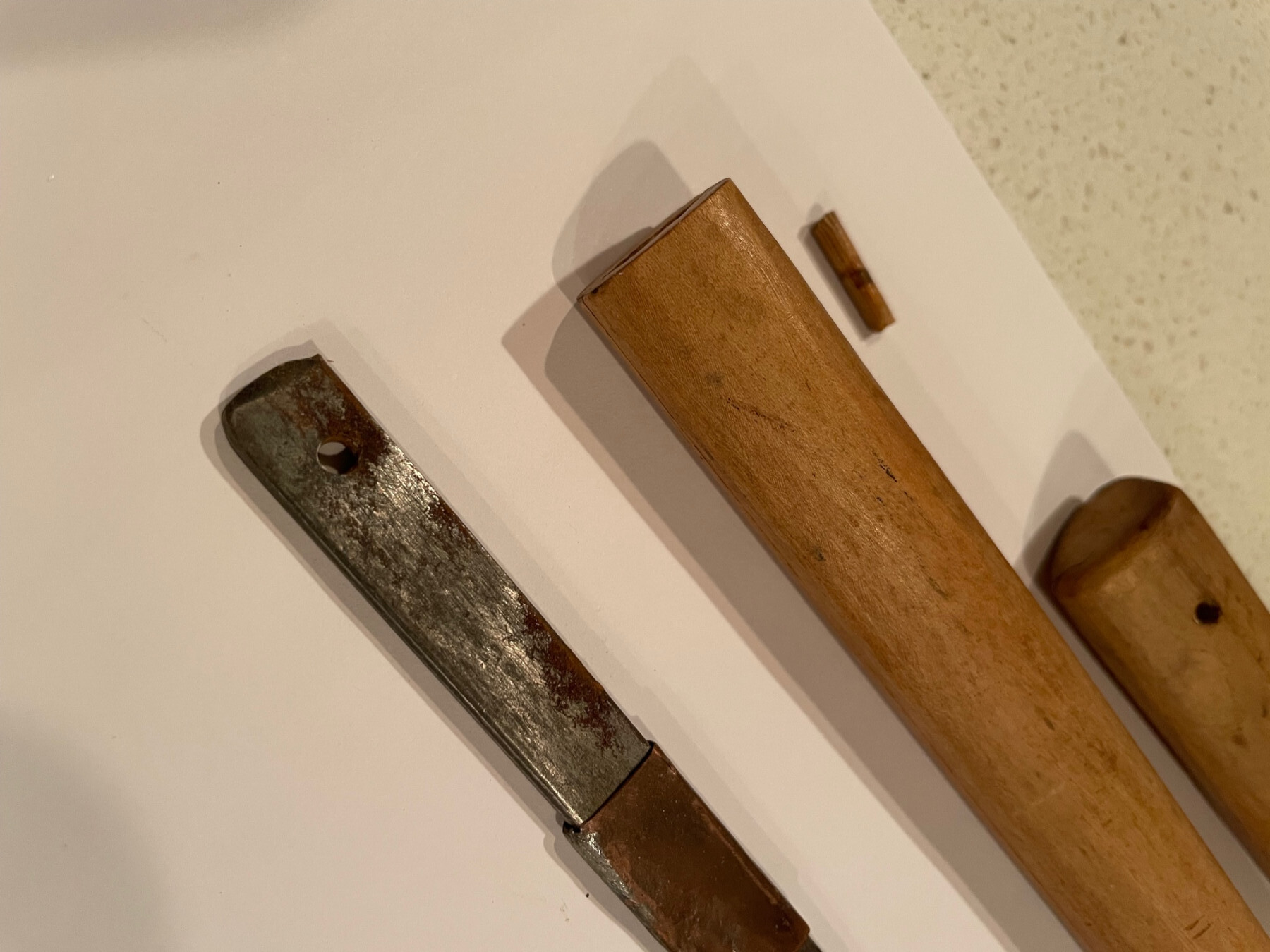

Just got this one, similar to Pier's first post, as a gift from someone very gracious.  Mumei, and the nakago looks new to my eyes, though with some rust.  Shirasaya seems to have some age, but not a great amount.  I'm thinking post-war souvenir?  Mostly because the habaki is fairly ugly and long.  Most of it slides into the tsuka with only the "normal" amount sticking out, to look like a habaki.  And also the squared and thick nakago.
But I wanted to run it through you guys.  I'd like to buff it up, but I don't want to if it's something older.  If it's just a trinket/souvenir/letter opener then I'd feel easy with cleaning off the rust.
  • 2 months later...
Difficult to get an overall image of that. Someone (Guido?) once said that the police in Japan base their decision on what is, or what isn’t, a registrable blade under the sword and gun laws partly by whether it has a mekugi ana in the Nakago or not.
I would have a go by the gentlest of means at removing the rust on that, Bruce.

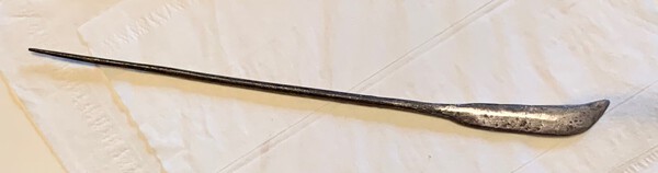

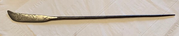

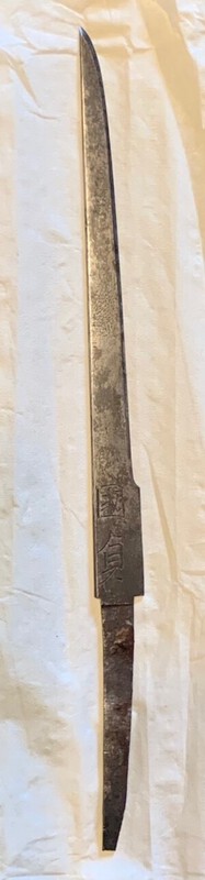

While we are giving this thread the kiss of life, I have two more small blades to add.

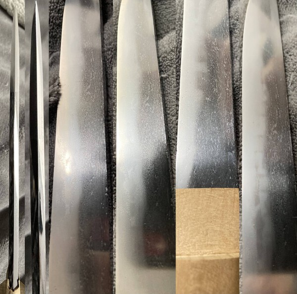

Here is one. Any guesses? (I should add that I am not 100% sure of the correct answer myself. Found at an antiques fair.)
Total length is 8 Sun 2 bu. 25 cm, just under 10”. The blade is around 6.5 cm depending on how you measure it. Iron.

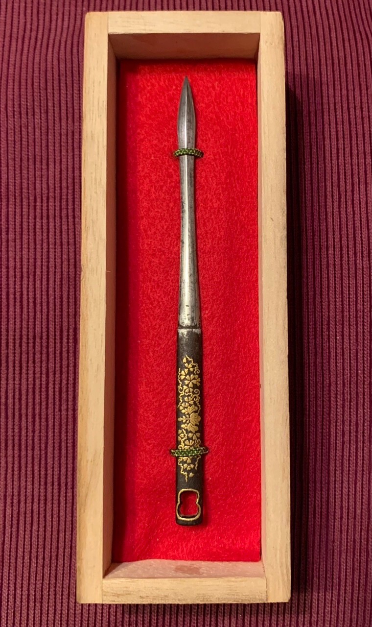

The other is a Kozuka/kodzuka with an angle.
While the Togishi was here he picked out a bent and rusty Kozuka from the box and asked me if he could polish it.
“Sure, knock yourself out!” I replied in Japanese.
Last night at the meeting he passed it back, proudly showing the results of three weeks’ handiwork.
Now, if I can get the dang thing to keep still for the camera 📸
Brian, I was giving people one thing at a time to focus on, while dangling a carrot for those already bored. :glee:
For you, the world. Pics follow.
Part 1
Kozuka sunny side up. Apparently an old Kozuka but made by a small blades smith, not a Tōsho or katana-kaji.
