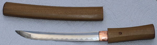

Dave R Posted February 11, 2021 Report Posted February 11, 2021 On 2/11/2021 at 1:21 PM, Geraint said: Dear All. Not sure how small we need to be but here is a little tanto. Nagasa is 150mms All the best. Expand That is a truly lovely piece. 1 1 Quote
Geraint Posted February 12, 2021 Report Posted February 12, 2021 Thanks David, when I saw it I thought the same. It didn't take a lot of thinking about and at the time it wasn't a lot of money. All the best. 1 Quote

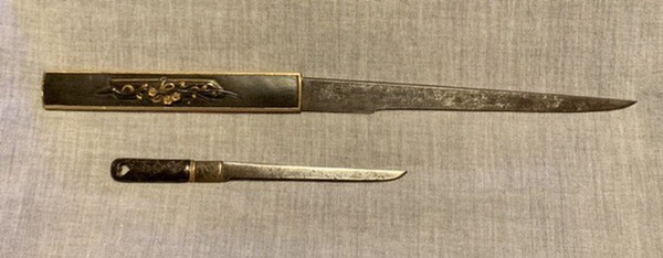

Bugyotsuji Posted February 13, 2021 Author Report Posted February 13, 2021 They’re kind of fun, aren’t they. Yours has some real sori to it. Against a Kozuka, for size comparison, here is a *Koshin, I mean a Bazuka, Uh, er, ... from Kyūshū perhaps 🤔 The blade is not loose in the hilt; I do no want to pull too hard to test how it is inserted/fixed. *Kozuka/Bashin cross. Quote

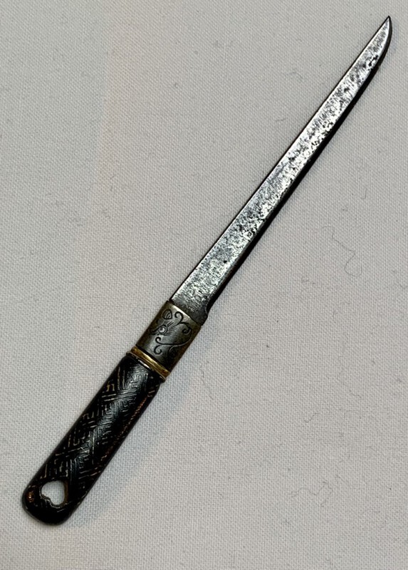

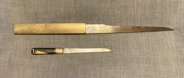

Bugyotsuji Posted February 14, 2021 Author Report Posted February 14, 2021 Took some better shots of this unusual little Kyūshū Kozuka. Seems to made of various materials in a tiny space, and different front and back. 3 Quote

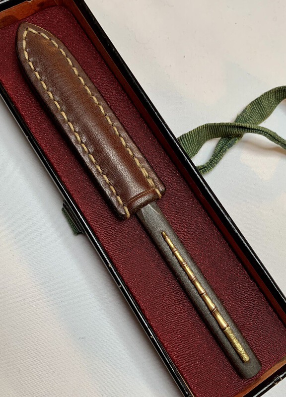

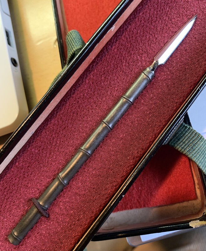

Bugyotsuji Posted February 25, 2021 Author Report Posted February 25, 2021 This is the signed one I was given by Senju Sensei’s son Sōju. (Wow, that’s a mouthful!) 5 1 Quote
JH Lee Posted February 25, 2021 Report Posted February 25, 2021 On 2/25/2021 at 12:53 PM, Bugyotsuji said: This is the signed one I was given by Senju Sensei’s son Sōju. (Wow, that’s a mouthful!) Expand Is this a "bashin"? I've read different things about their use. Was it basically used as a stiletto? Or something else? 1 Quote
Bugyotsuji Posted February 26, 2021 Author Report Posted February 26, 2021 John, this one is less than fifty years old, so I figured it to be a paper knife, a modern creation with traditional feelings, of bashin perhaps as you suggest. The bashin/umabari 馬針 in general was carried more commonly in the Koshirae of Kyushu where horses were frequently ridden. Originally it was used as a fleam, to lance a tired horse's gorged lower ankle blood vessels in order to relieve pressure after a hard ride. The double-edged blade and the hilt were of one piece 'Tomoe' construction, (unlike the Kozuka). It later had other extended uses such as Shuriken, etc. Well, that is my background understanding. Similar construction, but more classically formal in style and different in purpose (in my mind) was the 貫級刀 Kankyuto, although many today use these words interchangeably. 1 Quote

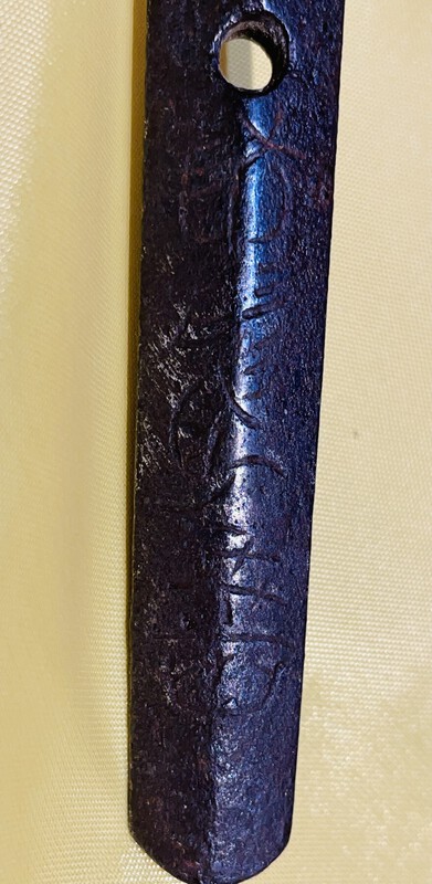

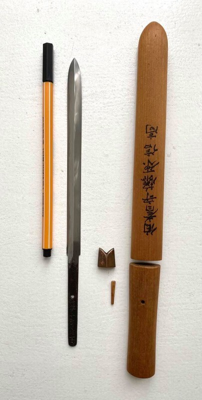

Jim Manley Posted March 28, 2021 Report Posted March 28, 2021 I picked up this little Ken at the Chicago show a few years ago. I pulled it out the other day to work on the signature and found it’s Unshu from the early Kamakura. Jim 7 Quote
Bugyotsuji Posted March 28, 2021 Author Report Posted March 28, 2021 Now that is a sweet object, Jim. The pin is there for size comparison? Can we see an upright shot of the Mei? Quote
Geraint Posted March 28, 2021 Report Posted March 28, 2021 Dear James. I love the idea that you have had this kicking around for a few years and then discover it is a Kamakura piece! Thank for sharing that one. All the best. 1 Quote

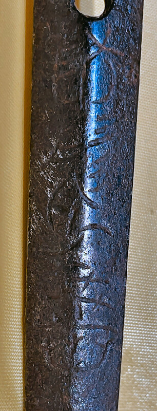

Jim Manley Posted March 28, 2021 Report Posted March 28, 2021 I’ll post a couple shots of the other side of the nikago too. I’m still working on the translation but I’m thinking a town or province. The ridge down the center makes it difficult to do decent photos. And I ran out of ohsigata paper. 1 Quote
Jim Manley Posted March 28, 2021 Report Posted March 28, 2021 Sorry, I didn’t check my photo before I hit sent. The previous photo is the reverse side. I’m struggling with photos as all are too large to attach . 1 Quote

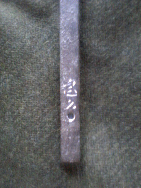

Bugyotsuji Posted March 28, 2021 Author Report Posted March 28, 2021 re 雲生 Unshō Been trawling the net looking for comparative examples of this famous Mei but not managed to find one. Many Mumei (attributed) and others not showing the Mei, so taking a break before hitting the books! PS Two examples of Unsho in Fujishiro show a very poorly written Mei. Regardless, it is a nicely shaped object to own, IMO! PPS Maybe stepping back and increasing the distance from the object would help to flatten out the surface. Quote
kissakai Posted March 28, 2021 Report Posted March 28, 2021 Maybe this will help The second image would be better by changing your camera angle to get a better contract 1 Quote

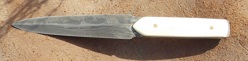

ROKUJURO Posted March 28, 2021 Report Posted March 28, 2021 Not Japanese, I apologize! Quite some years ago, I made a Damascus letter opener for my mother in BASHIN style. Blade length 110 mm. The handle slabs are old elephant ivory. 3 Quote

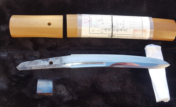

Bryan B Posted March 28, 2021 Report Posted March 28, 2021 Hi all I am new to the collecting of Nihonto So I know very little but I am trying to learn so having seen this thread I thought it might be the right section to show you all this that I bought recently it being my first purchase, I bought it not because I had any knowledge but because I liked the overall look and the blade seams very delicate. ( I now know that that is not the right thing to do after reading this message board) but if possible I would like to know more about it good or bad . 3 Quote
Bugyotsuji Posted March 29, 2021 Author Report Posted March 29, 2021 Hi Bryan, thanks for posting. Without any measurements, it's hard to say, but you've chosen the smaller blades thread so that tells us something. Aikuchi koshirae, blade, habaki, mekugi, nakago, it all looks like a start in the right direction! (Smaller than a Tanto brings us into the realm of Kogatana, Chiisagatana, Futokorogatana (Kaiken) Mamorigatana, etc.) Quote

Bryan B Posted March 29, 2021 Report Posted March 29, 2021 On 3/29/2021 at 8:26 AM, Bugyotsuji said: Hi Bryan, thanks for posting. Without any measurements, it's hard to say, but you've chosen the smaller blades thread so that tells us something. Aikuchi koshirae, blade, habaki, mekugi, nakago, it all looks like a start in the right direction! (Smaller than a Tanto brings us into the realm of Kogatana, Chiisagatana, Futokorogatana (Kaiken) Mamorigatana, etc.) Expand Hi thank you for the reply the blade is 17 cm long 16mm wide and 3mm thick . 1 Quote
Jussi Ekholm Posted March 29, 2021 Report Posted March 29, 2021 About the Unshō 雲生 ken. I have about 30+ mei of Unshō in my sources and unfortunately this is slightly different to the verified examples, would still run it through the experts rather than just my look on it. I cannot see & read the other side of the signature from the picture. So far I have not encountered a ken by this school (Ukai). 1 Quote

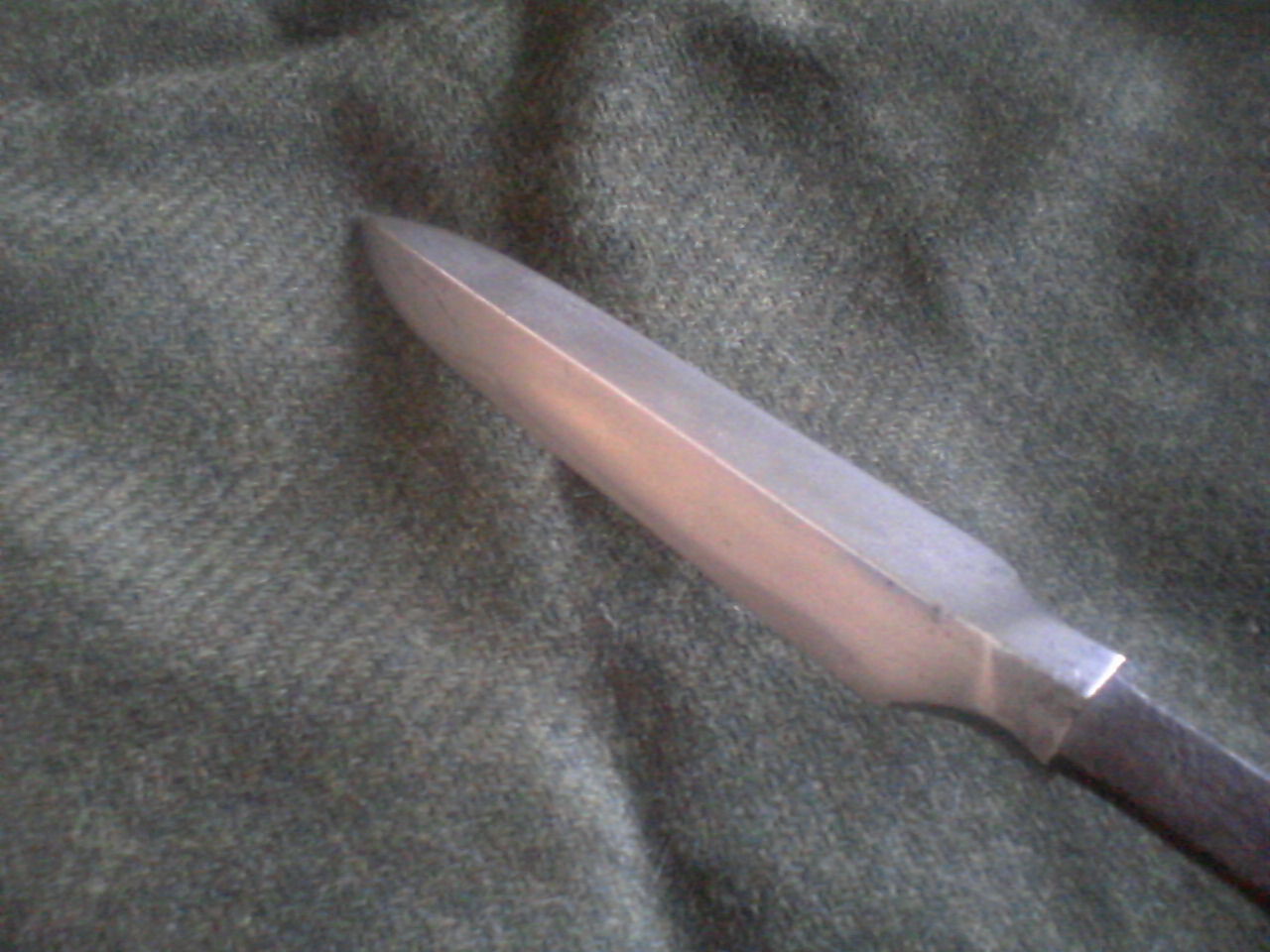

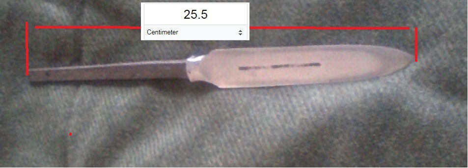

Dave R Posted March 29, 2021 Report Posted March 29, 2021 Here is one of my own, a small Yari, bought on Ebay for the price of a large family Pizza because no one knew what it was! I think it's probably a Te-Yari or Makura-Yari, anyway I like it,and it was the first Nihonto I bought this century... Apologies for the poor pics, phone camera only. 2 Quote

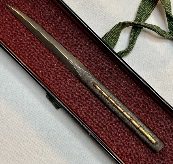

Bugyotsuji Posted March 30, 2021 Author Report Posted March 30, 2021 We're starting to verge over into Yari territory, which is a whole nother kettle of fish! My mobile phone takes really good photos, Dave. Have you thought about upgrading? Your Mei has me scratching my head. 道久? Can you get us a couple of shots from different angles? Really nice treasure find though. That reminds me of an acquaintance in the UK who found a rusty Jumonji Yari in a bucket at the antiques market. He gently lifted it out of the junk; the dealer leaned over and said "Give us a tenner, mate". To show what a mobile phone can do, here are a couple of shots of the Bashin above, after it came back from the polisher on Saturday. (Reduced from 3 Mb to 500 Kb for the site) 5 2 Quote
