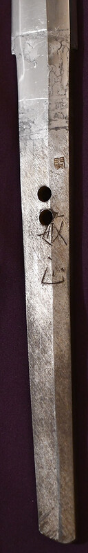

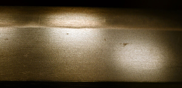

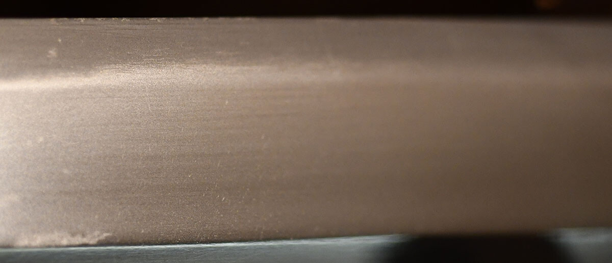

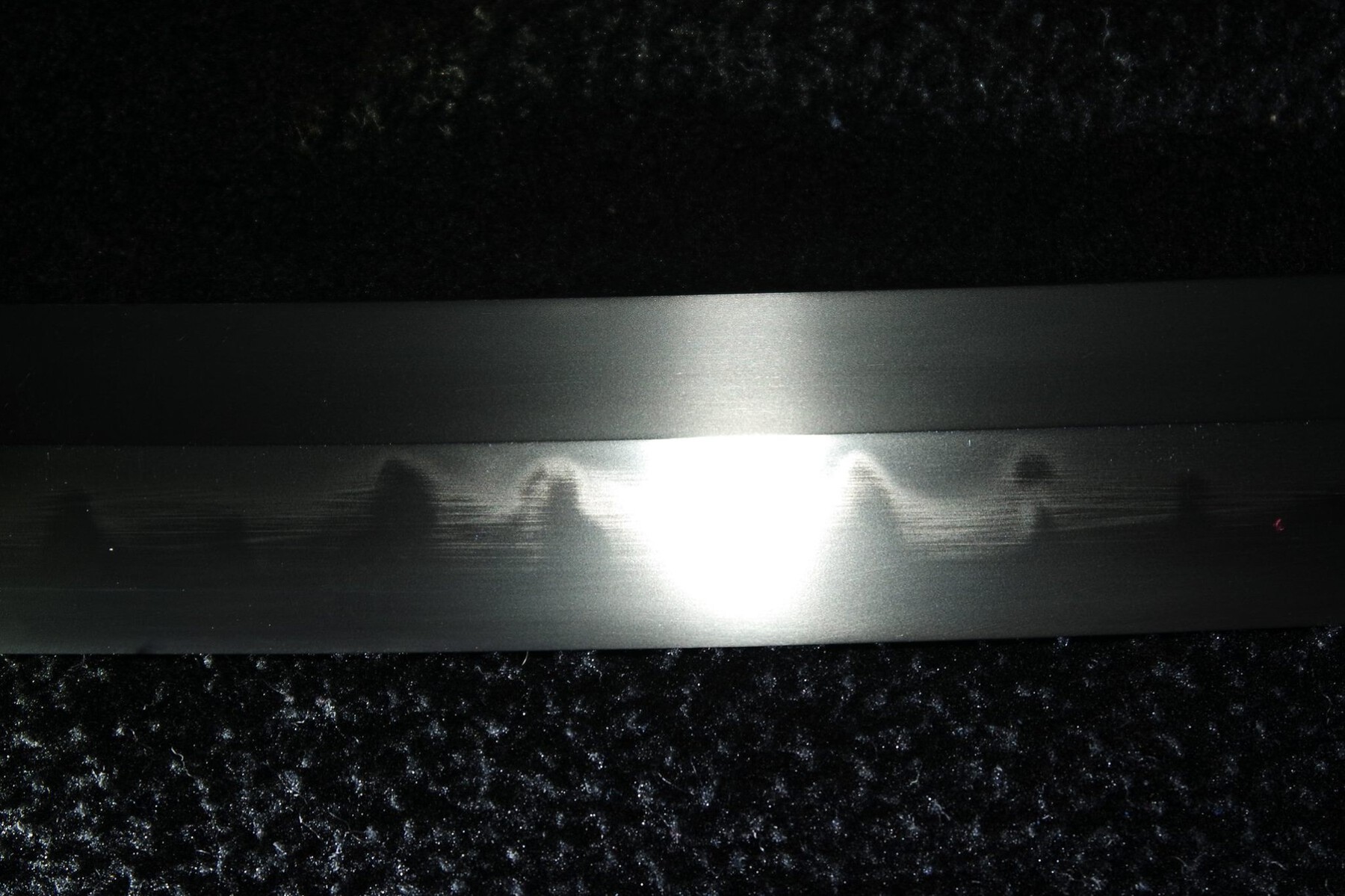

My first Japanese sword, bought in 1976, is Signed Toshimasa, dated 1942 and has a Seki arsenal stamp. It also has tight masame hada (images 3. 4. and 5) and sunagashi. It appears to be water quenched. Here are some photos.

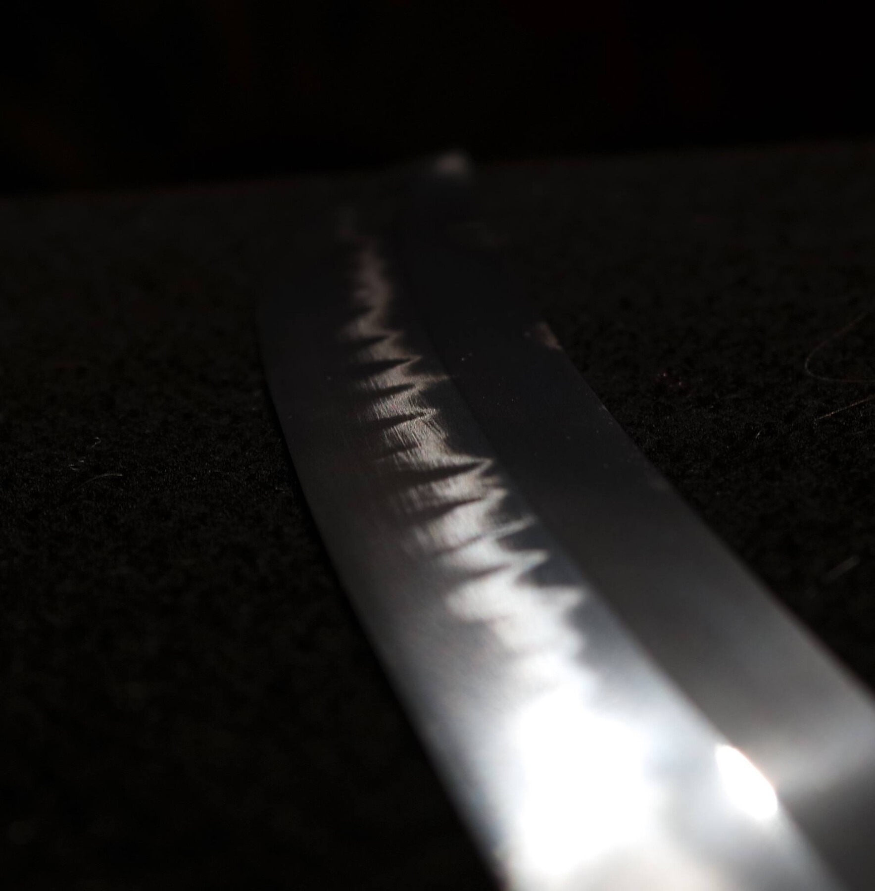

This is a wakizashi i made from 1070, water quenched
Excellent job!
That is what I was taking about. I have a T10 sword with exactly that kind of sunagashi.
31 minutes ago, 16k said:
Excellent job!
Thank you, i think technically this is called alloy banding lines

Looks like the early large Seki stamp that has been, like yours, found on Gendaito.
John,
Here is where the Gendaito/Nihonto jargon gets me confused sometimes - are you saying the blade is "traditionally made"? and that the large Seki stamps aren't part of the required stamping on non-traditional blades?  Or are we saying that this blade was made using traditional methods (including water quench) but likely used non-tamahagane, and therefore the Seki stamp?
To me the blade is traditionally made, madame hada, suguha, sunagashi, well made Mei and file marks. The way the hamon goes around the machi, we'll done boshi etc. The stamp is the odd thing on this sword. That is why I asked the question. This is the first sword that I bought - purchased in 1976.
