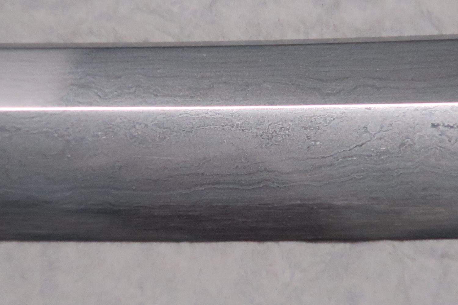

Caracal Posted November 22, 2020 Report Posted November 22, 2020 What does it look like if a sword has been subjected to chemical cleaning of a chemical polish. What are the clearest signs? How can anyone avoid being fooled by it. There are many swords out there at auction companies and many want to sell. // Robert Quote
16k Posted November 22, 2020 Report Posted November 22, 2020 For me, I’d say the Hamon will look flat. When you look at a Hamon, it varies in intensity according to the way you light it. An etched Hamon will look very white and flat. It will be seen whatever the light you use. Also, very often, the Hada will look conspicuous and enhanced., or on the contrary, washed out. pictures would help. Quote
Dave R Posted November 22, 2020 Report Posted November 22, 2020 A good article on the subject here..... http://www.ksky.ne.jp/~sumie99/acid polishing.html 1 Quote
Caracal Posted November 23, 2020 Author Report Posted November 23, 2020 Thanks for the reply. What can you do if you discover that someone has polished the sword with some chemical and not so bad. Can it be sent for polishing so that it regains its true value or is the sword destroyed? The cost of polishing is, of course, in proportion to the value of the sword. Want more clear pictures of these swords in comparison with ordinary polished swords. // Robert Quote
AntiquarianCat Posted November 24, 2020 Report Posted November 24, 2020 There are several bad acid polish examples in NMB’s archives. The worst off ones make it hard to see the habuchi and turn the hada into some garish “Damascus hada” like pattern. I honestly still have trouble telling some Japanese made victims of FeCl3 from replicas. IDK why a vendor would do that to an antique. And I also wonder if part of the reason some of the replicas made in China and other parts of the world look as odd as they do is because an acid bath is included in their manufacture. Brian and other experienced collectors say that acid etching can be repairable sometimes https://www.militaria.co.za/nmb/topic/17957-my-new-nihonto-with-pics/ 2 Quote
Dave R Posted November 24, 2020 Report Posted November 24, 2020 On 11/24/2020 at 1:46 AM, AntiquarianCat said: IDK why a vendor would do that to an antique. Expand It's a quick and dirty fix to make the blade more attractive to the uninitiated. Very few if any fairs have good enough lighting to properly judge a blade and an acid wash brings up the detail making the blade more saleable. It's also cheaper than having a proper polish.... You would (or would not) be surprised at how many blades on a dealers table have had this done. 2 1 Quote
Brian Posted November 26, 2020 Report Posted November 26, 2020 Looks a lot like this: https://www.militaria.co.za/nmb/topic/33978-what-have-i-got/ 1 Quote
