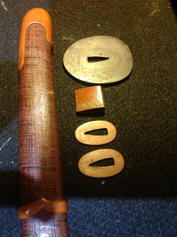

Jim Manley Posted November 20, 2020 Report Posted November 20, 2020 Thomas suggested I create a separate thread about this Murata-to. I have very limited information so I'll share what I can. the Nagasa is 25 3/8" . All of the fittings, including the habaki are copper. The tsuba too is copper and patinated black. The Saya is canvas covered and may be sealed with lacquer. The blade was polished and the original polisher's marks remain. There is a definate nioi line along the suguha hamon. In Mr. Ohmura's article on Murata-to he includes a photo of Prince Chibata's identical blade which is signed and dated 1933 along with the aribic no. 116. I don't know if the fittings & kosheri for Prince Chibata's blade survived or if they were like those on my blade which I assume are original. Jim M. 4 1 Quote

Kiipu Posted November 20, 2020 Report Posted November 20, 2020 On 11/19/2020 at 12:54 AM, Jim Manley said: Here are some shots of my Murata-to. All the fittings are copper and the saya is canvas wrapped. It is not sharpened which makes sense if it is a practice sword. Also there are no Menuki but ovals of wood to orient the hands on the Tsuka. No. 103 w/ arsenal stamp. Two mekugi ana . Amazingly it's in perfect condition, Jim M. Expand Are both mekugi-ana 目釘孔 used by the current tsuka 柄? I can only see one peg hole in the hilt pictured in the OP. Quote

Jim Manley Posted November 21, 2020 Author Report Posted November 21, 2020 Only the upper hole was used. The lower hole is visibly smaller. No discernible file marks on the tang either. Jim 1 Quote
