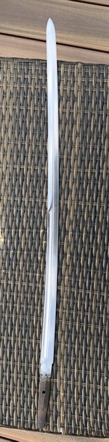

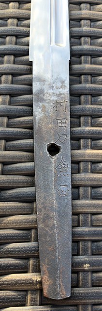

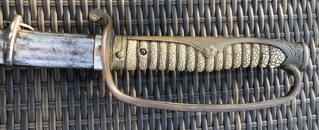

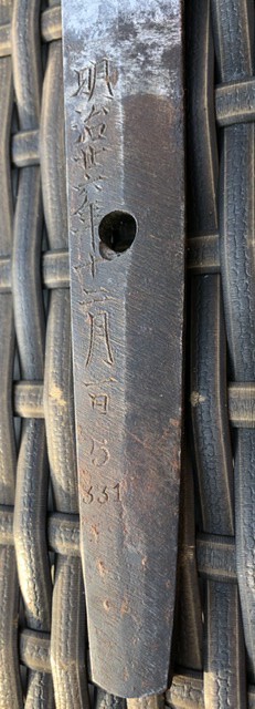

This has been a very interesting thread to read.   I am the person who posted earlier in the translation request section and own the Kyu Gunto dress sword.   Mine has a date and a signature as indicated below from the translation section.  It is a new acquisition within the last few days.
Shōjū Kanemasa  小銃兼正
明治廿三年三月 = March 1890 [1890-03]
However,  mine has no arsenal stamp of Kokura ( three cannon balls)  as in Jim's sword above.  The blade does have a sharpen cutting edge.   On the nakago it has stamped Arabic numbers, of which has been a brief discussion above.   I am curious as to the meaning for these numbers.   Any other  thoughts and opinions are very welcomed.  So now I am wondering just how rare are the Murata Swords which bear his signature and are dated?   After some minor clean up it appears to be in incredibly good condition.
Any opinions as to value is also appreciated.
Thank everyone all in advance
Edward G.

So far, I have run across two different double-edged blade shapes used by Kanemasa 兼正.  I think yours is called a "kissaki moroha zukuri" 鋒両刃造 and it is based upon the Kogarasu Maru (小烏丸).  Four of the fourteen Kanemasa swords have this blade shape.  Ohmura-sensei disagrees and calls it a "mukade-giri-maru" 蜈蚣切丸.  Below is a link to a PDF that shows the "mukade-giri-maru" at the Ise Shrine and it can be seen in frame 2.  Any thoughts about this dilemma welcomed.
http://museum.isejingu.or.jp/docs/cms_event/o65yx90q/展示作品.pdf
Kanemasa 兼正 also used one other double-edged blade shape and it can be seen in Edward's sword in post 14.  I do not know what this style is called but it does show up at least twice.
Here is the translations for your sword.
明治廿六年十二月一日 = 1893-12-01 (01 December 1893).
村田刀兼正 = Murata-sword Kanemasa.
Prior to 1896, the Tōkyō Artillery Arsenal used 東京砲兵工廠 because the stacked cannon ball logo did not come unto use until December 1896.
Some, but not all, of the 兼正 (Kanemasa) made swords have Arabic numerals stamped beneath the date.  In some cases, this consists of two rows of numbers such as illustrated below.
5
95
The example above would be rendered as 5/95 in text.  My initial thoughts was that these numerals were a sequential serial number starting at 1.  However, upon charting the swords out in chronological order, this did not appear to be the case.  The only order that appears is that the swords with the same number on the first row, seem to have the second number increase on swords made later on.  I am thinking it is possible that these numerals could have been applied sometime after production.  One such possibility that comes to mind would be some type of unit inventory number.  However, I have no evidence to support such an assumption.  As always, comments welcomed on this conundrum.
Is it possible that the Arabic numbers on the nakago for these swords were added later by an armorer in service to indicate Military Regimental Markings?  During this period of time it was common in European countries to add regimental markings on armaments such as bayonets, rifles, pistols etc.  This practice continued through WW1 up until WW2 in many European countries such as England and Germany.
Edward G.
The Japanese had 7 infantry divisions by May 1888 and this could account for the prefix numbers seen so far.  But why do some blades have no numbers at all?  One thing that bothers me is that these are officer's swords and hence presumably private property.  This is borne out by that wide range of blade & tang shapes seen.  It is an enigma that awaits an answer!
That is the same dilemma I have had tracking numbers on all the other blades. There seems to be a lot of numbers coming from RJT army program blades, but like you said, not all of them are numbered.
