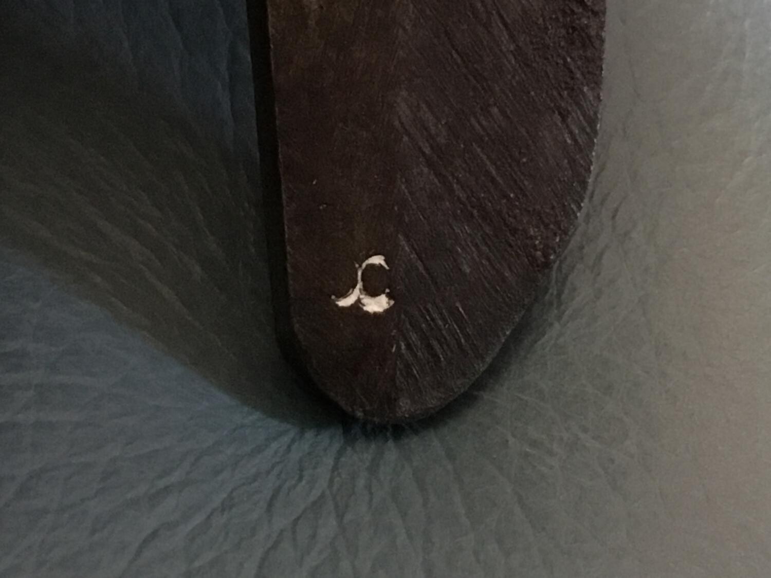

Bruce Pennington Posted November 7, 2020 Report Posted November 7, 2020 A mind is a terrible thing to waste! Sorry if I've posted this one before, but I don't remember asking for help on this one yet. The stamp was poorly struck, so there's some strokes missing. Any idea of the meaning? Thanks! Quote
Shugyosha Posted November 7, 2020 Report Posted November 7, 2020 Sorry Bruce I only know a couple of stamps. Looks the “Nishi” kanji, meaning “west”, enclosed in a circle. Does that make any sense? 1 Quote
Bruce Pennington Posted November 7, 2020 Author Report Posted November 7, 2020 I think you nailed it! 西 Might be a regional mark. Not sure if if would make sense as a personal hot stamp. Quote
george trotter Posted November 8, 2020 Report Posted November 8, 2020 Yes, Nishi. Probably an inspection/production mark. I had a look through the 'Nihon Token Shoko Meikan' of 1942 (edit/addition since first post) and saw a half dozen Nishi-something names but only one person with the name NISHI alone. He was in Osaka and listed as a togishi (polisher)...he's on page 277 . His personal fore-name is Hiroshi. Not saying this is the guy who stamped the 'nishi' mark on the tang, but he does fit the circumstances, a polisher named Nishi, puts his "company" mark on the tang of a sword he has just finished polishing....? Maybe if you tell us the blade maker name / location etc we could get a bit more of a clue? Regards, 1 Quote
Bruce Pennington Posted November 8, 2020 Author Report Posted November 8, 2020 On 11/8/2020 at 2:41 AM, george trotter said: Yes, Nishi. Probably an inspection/production mark. I had a look through the 'Nihon Token Shoko Meikan' of 1942 (edit/addition since first post) and saw a half dozen Nishi-something names but only one person with the name NISHI alone. He was in Osaka and listed as a togishi (polisher)...he's on page 277 . His personal fore-name is Hiroshi. Not saying this is the guy who stamped the 'nishi' mark on the tang, but he does fit the circumstances, a polisher named Nishi, puts his "company" mark on the tang of a sword he has just finished polishing....? Maybe if you tell us the blade maker name / location etc we could get a bit more of a clue? Regards, Expand George, quite an interesting idea - a polisher's mark! I've seen polishers with a kao, so why not a stamp?! Thanks for doing some digging on this! Sorry to say it was one of the early stamps posted on the Arsenal Stamps thread back in 2010 by GregD, on Page 2. I just sent him a PM, but he hasn't been active for a year and a half. Quote

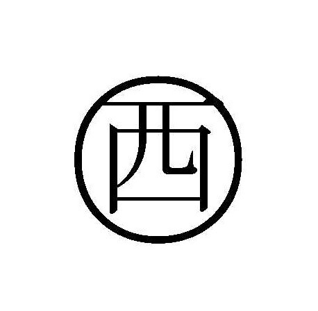

Kiipu Posted November 9, 2020 Report Posted November 9, 2020 The complete stamp should look like the image below. 1 Quote

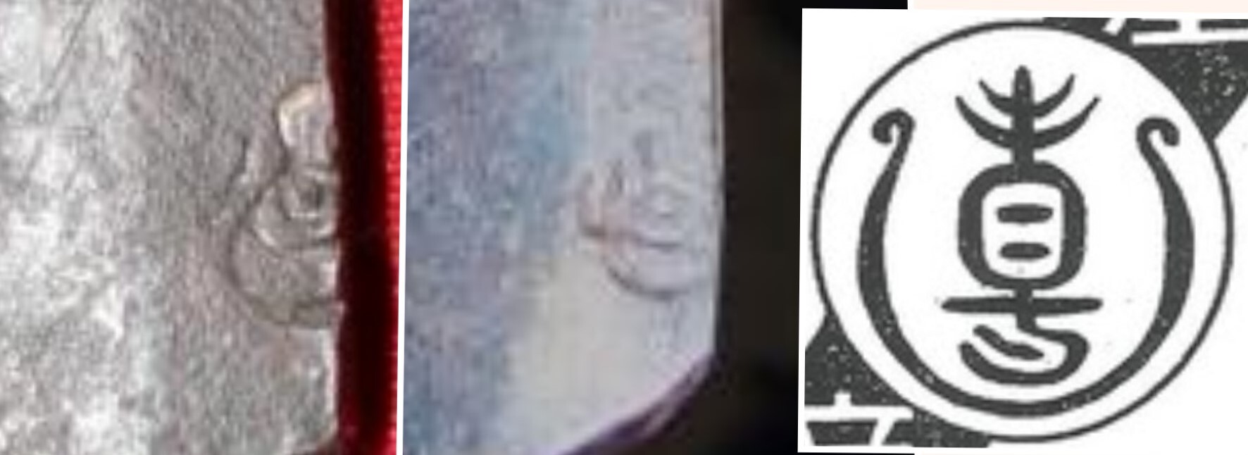

Bruce Pennington Posted November 10, 2020 Author Report Posted November 10, 2020 On 11/10/2020 at 5:43 AM, george trotter said: does pic 1 look like the logo on this 1942 advert for the Suya Sword Shop Expand I don't know, George. And actually, now that I'm staring at them again, I remember that both #1 & 3 are the same stamp (different blades). Someone had earlier identified the symbol as the "flaming jewel." But significance unknown. But I've put them together for a better look. 1 Quote

Kiipu Posted November 13, 2020 Report Posted November 13, 2020 See this recent article for a complete image of the flaming pot/jewel symbol. This symbol only seems to show up from this group of smiths? Amahide & Seki Nihonto Tanren Jo The source of the two illustrations above can be found below. north china railway winged wheel stamp Quote
