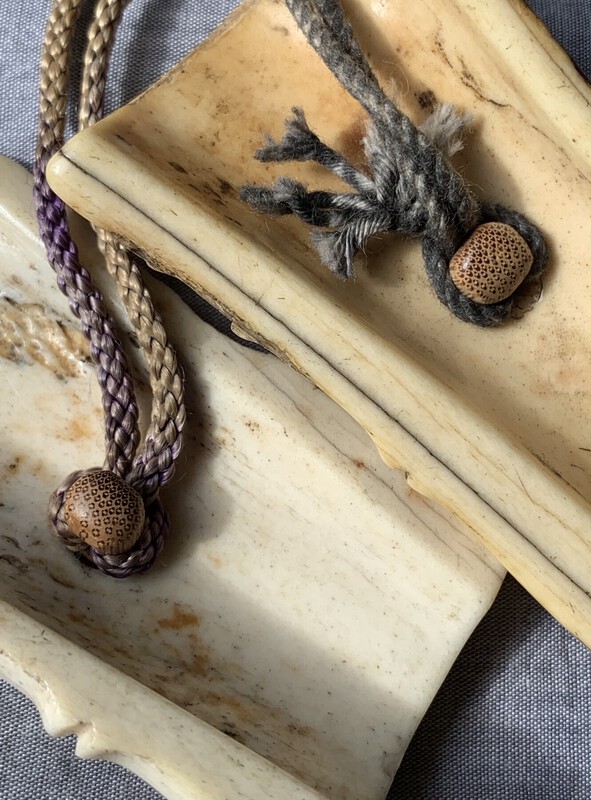

Malcolm, Madake or Giant Timber Bamboo can grow to 70 feet high. We have hundreds of them encroaching on the garden here. In our flexible friend Wiki's article it mentions how it is suited for making things such as shakuhachi. As to Mekugi, I can believe that what you heard was probably correct, although I have not run across this gem of wisdom myself. I have made pegs/pins for Netsuke, and Mekugi for guns and swords out of susudake; the patterns revealed in the cross-section can be bewitchingly beautiful. (See this example.)
