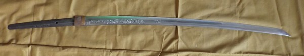

Guys, I appreciate your help and uploaded some blade pics as requested.
Dear Inna.
Welcome to NMB!  What we would like is a shot of the whole blade, like this please.
Please also remove the habaki, the blade collar, so that we can see the whoe of the nakago, the tang.
Looking forward to it, this sword has nice mounts as others have said.
All the best.
Dimensions of the blade could help estimate the time period it was made.
The distance between the holes in the tang can help estimate how much a blade was shortned, looks for me like ~5-6cm. (sometimes the blade is so much shortned that the original first mekugiana (hole in tang) is also cut of but i dont think this is the case here.)
Im also not sure how much the blade is tapering to the tip because of your photos angle.
But from what i see actually it looks like an edo blade made in ~1660 with nice fittings.

Here are some more photos
as someone  said it was probaly made during the the kanbun era 1661-1673  the hamon almost     non existent that sword has been polished  Quite a few times the ha looks like it is getting thin
