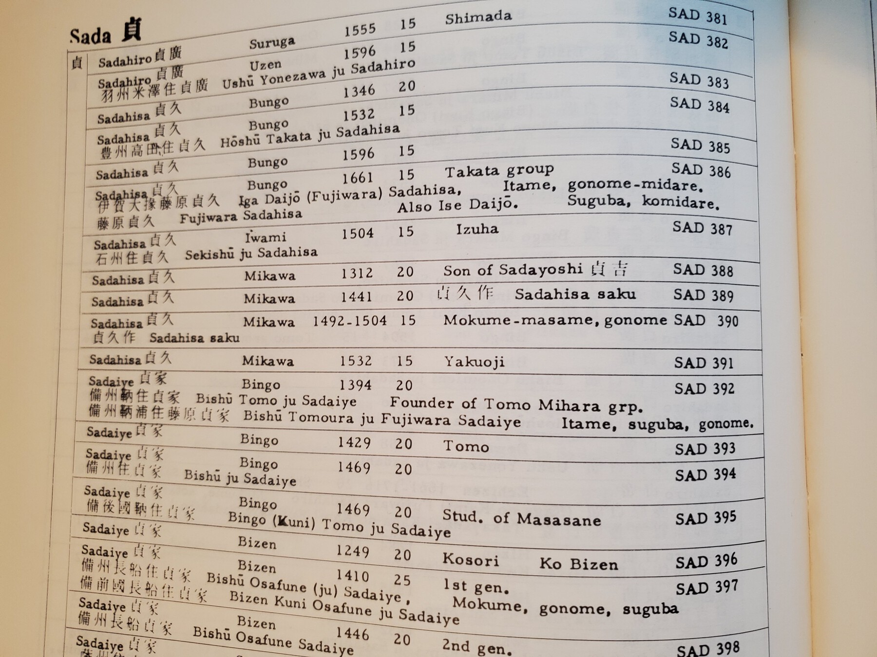

Yours looks like 来貞久作 (Rai Sadahisa saku)
This is a signature that doesn't show up in my online searches.
In Markus Sesko's swordsmith compendium, there are three smiths who used the name 貞久: one who worked from 1532-1555, one who worked from 1596-1615, and another who worked from 1661-1673. None of these three used "Rai" in their name, as far as I know. ("Rai" is a family/lineage of swordsmiths).  There was a smith in the late 1600s who signed 越中守来貞幸 (Etchū no kami Rai Sadayuki), so I would guess your smith may be related to him since they both use the same kanji for Sada (貞) and both are claiming the "Rai" lineage. The timing feels better also, since the wakizashi comes into wider production from the 1600s.
You need to look closely at the kanji on your sword, as there are many kanji that have identical readings.
The kanji on your sword is
And the kanji you are showing me in the book is
You need to be looking for swordsmiths who signed with 貞久.
