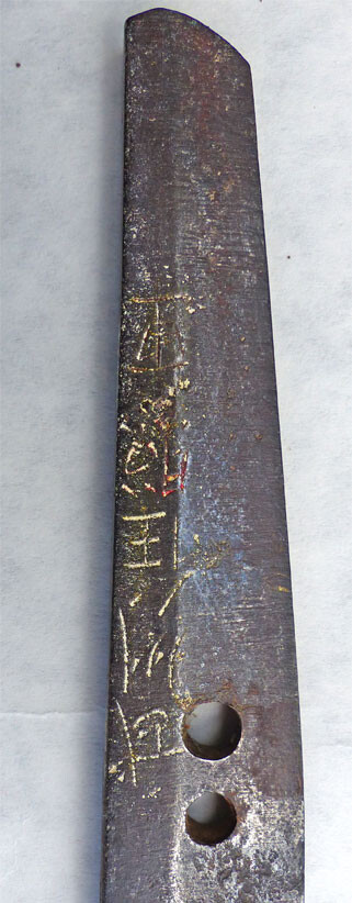

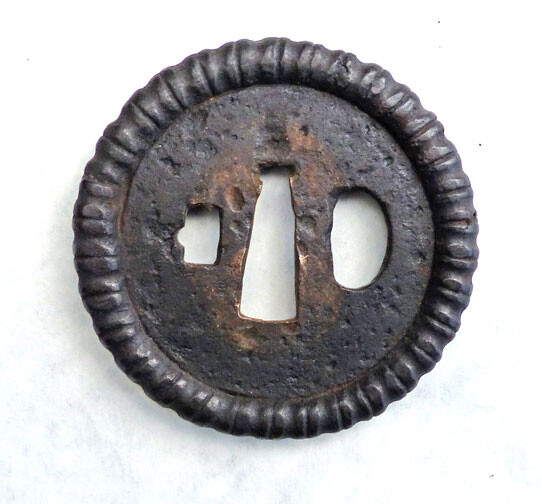

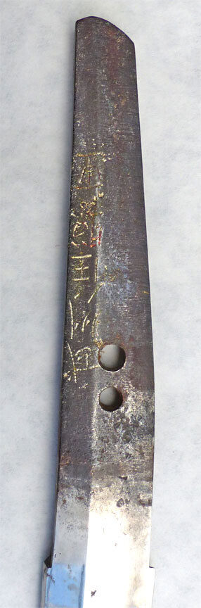

Here is a very plain Katana that I have had for years. The fuchi and kashira are horn and the tsuba is plain iron. The tang is signed. Any information on it would be very much appreciated. I hope the calligraphy can be read it's somewhat corroded. You can mostly see the straight temper line. Thank you in again. I collect mixed metal work which is straight forward but there are so many subtleties when dealing with sword blades. Its mindboggling, at least to me.
The pics of the tang (nakago) are actually upside down, for what it's worth.  An experienced reader can still translate it though I'm sure.  Do you have the overall length of the cutting part of the blade (nagasa) by chance?  This looks more like a wakizashi to my (inexperienced) eyes than a katana to me, but this length will tell for sure.
I'm more interested in kachushi-tsuba, which seems to be old, and the scabbard with elaborate decorative paint. If it is 21.5 inches (54.6 cm), it is the standard length and style of Wakizashi used throughout the Edo period.

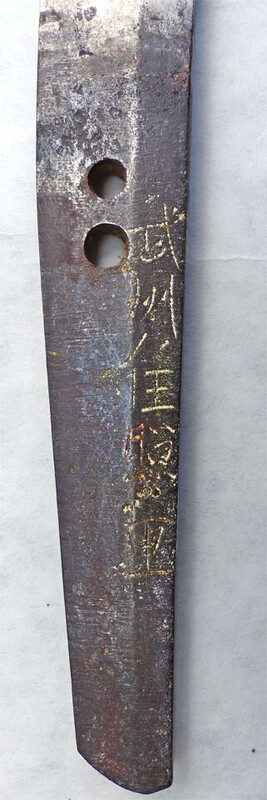

From the information Mr. Singer supplied I have tried to research this sword smith and I believe this sword was made by Bushu Ju Terushige from Musashi province of the Shitahara school during the late Muromachi to early Edo period? Is this correct or am I way off base. Here are a couple of better photos of the sword. Thank you Mr. Singer for the translation
