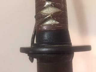

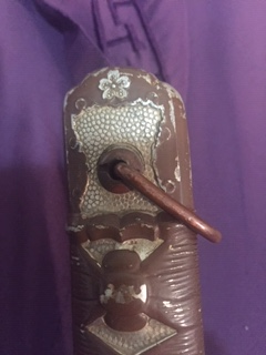

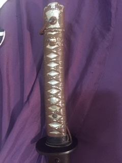

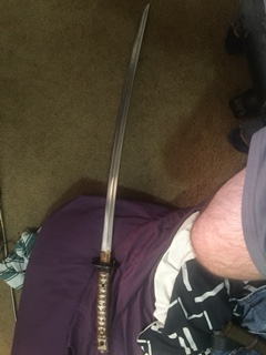

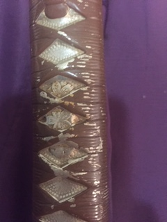

ribendao Posted October 22, 2020 Report Posted October 22, 2020 I have a couple of type 95s in my collection but this one has always given me a little heartburn. I think there is a possibility it might be a fake. The reasons I believe this are listed below: 1. The paint on the handle is like 95% still there, which seems to be very rare/unusual 2. The paint seems to be a strange shade of reddish brown that I haven't really seen before. 3. Even though the majority of the paint is in there, the Menuki seems damaged/ worn. 4. The blade just seems to be in much better/newer shape than my other type 95s. Would love to hear what you all think? Quote
vajo Posted October 22, 2020 Report Posted October 22, 2020 Your pictures are to small to see anything. Make shots from the stamps. Fuchi und Blade. The No. on the blade looks good from the far. Quote
ribendao Posted October 22, 2020 Author Report Posted October 22, 2020 Sorry about the poor pictures. I took them a while ago and the sword is at home while I am currently in the office. The fuchi is all iron and have looked very carefully but have seen no stamps. The only stamp I have seen is next to the serial number and I believe it is this Kanji 東. I will try to get better pictures when I get home tonight. 1 Quote
vajo Posted October 22, 2020 Report Posted October 22, 2020 Overall i don't think it is a fake sword. The no. looks good and i think is see a stamp on the blade. Quote
ribendao Posted October 22, 2020 Author Report Posted October 22, 2020 Great! My biggest question is how would the menuki get this worn look while the rest of the handle and paint seems to be in such good shape? Seems counterintuitive to me. Quote
ChrisW Posted October 22, 2020 Report Posted October 22, 2020 It would be where one would naturally grip the cast tsuka is my guess. Also it appears to have paint damage on the highest points, which makes logical sense; they take the knocks first. Quote
16k Posted October 22, 2020 Report Posted October 22, 2020 I think it is real, but I think the tsuba and fuchi have been repainted. Now, it might look different in hand, but the color of the tsuka doesn’t seem shocking. Quote
ribendao Posted October 22, 2020 Author Report Posted October 22, 2020 Thanks again for all the info. I feel more confident in the sword now. Quote
BANGBANGSAN Posted October 22, 2020 Report Posted October 22, 2020 On 10/22/2020 at 2:40 PM, ribendao said: Sorry about the poor pictures. I took them a while ago and the sword is at home while I am currently in the office. The fuchi is all iron and have looked very carefully but have seen no stamps. The only stamp I have seen is next to the serial number and I believe it is this Kanji 東. I will try to get better pictures when I get home tonight. Expand Looks legit to me, that Kanji should be 名 1 Quote
ribendao Posted October 22, 2020 Author Report Posted October 22, 2020 Ah you are right. I looked closer and it is 名. Quote
Shamsy Posted October 22, 2020 Report Posted October 22, 2020 Absolutely 100% real, no doubt at all. On 10/22/2020 at 2:14 PM, ribendao said: 1. The paint on the handle is like 95% still there, which seems to be very rare/unusual 2. The paint seems to be a strange shade of reddish brown that I haven't really seen before. 3. Even though the majority of the paint is in there, the Menuki seems damaged/ worn. 4. The blade just seems to be in much better/newer shape than my other type 95s. Expand A lot of these later swords have great paint retention. Paint shades and colours vary, no issue. Menuki often are, it's the edges, the way the sword is held, the fact they are raised and (pure conjecture) perhaps the type of paint used. You got a really nice example. Congratulations, don't consider condition a bad thing! I don't think it's repainted at all. 1 Quote
Dave R Posted October 22, 2020 Report Posted October 22, 2020 "Menuki often are, it's the edges, the way the sword is held, the fact they are raised and (pure conjecture) perhaps the type of paint used." I think you have a point with the type of paint used. It's like lacquer and textile dyes, some colours perform differently to others. Quote
