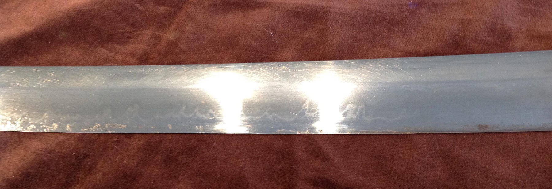

mywei Posted October 20, 2020 Report Posted October 20, 2020 The first one has got a mino feel to it IMO The wakizashi is interesting, signed Aizu Motooki with a cutting test. 1 Quote
French nihonto Posted October 20, 2020 Report Posted October 20, 2020 Very nice blade with cutting test, Aizu Motooki has the rare peculiarity of being born with the title of samurai, before becoming a blacksmith. Quote
16k Posted October 20, 2020 Report Posted October 20, 2020 I agree that the first one has the usual Seki feel to it. It could be traditional, but somehow, I doubt it as I have Avery similar blade (my very first one actually, mumei, no stamp, but definitely non-traditional. The second one, on the contrary, appears to be valuable and I like the sugata and Hada. Great find imho Quote

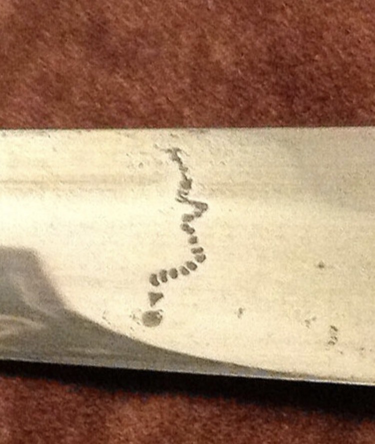

French nihonto Posted October 20, 2020 Report Posted October 20, 2020 What's that black dot on the surface of the first blade that forms a line? some symbols almost look like man-made. Quote
16k Posted October 20, 2020 Report Posted October 20, 2020 Probably a clump of ji nie (sumigane). Quote
Geraint Posted October 20, 2020 Report Posted October 20, 2020 Dear Alik. Well, the first one at the moment seems fairly ordinary, don't do anything to it except wipe the blade down with a little light oil at the moment. Forgive me if you know this but you should never touch the blade with bare hands, only the nakago, (tang). The second is fare more interesting and you should go carefully with it. Ideally a member here will be within reach and will be able to give you a more informed opinion from and in hand examination. To start with it is a nice shape, the large kissaki, (point),is often found in Shinshinto swords. The signature is of a very good smith and the cutting test makes it even more desirable. Now a caution, big names are often faked so don't give up the day job just yet. It is in it's civilian koshirae, (mounts), which still has the kurikata and fittings protruding through the leather combat cover. If these are your first two Japanese swords then you have done well, we look forward to seeing what happens with that wakizashi. All the best. Quote
French nihonto Posted October 20, 2020 Report Posted October 20, 2020 30 minutes ago, 16k said: Probably a clump of ji nie (sumigane). Possible, by enlarging it seems less "natural" than a sumigane, with well defined symbols such as the "S", the arrow and the well defined point at the bottom. But it's probably my imagination, you're probably right. Quote
vajo Posted October 20, 2020 Report Posted October 20, 2020 Mino Waki in Gunto Koshirae with cutting test is very nice. You should handle it with care. Quote
16k Posted October 20, 2020 Report Posted October 20, 2020 34 minutes ago, French nihonto said: Possible, by enlarging it seems less "natural" than a sumigane, with well defined symbols such as the "S", the arrow and the well defined point at the bottom. But it's probably my imagination, you're probably right. No, not a sumigane. We weren’t speaking about the same sword. Here, I have no idea what this is. Almost looks man made. Perhaps an inclusion of some sort... Quote
vajo Posted October 20, 2020 Report Posted October 20, 2020 No clear line of the shinogi. The polish is terrible. Maybe someone tryed to polish it. Something funny. I read a book about a hidden treasure on a pacific island during the ww2 and the Japanese commander had scripted the place on a samurai sword. I didn't remember the name but maybe? 😉 1 Quote

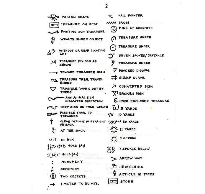

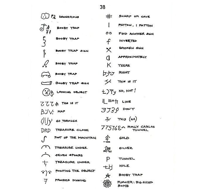

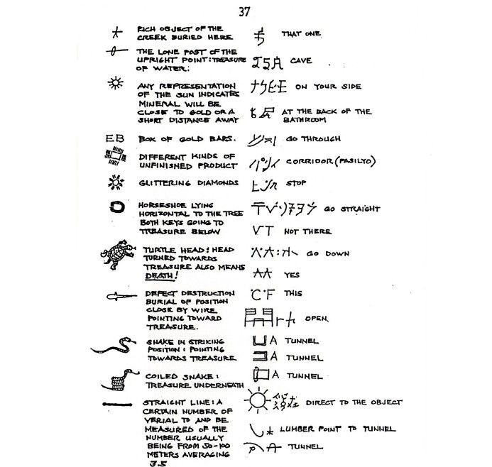

French nihonto Posted October 20, 2020 Report Posted October 20, 2020 44 minutes ago, vajo said: No clear line of the shinogi. The polish is terrible. Maybe someone tryed to polish it. Something funny. I read a book about a hidden treasure on a pacific island during the ww2 and the Japanese commander had scripted the place on a samurai sword. I didn't remember the name but maybe? 😉 I confess, it's a little bit where I wanted to go, it looks a lot like what we found on the maps concerning the famous treasure of Yamashita, they even created a code for the occasion it seems to me, we can find fragments of this code everywhere. It makes me think a lot about it. You never know. A fragment of this famous code: 2 Quote
vajo Posted October 20, 2020 Report Posted October 20, 2020 Wow - now we have a treasure map on a blade! 😀 2 Quote
French nihonto Posted October 20, 2020 Report Posted October 20, 2020 43 minutes ago, vajo said: Wow - now we have a treasure map on a blade! 😀 Haha it's probably not the case but that's already seen. It is especially a good pretext to talk about this exciting story of the treasure of Yashimata. Holds other fragments of the code, it's for you Chris : Quote

AlikN Posted October 20, 2020 Author Report Posted October 20, 2020 Thank you guys! ...for all of the info and suggestions. Here is another picture of that spot . Is there any members in Seattle area? Quote

SteveM Posted October 21, 2020 Report Posted October 21, 2020 12 hours ago, AlikN said: One more question, use of wakizashi in ww2 instead of a full size sword. Was this guy to short to use a full size or his speciality wouldn't allow him to use it? The sword is a family heirloom, rather than a newly-made arsenal sword. The bearer had military mounts made for his family sword. There are many such short swords repurposed for military use. They are often erroneously referred to as "pilot's swords", with the assumption being that pilots would use shorter swords, but I think this site has disproven that claim fairly comprehensively. The inscription (the ones in blue are written by the cutting tester) 乳割土壇払 Chichi-wari dotanbarai 天保十年二月日於江府作 Tenpō jūnen nigatsujitsu oite Kōfu saku 会津住元興 Aizu-jū Moto-oki 同年十月二日於千住神谷清治試之 Dōnen jūgatsu futsuka, oite Senjū Kamiya Kiyoharu tamesu kore Cut across the chest Made in Tenpō 10 (1839) February, Kōfu Moto-oki from Aizu province/city Cutting test performed in the same year, October 2nd, at Senjū, by tester Kamiya Kiyohara So the swordsmith Moto-oki made this sword in February of 1839, and someone had it tested by cutting it across the chest of a cadaver (probably) in October of 1839. I didn't find this tester's name in Guido's list of famous testers, or anywhere else on the internet, so it looks like the tester is someone lost to history. It also looks like the tester didn't have room to write everything on one side, so he continued on the other side, which is slightly unusual. The longer sword is a typical military/arsenal blade. 10 3 Quote
