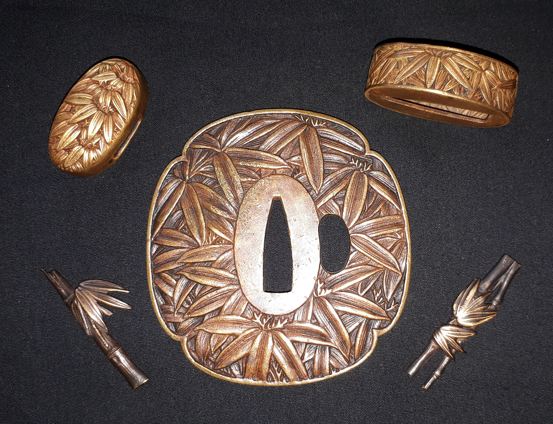

vajo Posted October 13, 2020 Report Posted October 13, 2020 I think you mean such a tsuba with that fuchi kashira? (edit i found the picture of my set 😂) the color is not correct under flashlight. Tsuba and FK + menuki looks golden. Ohmura study koshirae.. 5 Quote
Baka Gaijin Posted October 13, 2020 Author Report Posted October 13, 2020 Good evening Chris, that is exactly the pattern I have in mind. Quote
vajo Posted October 13, 2020 Report Posted October 13, 2020 Ohmura declares the koshirae as civillian employee. The other two pattern was Sakura and a old tachi style tsuba. http://ohmura-study.net/728.html 1 Quote

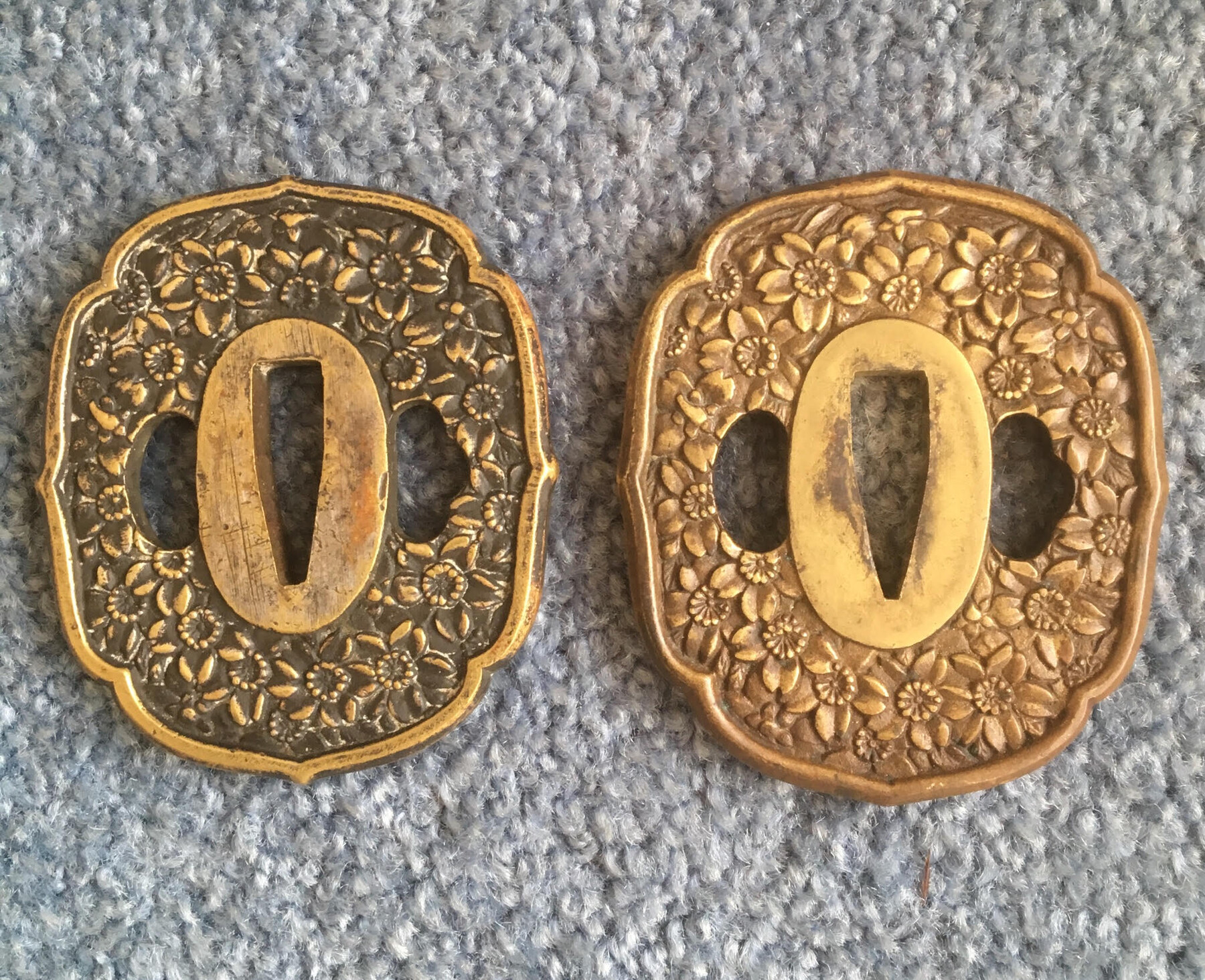

IJASWORDS Posted October 14, 2020 Report Posted October 14, 2020 I have collected a few of these over the years, and think that they were also used interchangeably with the bamboo. It is no optical illusion, the one on the right is larger. That means at least two pieces of dies or molds. Still on the lookout for a matching F/K set. 5 Quote

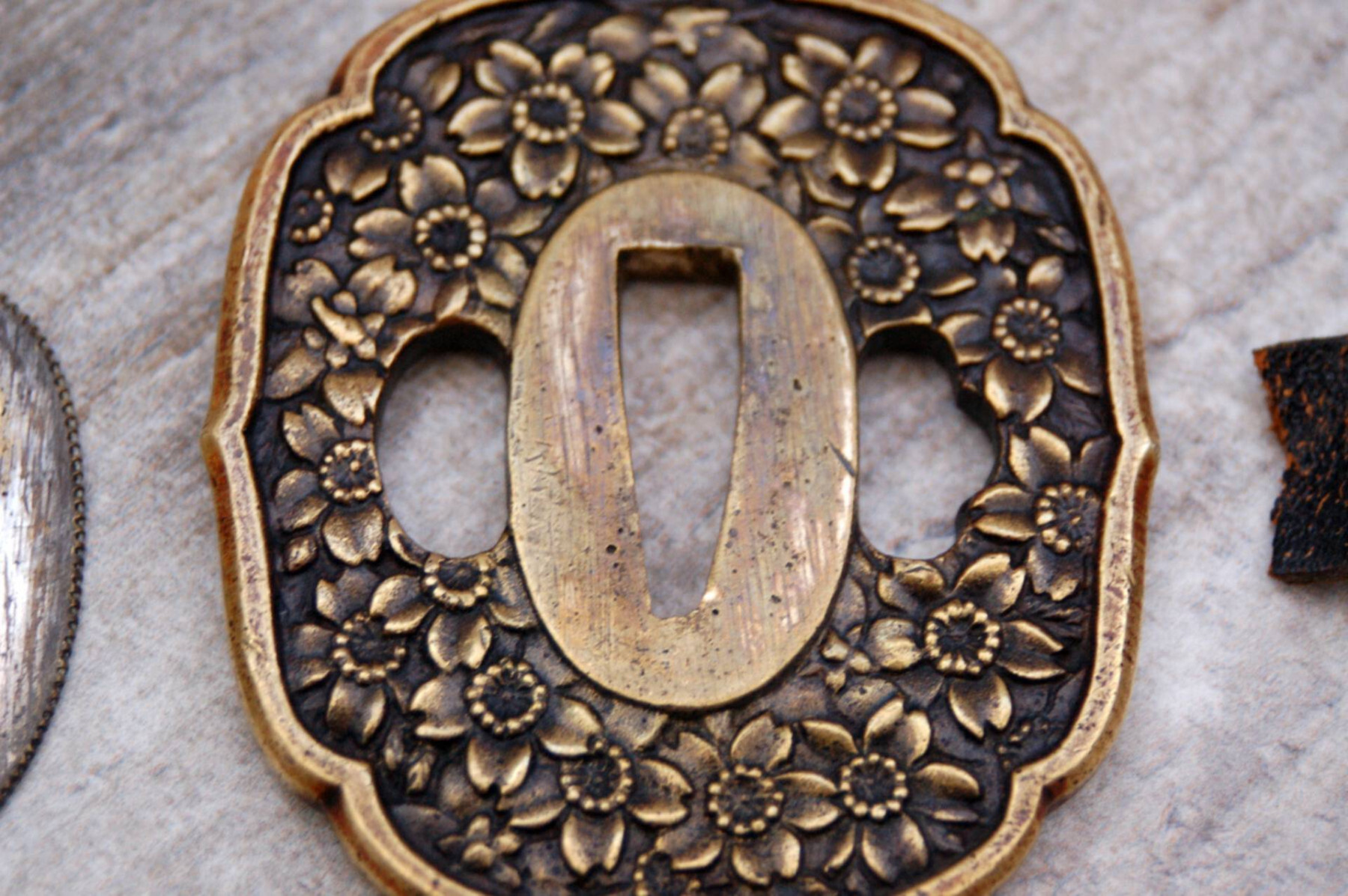

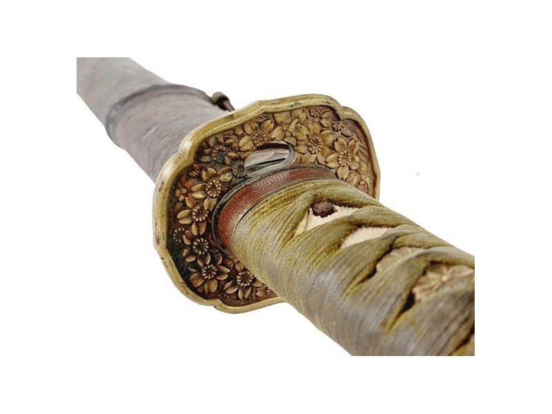

Mortis Posted October 14, 2020 Report Posted October 14, 2020 Here’s one that’s for sale in the U.S. Seems very similar to the variations being discussed. 2 Quote

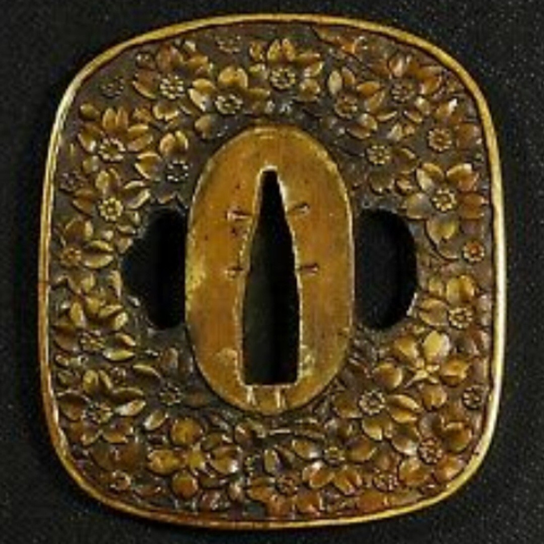

vajo Posted October 14, 2020 Report Posted October 14, 2020 Yes thats the Sakura pattern but the tsuba is false. I think the tsuka is from a civilian employee sword. Nice! Thanks for showing. This is a plum (or is it cherry/ sakura?) pattern tsuba from a civillian koshirae i think. I saw a sword with purple ito and those Tsuba with fuchi kashire pattern (so i think it is plum motif). I belive this is silver plated. I search for the right FK to make a set. Quote
Bruce Pennington Posted October 14, 2020 Report Posted October 14, 2020 This should be cherry. It has the split at the end of each petal. Plum petals are round. 1 Quote

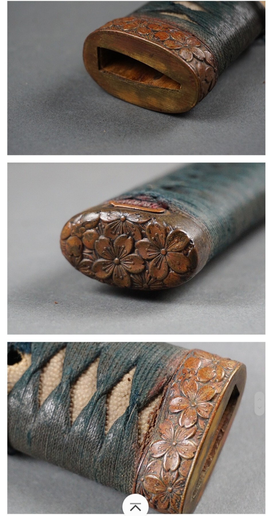

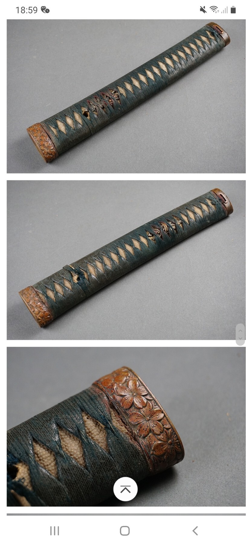

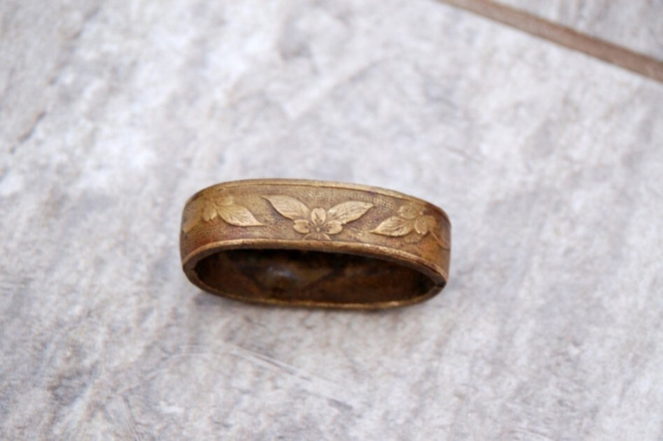

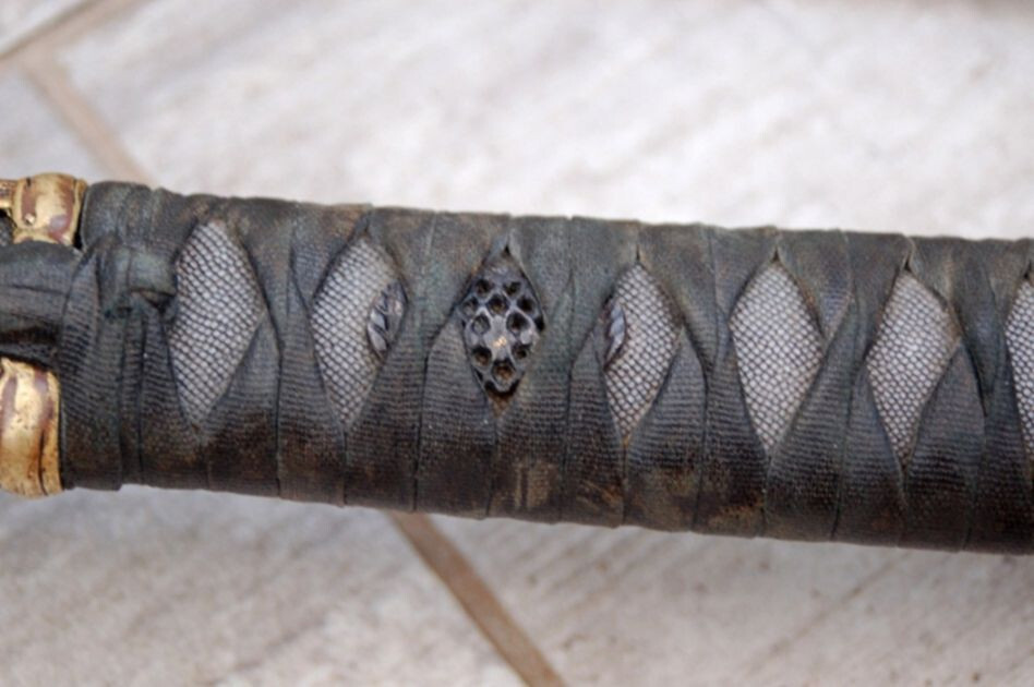

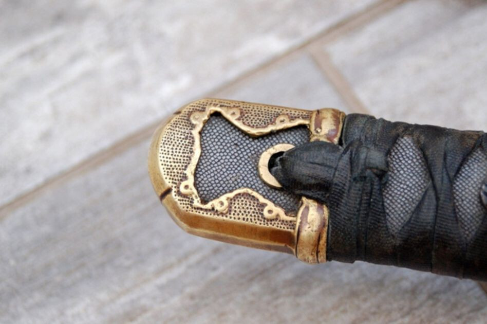

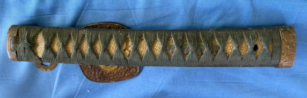

Itomagoi Posted November 14, 2021 Report Posted November 14, 2021 Hey Chris, like this tsuka? But it is the Sakura type. 1 Quote
vajo Posted November 14, 2021 Report Posted November 14, 2021 Hi Peter, nice tsuka but the condition is like the most others not the best. Thanks for showing. Did you have it? Quote

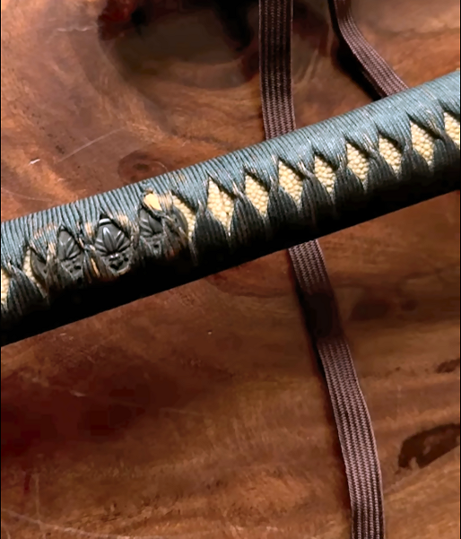

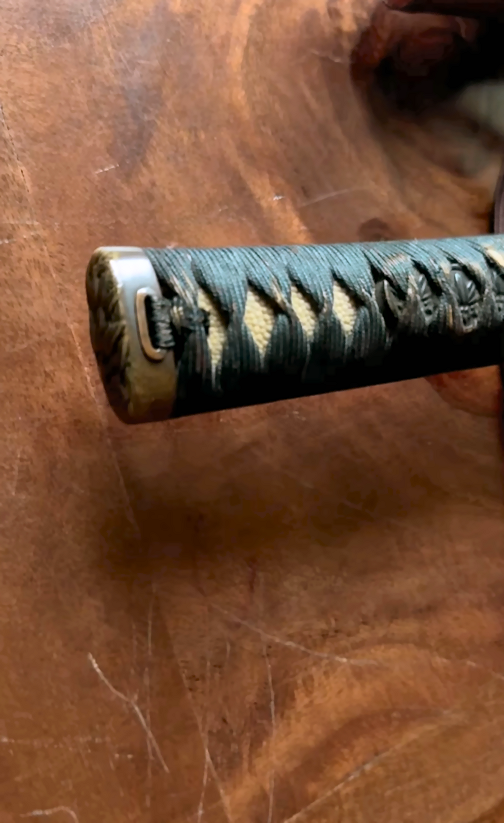

vajo Posted November 16, 2021 Report Posted November 16, 2021 This one is on Facebook. Military Swords of Imperial Japan (Shin Gunto) | Facebook 1 Quote
Bruce Pennington Posted November 17, 2021 Report Posted November 17, 2021 Hmmm.....me thinks I see a pattern of green ito! Interesting. Quote

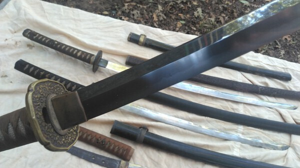

Itomagoi Posted November 18, 2021 Report Posted November 18, 2021 In the Background you can see a rare type of the sakura tsuba. Line this one: 1 Quote

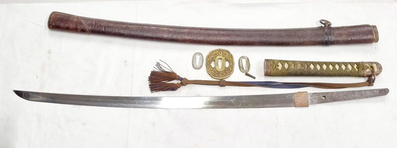

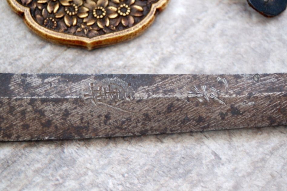

Bruce Pennington Posted February 25, 2022 Report Posted February 25, 2022 I've found 3 of the sakura pattern tsuba with Kanezane blades in them. I wonder if he had a direct contract with a shop that was selling these to Gunzoko. Also note the Company grade tassel. Too much water under the bridge..... don't remember if Nick Komiya stated the Gunzoku could use Army rank tassel, or if they were supposed to be using exclusively the all-brown. Either way, this shows a Civil service, Gunzoku, sword with an Army tassel. Seeing the personalization of gunto, that I have over the past couple years, it would not surprise me at all that a Company-grade equivalent Civil guy would put an Army tassel on his sword. Of course this could be post-war, too. Quote

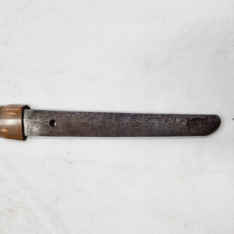

Bruce Pennington Posted April 16, 2022 Report Posted April 16, 2022 Ok, a new one - a 1943 Kanemitsu blade with a unique kiri engraving and LOOOONG inscription on the nakago mune that says "皇紀二千六百三年大東亜戦必勝祈願刀 – 2603 Imperial year (1943), a prayer sword for victory in the Greater East Asian War" thanks @Nobody! And thanks @Okan who found the gunto. Quote
Bruno Posted April 16, 2022 Report Posted April 16, 2022 Neil, Bruce and others, have you ever seen a water quenched WW2 era blade mounted in civilian koshirae with one of these fittings? I only saw showato. Quote
Bruce Pennington Posted April 16, 2022 Report Posted April 16, 2022 On 4/16/2022 at 10:41 AM, Bruno said: Neil, Bruce and others, have you ever seen a water quenched WW2 era blade mounted in civilian koshirae with one of these fittings? I only saw showato. Expand I have not been noting the blades in these, so I don't have a feel for it. Maybe one of the other guys might. I'll try to watch that from now on. Quote

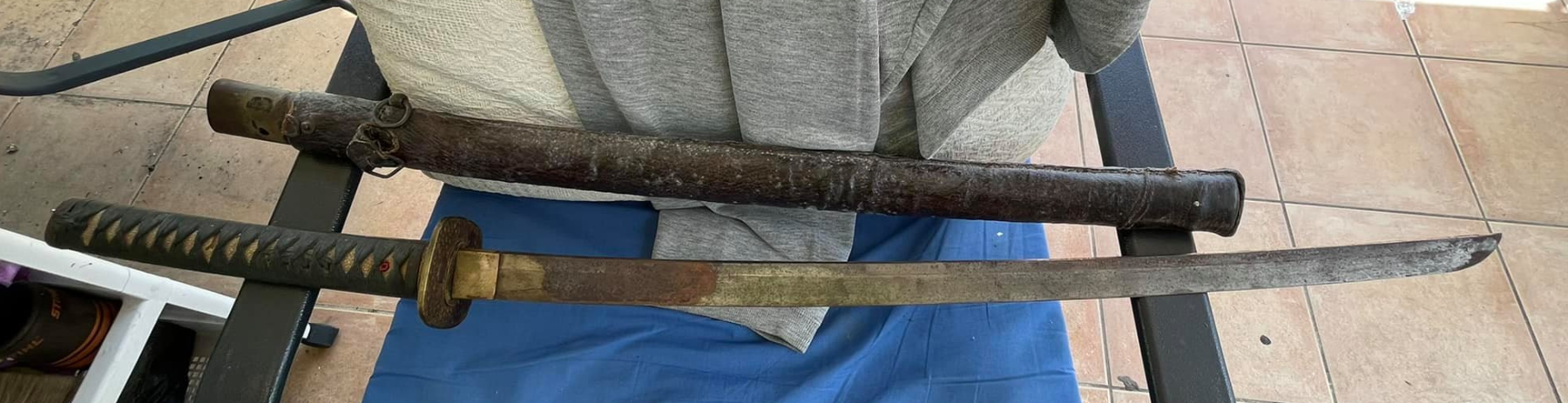

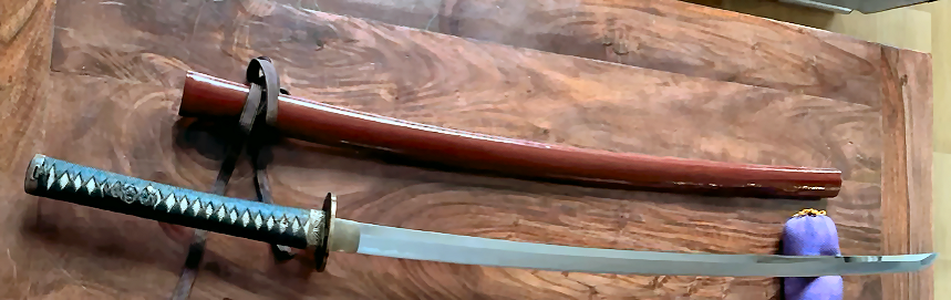

vajo Posted November 13, 2024 Report Posted November 13, 2024 Bamboo leaf themed civillian gunto. Krystian sold it. Blade is made by Kaneharu. First time to see that themed gunto in such a good condition. The blade looks very good preserved and the fittings are stunning. Only the saya doesn't look original. 1 Quote
