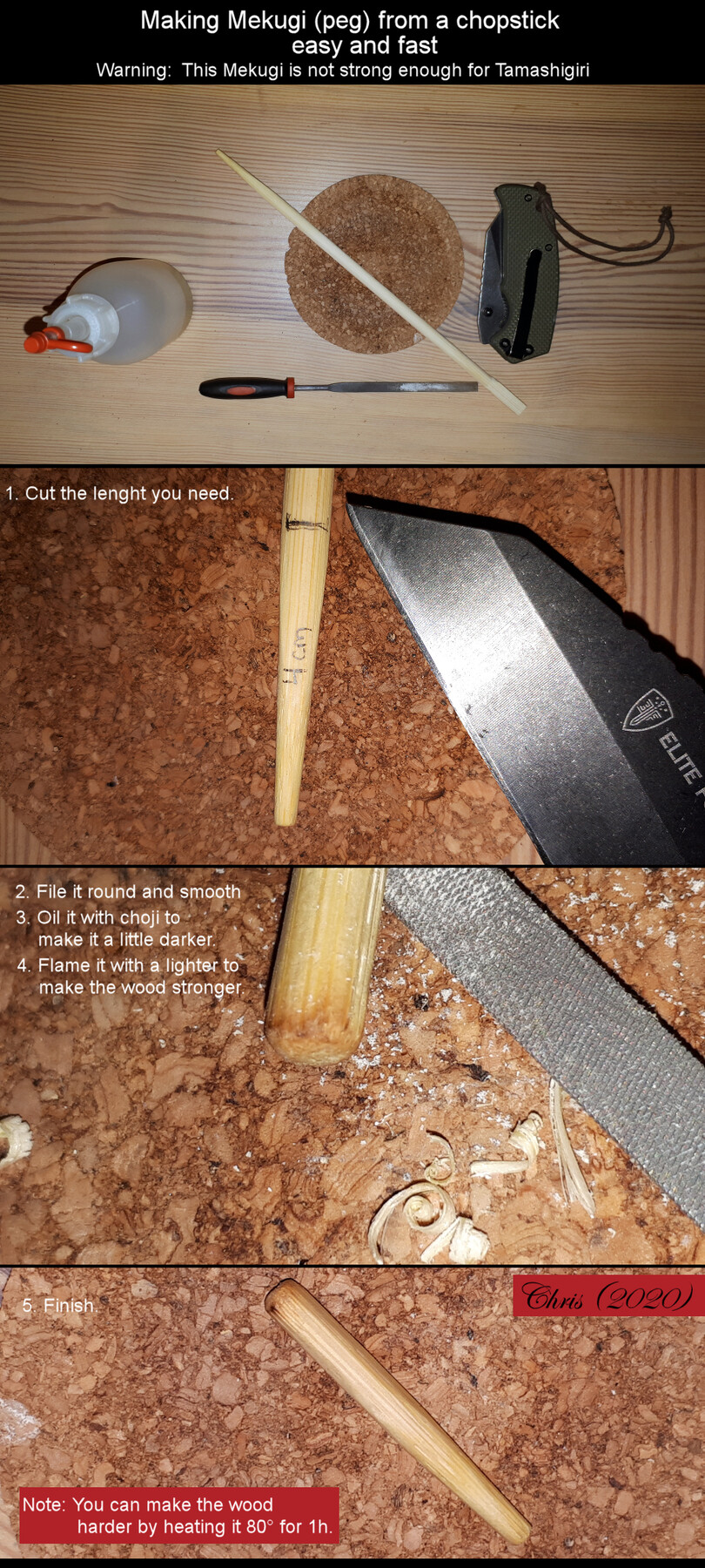

Grey Doffin Posted October 11, 2020 Report Posted October 11, 2020 Hi Thomas, Chris, whichever, I don't think the bolt is original; there should be a bamboo pin. You can whittle one to fit from a good quality chopstick (not the standard Chinese restaurant throw away variety). Here is a link to a care and handling brochure; you should read it carefully. It will tell you how to remove and replace the handle. http://nbthk-ab.org/cleaning-maintenance.php Cheers, Grey Quote

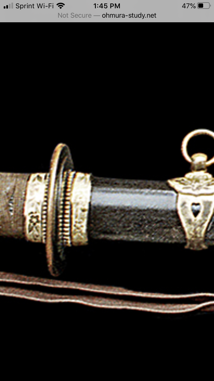

Bruce Pennington Posted October 11, 2020 Report Posted October 11, 2020 Ohmura has one with the fat seppa. The only thing wrong with the seppa is the forward one is out of order. 1 Quote

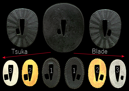

twoscoops Posted October 17, 2020 Author Report Posted October 17, 2020 The two end pieces are different sizes. Quote
vajo Posted October 17, 2020 Report Posted October 17, 2020 This is the way to assambling it. They have different sizes. Many dont know how to assambling it correct. the smaller ones goes through the tsuka side, the bigger ones to the blade (Starting from the Tsuba with the bigger seppa on each side to the smallest) 1 1 Quote
PNSSHOGUN Posted October 17, 2020 Report Posted October 17, 2020 Sometimes if you're lucky they are marked with roman numerals to denote the order, I wonder if it was done at the factory or by the officer? I would also recommend ikea chopsticks, the bamboo is of decent quality, already lightly stained and very cheap. Quote
Bruce Pennington Posted October 17, 2020 Report Posted October 17, 2020 I really like that style of the rising sun dai-seppa! If you haven't found the site already, you'll really learn a lot about these at Ohmura's site. Here is the link to the beginning of his Kai-gunto pages: Naval Officers Type Tachi. Once there, you can read through the pages on the Kai-gunto. Once done, click on the Table of Contents page and you'll see links to all the gunto. It's quite a treasure trove of pictures and information. 1 Quote
