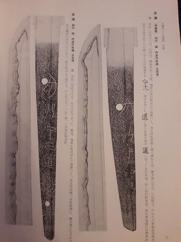

Gunome Posted October 13, 2020 Report Posted October 13, 2020 Hello, Here is what there is in Nihonto Zuikan for Tamba no kami Yoshimichi Sorry for poor quality of the picture 5 1 Quote
Bugyotsuji Posted October 13, 2020 Author Report Posted October 13, 2020 Thank you Sebastien. The variety in boshi shape is amazing. Sadly the texts are too blurred to read (on my phone at least). Quote
Yoshimichi Posted October 14, 2020 Report Posted October 14, 2020 Dear Sabastien: Thanks for the additional oshigata. Very helpful to the discussion. Regards, Bill E. Sheehan (Yoshimichi) Quote
Gunome Posted October 14, 2020 Report Posted October 14, 2020 Hello Piers, On my phone I can click on the picture and then enlarge it. Indeed, some pics are blurred, but some seems readible. However, I will try to redo it better 1 Quote
Gunome Posted October 15, 2020 Report Posted October 15, 2020 Hello, I tried to redo photos. I hope it is better now 3 1 Quote
Bugyotsuji Posted October 15, 2020 Author Report Posted October 15, 2020 Much better, Sebastian, thank you! Quote

Jacques D. Posted October 15, 2020 Report Posted October 15, 2020 Just to add, the last pictures kindly shared by Sebastien are all of the Kyo branch Quote
Gunome Posted October 15, 2020 Report Posted October 15, 2020 Hello, You are right, last bunch of oshigata is only Kyo. Based on the index, there is : - "Kyo tamba kami" shodai, nidai, yondai and godai - "Enryoshi, Kyo tamba kami" shichidai - "Osaka tamba kami" shodai, nidai, sandai I Don't add the Yamato ones as Piers' sword is signed Tamba no Kami. Here are better pics of Osaka ones: 1 Quote
