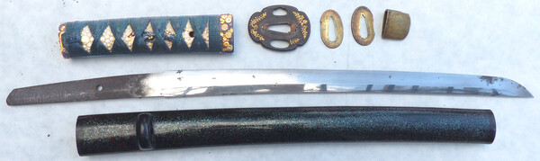

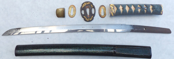

Tonkotsu Posted October 4, 2020 Report Posted October 4, 2020 Here is a very small wakizashi with a total length of 43.5 c or 17 1/4". The hamon is straight. I photographed everything so you can get an idea of the quality. There is a rust spot at the boshi which is stable. The mei is hard to see so I have tried different ways of presenting it. Any information you can give me about this sword would be very much appreciated. Thank you. Dick Quote

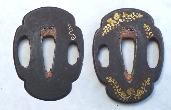

ROKUJURO Posted October 4, 2020 Report Posted October 4, 2020 Dick, the TSUBA and NAKAGO photos are upside down which makes it difficult to read. MEI might be HIZEN no KUNI JU xx KIYO. Not sure about the first KANJI of the name. Of course you usually cannot show the quality of a sword with these photos, but it looks like a nice package altogether. Rust on a blade is never really stable as there is oxygen and moisture permanently around. Rust is iron transformed into its oxides, so some material is always lost. 1 Quote
SteveM Posted October 4, 2020 Report Posted October 4, 2020 肥前國住忠清 Hizen kuni jū Tadakiyo As always, there is no guarantee this signature is genuine. Quote

Geraint Posted October 6, 2020 Report Posted October 6, 2020 Dear Dick. Nice find and pleasing koshirae. Just to confirm, you mention the length as the, 'total length'. Is the figure you gave based on the length from tip to the end of the nakago? If so then could you give the measurement from the tip to the notch where the nakago starts as this is the nagasa and significant in this case. All the best. Quote
Tonkotsu Posted October 6, 2020 Author Report Posted October 6, 2020 Hi Geraint, The length of the blade from the munemachi to the tip is 31.5 cm. Dick Quote
