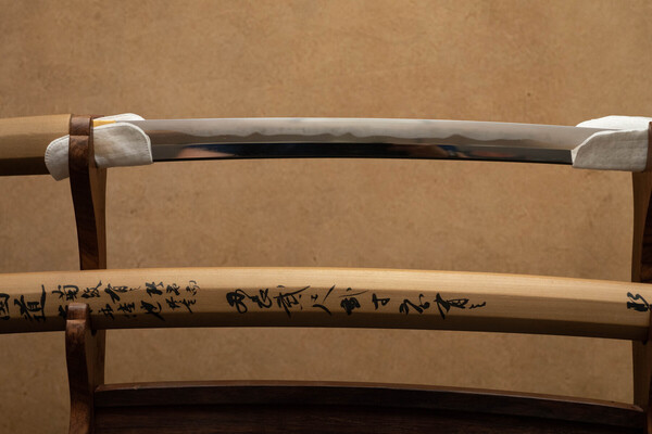

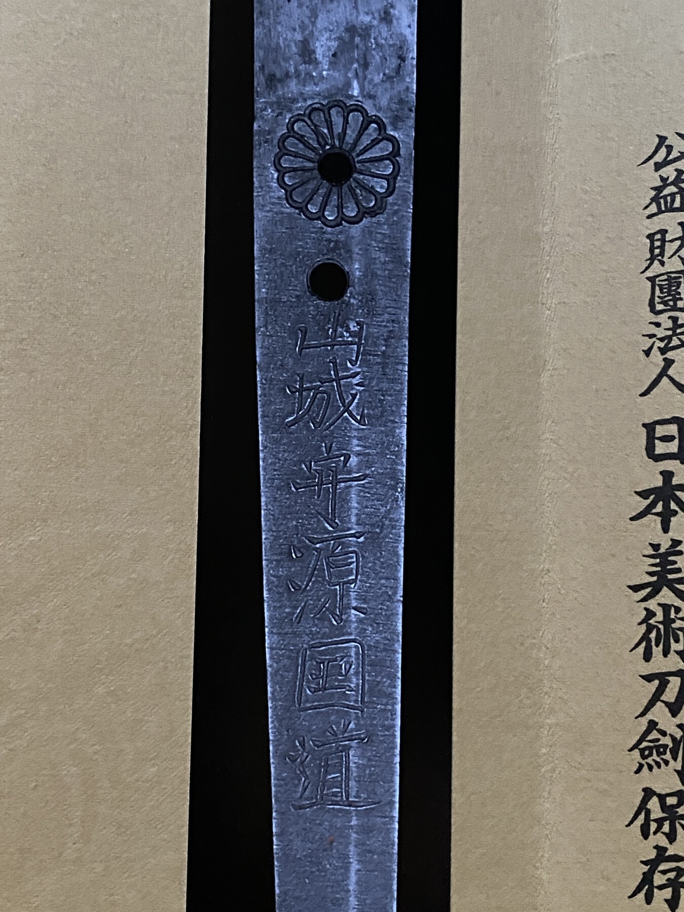

jmoto Posted September 29, 2020 Report Posted September 29, 2020 Hello This forum has been a pleasure to read and I very much appreciate all the knowledge here, for a new collector like me it has been a great resource Wanted to post a picture of my first blade, a katana. Yamashiro Minamoto Kunimichi Tokubetsu Hozon papers and sayagaki by Sato Kanzan Wondering about the meaning of the kikumon on the nakago was this a common practice? Thanks Jason 9 1 Quote
Geraint Posted September 30, 2020 Report Posted September 30, 2020 Dear Jason. I am really surprised that no one has commented on this. You seem to have started collecting in the way that we all advise others to do but failed to do ourselves. Most of us started with a pretty dodgy sword and then found out what we were looking at. To start with a papered Shinto katana which is ubu, in full polish and with Kanzan sayagaki is pretty good going. It's a lovely sword! You will have done your research and know who the smith is and how he fits into the pattern of Shinto smiths. The Kiku mon was given to a number of Shinto smiths, it's not what you would call common but it is characteristic of certain smiths. All the best. 4 Quote
Babu Posted September 30, 2020 Report Posted September 30, 2020 Yes very lovely I just didn't see the thread until now. I do love a good sayagaki. I also like to see a sword in mounts is that your intention long term or do you prefer the shirasaya alone? Quote
Brian Posted September 30, 2020 Report Posted September 30, 2020 I assumed others would have stated the obvious....so I'm glad Geraint did. 🙂 Congrats and well done indeed for starting out with such a lovely sword. I wish even 5% of us did the same. You did great and I think you'll enjoy it for many years. 2 Quote
Nihonto Otaku Posted September 30, 2020 Report Posted September 30, 2020 Wow! Sayagaki from Sato Kanzan sensei. I like his calligraphy works. Sato Kanzan sensei and Honma Kunzan sensei were the leading founders of NBTHK and the heroes who saved Nihonto from being destroyed after world war II Amazing! This sword really is a treasure. Quote
Katsujinken Posted September 30, 2020 Report Posted September 30, 2020 Nice work. The right way to begin. How long is the blade (cutting edge / nagasa)? I believe smiths generally had to get permission to engrave the kikumon on their nakago (it's the imperial chrysanthemum after all), and so it was an honor to be able to do so. Welcome, Jason! Quote

jmoto Posted September 30, 2020 Author Report Posted September 30, 2020 Babu, Brian, TheBigAL, Katsujinken Thank you for your comments! @Babu - I am planning to leave this one in shirasaya alone for now. @Katsujinken - The nagasa is 26.3 inches on this blade Quote
Babu Posted September 30, 2020 Report Posted September 30, 2020 Yamashiro no kami Minamoto Kunimichi Size 2 shaku 2 sun 0.45 bu Active between 1661-74 He was a swordsmith of Iyo province. A Kikumon(chrysansemum crest) has been engraved on the tang and it is what is often referred to as the rustic style.Michina school often used this Kiki. They often call this Kunishige style sword work for obvious reasons. Hawley rates that Smith 20 points. he also Signed Heianjo fujiwara Kunimichi. The katana was forged in Iyo (Ehime prov., Island of Shikoku) during the Genroku period (1688-1704). Iyo Province (伊予国 Iyo-no-kuni) was an old province of Japan in the area that is today Ehime Prefecture on Shikoku.Iyo bordered on Awa, Sanuki, and Tosa Provinces. It was sometimes called Yoshū (予州) . Genroku (元禄) was a Japanese era name (年号, nengō,, literally “year name”) after Jōkyō and before Hōei. This period spanned the years from ninth month of 1688 through third month of 1704. The reigning emperor was Higashiyama-tennō (東山天皇). The years of Genroku are generally considered to be the Golden Age of the Edo period. The previous hundred years of peace and seclusion in Japan had created relative economic stability. The arts and architecture flourished 1 Quote

Michaelr Posted October 1, 2020 Report Posted October 1, 2020 Jason, what more can I say than has already been said above but WOW!!! You have started where many finish. You should be proud of your beautiful sword and just as proud of yourself for doing so well. Congrats MikeR Quote

Jacques Posted October 1, 2020 Report Posted October 1, 2020 On 10/1/2020 at 12:41 PM, jmoto said: Thank you for this information @Jacques D. I was a little confused trying to find info on this smith. Is he listed in by Fujishiro as Yamashiro no kami Minamoto Kunimichi or another name? Expand From Markus Sesko's book Kunimichi (国路), Genna (元和, 1615-1624), Yamashiro – „Heianjō-jū Kunimichi“ (平安城住国道), „Dewa no Daijō Fujiwara Kunimichi“ (出羽大掾藤原国道), „Dewa no Daijō Fujiwara Rai Kunimichi“ (出羽大掾藤原来国路), „Dewa no Daijō Kunimichi“ (出羽大掾十一辻), he was first a student of Iga no Kami Kinmichi (伊賀守金道) but studied later also under Horikawa Kunihiro (堀川国広), he signed his name in his early years with the characters (国道), the also early signature variant (十一辻) for „Kunimichi“ is a play on words: „Kuni“ can also be written with the characters „nine“ (ku, 九) and „two“ (ni, 二), added-up „eleven“ (十一), the character (辻) is actually read as „tsuji“ and has the meaning „road“, but road can also be written with „michi“ (道・路), sources which do not know this play on words quote the reading of the characters (十一辻) incorrectly as „Jūichitsuji“, from the 14th year of Keichō (1609) he signed his name with the characters (国路), the change is probably not connected with the receiving of the honorary title „Dewa no Daijō“ because he signed the latter also in combination with the variant (国道) for „Kunimichi“, his year of death is unknown, there exists a date signature of the fifth year of Keian (慶安, 1652) with the information „at the age of 77“ which calculates his year of birth as Tenshō four (天正, 1576), the latest extant date signature is from the ninth month of Meireki three (明暦, 1657) and is combined with the information „at the age of 82“, this signature is finely chiselled and it is therefore assumed that the blade is one of his latest works, the exact date when he received his honorary title „Dewa no Daijō“ is not known, the earliest blade signed that way is dated with the eighth month Keichō 20 (1615), therefore it is assumed that he received the title around Keichō 19 or 20, the using of the character „Rai“ (来) in some of his signatures alludes to a connection to the Mishina school, another support for this theory is that he signed his name during his early years with the „Mishina-michi“ (道), due to his long artistic period we know relative many blades by him, he was highly talented and one of the most outstanding smiths of the Horikawa school, we know works in the Keichō-shintō style of Kunihiro but his strong point was a flamboyant hamon with variation in the height and depth of the yakihaba and excellent nie- and nioi-based hataraki, in the shintō style he forged a dense ko-mokume and the hamon is here an ō-gunome-midare which bases on an ō-notare, but also an ō-gunome-midare or gunome-midare is seen, partially the gunome elments are densely arranged and seem like a single midare elements, the bōshi is a ko-maru agari which tends to midare-komi, when he worked in the Yamato tradition he forged a mokume mixed with noticeable masame, the hamon is here a chū-suguha with uchinoke in ko-nie-deki, the bōshi is ko-maru or ko-maru agari. Hope it will be useful. Quote
Babu Posted October 1, 2020 Report Posted October 1, 2020 On 10/1/2020 at 6:10 PM, Jacques D. said: From Markus Sesko's book Kunimichi (国路), Genna (元和, 1615-1624), Yamashiro – „Heianjō-jū Kunimichi“ (平安城住国道), „Dewa no Daijō Fujiwara Kunimichi“ (出羽大掾藤原国道), „Dewa no Daijō Fujiwara Rai Kunimichi“ (出羽大掾藤原来国路), „Dewa no Daijō Kunimichi“ (出羽大掾十一辻), he was first a student of Iga no Kami Kinmichi (伊賀守金道) but studied later also under Horikawa Kunihiro (堀川国広), he signed his name in his early years with the characters (国道), the also early signature variant (十一辻) for „Kunimichi“ is a play on words: „Kuni“ can also be written with the characters „nine“ (ku, 九) and „two“ (ni, 二), added-up „eleven“ (十一), the character (辻) is actually read as „tsuji“ and has the meaning „road“, but road can also be written with „michi“ (道・路), sources which do not know this play on words quote the reading of the characters (十一辻) incorrectly as „Jūichitsuji“, from the 14th year of Keichō (1609) he signed his name with the characters (国路), the change is probably not connected with the receiving of the honorary title „Dewa no Daijō“ because he signed the latter also in combination with the variant (国道) for „Kunimichi“, his year of death is unknown, there exists a date signature of the fifth year of Keian (慶安, 1652) with the information „at the age of 77“ which calculates his year of birth as Tenshō four (天正, 1576), the latest extant date signature is from the ninth month of Meireki three (明暦, 1657) and is combined with the information „at the age of 82“, this signature is finely chiselled and it is therefore assumed that the blade is one of his latest works, the exact date when he received his honorary title „Dewa no Daijō“ is not known, the earliest blade signed that way is dated with the eighth month Keichō 20 (1615), therefore it is assumed that he received the title around Keichō 19 or 20, the using of the character „Rai“ (来) in some of his signatures alludes to a connection to the Mishina school, another support for this theory is that he signed his name during his early years with the „Mishina-michi“ (道), due to his long artistic period we know relative many blades by him, he was highly talented and one of the most outstanding smiths of the Horikawa school, we know works in the Keichō-shintō style of Kunihiro but his strong point was a flamboyant hamon with variation in the height and depth of the yakihaba and excellent nie- and nioi-based hataraki, in the shintō style he forged a dense ko-mokume and the hamon is here an ō-gunome-midare which bases on an ō-notare, but also an ō-gunome-midare or gunome-midare is seen, partially the gunome elments are densely arranged and seem like a single midare elements, the bōshi is a ko-maru agari which tends to midare-komi, when he worked in the Yamato tradition he forged a mokume mixed with noticeable masame, the hamon is here a chū-suguha with uchinoke in ko-nie-deki, the bōshi is ko-maru or ko-maru agari. Hope it will be useful. Expand You have the wrong generation. This sword is the 2nd not first gen based on this mei. This smith also signed Heianjo fujiwara kunimichi. Quote
Markus Posted October 1, 2020 Report Posted October 1, 2020 (edited) Please quote correctly from my books. The Kunimichi (国道) in question has nothing to do with Dewa Daijō Kunimichi (国路) (who just happened to sign with the same characters 国道 in the early years of his career). That's the smith you are looking for: KUNIMICHI (国道), Genroku (元禄, 1688-1704), Iyo – “Yamashiro no Kami Minamoto Kunimichi” (山城守源 国道), he also worked in Yamashiro and carved a chrysanthemum onto his tangs Edited October 1, 2020 by Markus Clarification 4 Quote
jmoto Posted October 1, 2020 Author Report Posted October 1, 2020 On 10/1/2020 at 7:54 PM, Markus said: Please quote correctly from my books. The Kunimichi (国道) in question has nothing to do with Dewa Daijō Kunimichi (国路) (who just happened to sign with the same characters 国道 in the early years of his career). That's the smith you are looking for: KUNIMICHI (国道), Genroku (元禄, 1688-1704), Iyo – “Yamashiro no Kami Minamoto Kunimichi” (山城守源 国道), he also worked in Yamashiro and carved a chrysanthemum onto his tangs Expand @Markus Thank you for taking the time to clarify this for me. Very helpful. Quote
Yasaka Azuma Posted October 2, 2020 Report Posted October 2, 2020 You will love your sword, so at night time you look at it, and sigh. The owner is happy with that alone. But if you want to get deeper into the background, you need another time and effort (Only a minority of collectors, even Japanese, do it. It's even more difficult for collectors in different languages.). The country of Iyo in the feudal era was a land far from the center of Japan, but since it was in the route of the domestic sailing , exchanges of people and technology are active. In addition, Shogun Tokugawa often replaced the lord for reign reasons, and the swordsmith attached to the lord also moved or left. Take a look at the variety of Iyo lords and swordsmiths listed by the Japanese official compilation. Iyo's swordsmith is peculiar, influenced by multiple tech schools. https://www.i-manabi.jp/system/regionals/regionals/ecode:2/56/view/7406 In fact, you can get two different theories about the technical school by just searching online for "刀 銘 山城守源国道". As shown in the list above, the one theory is that it is the Mishina school in Kyoto, and the other is the theory that it is the Kunikane school in Sendai. I don't know the information to clarify which or both. http://www.nipponto.co.jp/swords6/KY332482.htm 1 Quote
Jacques Posted October 2, 2020 Report Posted October 2, 2020 Oups, apologies, i'm totally wrong there. 1 Quote
