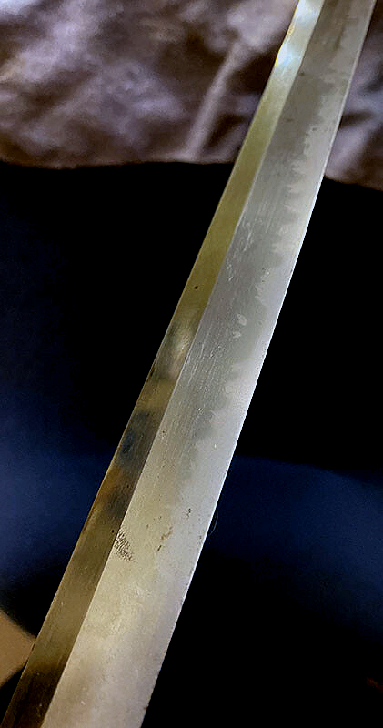

Brian Posted October 6, 2020 Author Report Posted October 6, 2020 Will take more pics tomorrow. Got it under the right light, and the hamon is really popping, plus I can clearly see the hada too. I think the same is real too, just had minimal handling since the end of the war 1 Quote
Stephen Posted October 6, 2020 Report Posted October 6, 2020 With some alcohol or acetone and uchikoing your really going to be happy!! Nice eye on right bits nice pick up !! 2 Quote
vajo Posted October 6, 2020 Report Posted October 6, 2020 Brian don't worry about the same. If it is celluloid that isn't bad. I like that celluloid same very much! Don't get on the wrong side to say its "plastic" 😄 I don't think it was a cheap choose to order with celluloid. 2 Quote
16k Posted October 6, 2020 Report Posted October 6, 2020 Nice find Brian, and congrats! Not surprising about the signature. A guy signing for a whole bunch of others see,s to have been frequent for Showato during wartime. What you have here is probably his real signature on a genuine Gendaito. Once again, congrats for having a good eye! 1 Quote

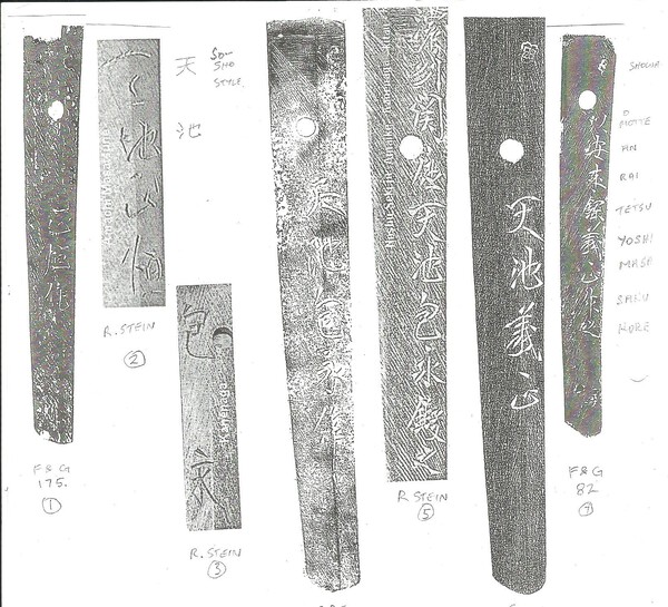

george trotter Posted October 7, 2020 Report Posted October 7, 2020 Brian, looks like you have found an Amachi gendaito. There were 3 brothers?: eldest? Masatsune middle? Kanenaga youngest? or son? Yoshimasa. All made Seki showato and these are seen with nakirishi mei signatures, but I seem to remember reading that all were trained gendaitosho and also made gendaito, or put it this way...I definitely remember seeing each smith's swords with nakirishimei by Seki gunto cutter but ALSO self cut high quality mei...like yours. I had one by in the 1980s (when Steven was a boy) by Kanenaga so did some research (not much). Here is a page of that research with the 3 mei. At least it is a start...I think you will find heaps of info/pics/mei etc with on-line search etc. Oh, edit to add...two of the Amachi swords I had in hand had identical mounts to yours...probably had an "in house" mounter. 8 2 Quote

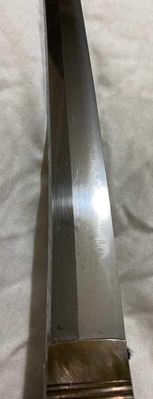

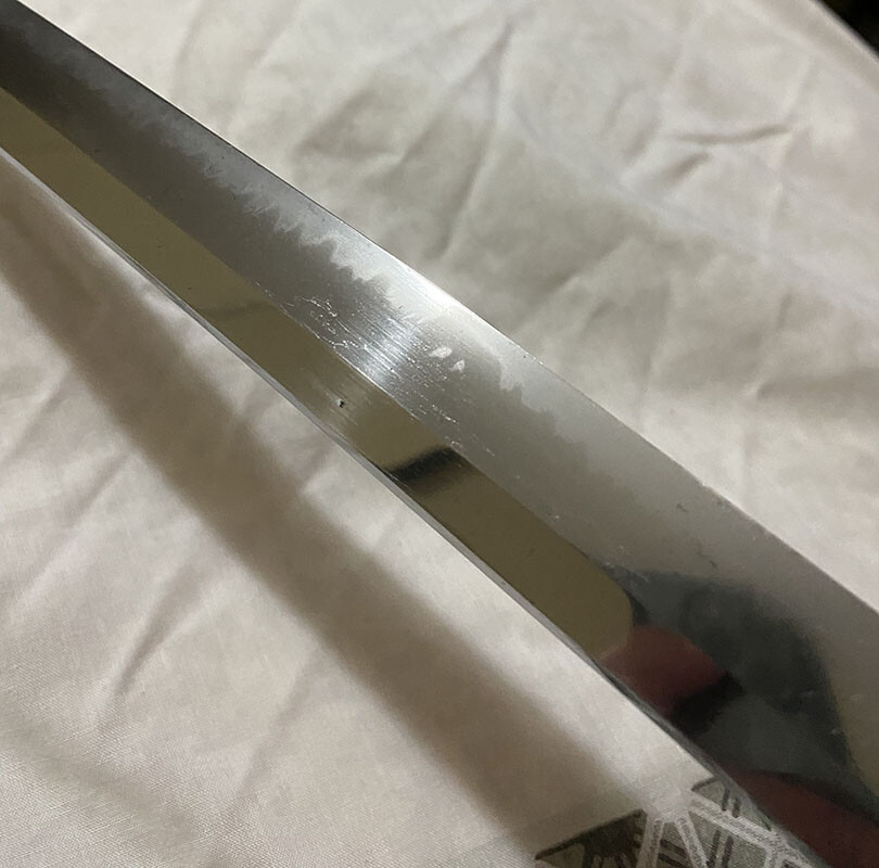

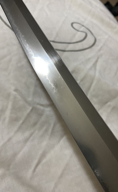

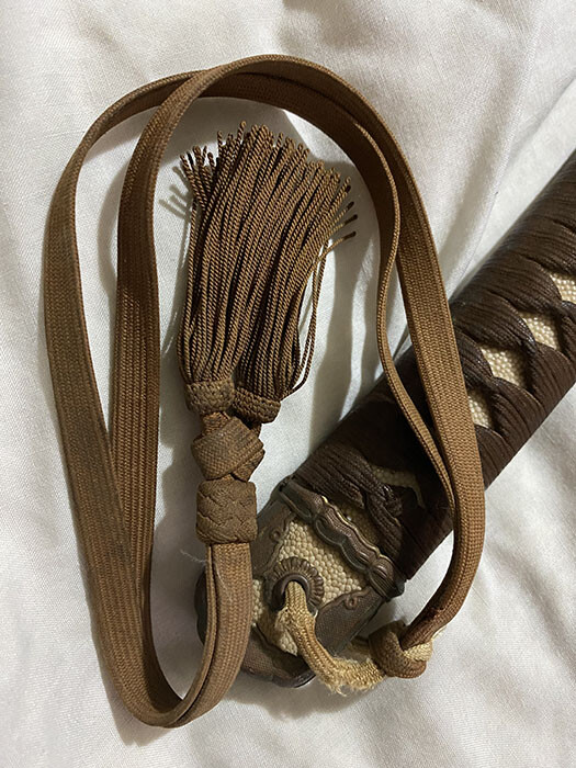

Brian Posted October 7, 2020 Author Report Posted October 7, 2020 Just a few more pics in better light. Also some pics of the tassel and (what looks like a sort of paracord?) sarute for @Bruce Pennington I bet it has been there since the war. Tassel is in great condition. Till the next sword comes along...thanks all. 4 Quote
vajo Posted October 7, 2020 Report Posted October 7, 2020 Gendai-to Brian. That was a real deal. Hamon looks beautifull. Do some stitches into the sarute. It looks like it could crack. I would spare the tassel seperate. Quote
Bruce Pennington Posted October 7, 2020 Report Posted October 7, 2020 Quite a beauty, Brian! The sarute is the standard cloth type. Just faded and worn. Quote
george trotter Posted October 8, 2020 Report Posted October 8, 2020 Very nice Brian! You did a nice job of cleaning....Seems like you removed every bit of "gunk" on it....was it just an alcohol rub-down with paper/cloth, then a drying off with paper/cloth, then a couple of uchikos and wipe-offs with paper/cloth? Turned out very nice. Regards, Quote
