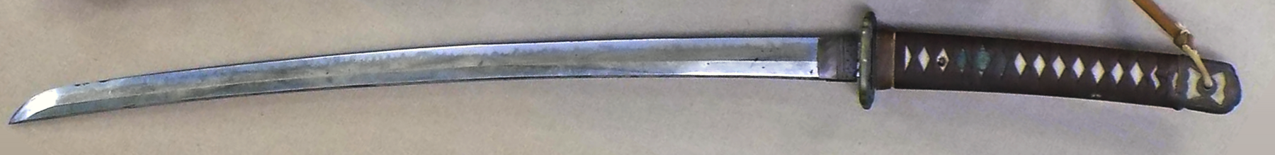

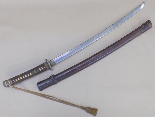

Brian Posted September 29, 2020 Report Posted September 29, 2020 Never buy from eBay without decent pics and full info, and knowing the seller. Or ANY auction without inspecting the goods. Don't gamble with poor pics and hope for a good outcome. Sooo.......I did the complete opposite. I ignored the exact advice we give people and I'll probably pay dearly for it. Got a message from an associate that there was a Japanese sword coming up on auction about 500km away. You can imagine that any Japanese items hardly ever come up for sale in SA. So I took a look at the online auction, and emailed them for better pics of the blade, any damage, and both sides of the tang. With only 2 days to go...I didn't even get a reply. Twice. So with poor pics and only a vague overall shot showing a little damage in the monuchi area...I still went against all advice and while sitting here at work, I managed to win it for a surprising price of of about $860. I have NO idea how I will pay for it...but that is a challenge for tomorrow Anyways, knowing all the pitfalls, and the info above...I thought I'd post the same pics I had, and play a bit of a game to ask you guys who would have taken a chance and what you think the outcome will be. I have NO idea until it gets here...maybe a week? So we will all see how much of a fool I was, and who was closest. Things that attracted me like a siren song are the interesting looking hamon and the slightly better habaki. Showato or Gendaito? Mumei or signed? What smith? Wild guesses are fine. Also...the military guys...can you tell me what tassel that is? Here you go. Again, do not try this at home...I am silly and likely attempting retail therapy for my back issues Click on the pics a few times. They willopen up, then open up larger to your browser's capacity, and then open full size. The entire description was: A good quality, Japanese Army Officer's SWORD in leather covered scabbard, recovered from VJ (Victory of Japan) day in 1945, overall length is 97cm. 1 Quote
paulb Posted September 29, 2020 Report Posted September 29, 2020 Well I think you have got away with it this time. I don't know what you are hoping it will be but assuming it is a showa-to in that condition it does not seem an outrageous amount to pay. On the plus side for it being something better the habaki does as you say look a step above the norm. I am a little concerned by the apparently bright start of the nakago just showing between habaki and tsuba. Shape looks pretty standard Showa. As a guess I would say Gendai-to in reasonably good condition and decent koshirae. Well done (I think) Quote
Brian Posted September 29, 2020 Author Report Posted September 29, 2020 Wild guesses are acceptable. 🙂 My hopes....Gendaito, with nice choji or saka-choji hamon. Maybe Nagamitsu or Emura etc. I don't think it's older than WW2. Showato is acceptable, but I would then flip it for my money back locally. I suspect that gap is because there is no mekugi. I hope. Will make sure of the necessary before it is shipped, maybe get someone to collect in person. One guess so far..thanks Paul Quote
PietroParis Posted September 29, 2020 Report Posted September 29, 2020 I can't be of help with this sword, but I do remember that this strategy worked well for you with those woodblock prints. Maybe you'll be lucky again! 1 Quote

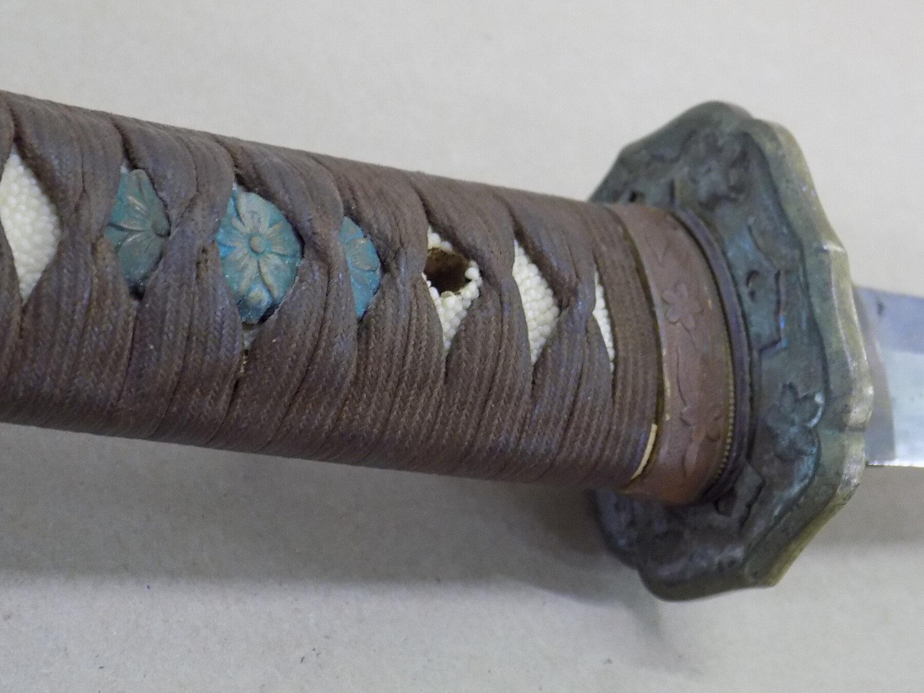

Bruce Pennington Posted September 29, 2020 Report Posted September 29, 2020 The gap could be from missing seppa. Don't see any on the blade-side of the tsuba, but they could be hidden by the angle of the photo. The tassel is quite faded. At first glance it's the all-brown. Reference books like Fuller/Dawson call this a "late-war army tassel", but new info from Nick Komiya points to the Gunzuko. They were authorized to carry army regulation gunto, but were to use the all-brown tassel. It could be a heavily faded Company grade tassel. When you get it, look for hidden blue in the weave. Oh, and I'm curious to see if that "sarute" is a period shoestring or a post-war fix. 1 Quote
16k Posted September 29, 2020 Report Posted September 29, 2020 I think you did all right. I would bet on Showato or the guy didn’t know what he had because the price is right. Now, the only thing that gives me pause: the same. Looks a bit too clean and white for my taste. Add this to the gap, we may conclude (and be wrong! ) that the tsuka might not be original to the blade or a more recent repair. Keep us posted. Quote
Stephen Posted September 29, 2020 Report Posted September 29, 2020 The peg is not all the way in so the tsuka has been off and not put all the way back on hence the gap. Same looks late war plastic. Hamon goes from flat to kochoji Emura or Nagamitsu is good chance the hamon does drop very close to ha so im ruling out mass showato. Cant wait ...lol 1 Quote
16k Posted September 29, 2020 Report Posted September 29, 2020 Yes, celluloid same was my first thought too, but all those I’ve seen so far have become yellowish. This one looks almost new. EDIT: and taking a closer look, I’ll bet water quenched and real same Quote
vajo Posted September 29, 2020 Report Posted September 29, 2020 Could be celluloid same (its not a sign of cheap swords, celluloid is water resistant). First look on the blade i think it is not a showa-to. Brown tassel is company grade from IJN but later in war you find it also on IJA swords. The seppa behind the habaki is missing. The leather seppa looks intact. All over a nice buy for the price. I think you made a good deal. Quote
celt72 Posted September 29, 2020 Report Posted September 29, 2020 If that is celluloid same, cross your fingers and pray that it is a star-stamped Kanehide! 1 Quote
vajo Posted September 29, 2020 Report Posted September 29, 2020 Haha Martin - thats a sharp thought and it looks indeed like a that (miracle bag). But i think Brian will show us what it is. 1 Quote
Stephen Posted September 29, 2020 Report Posted September 29, 2020 Suguha yakidashi might take us to Shinshinto ...out side chance anyway Quote
Surfson Posted September 29, 2020 Report Posted September 29, 2020 The leather battle wrap is possibly a good sign - maybe covering a traditional wood lacquered saya. The same gives me pause as well, as it looks so clean and white. Nothing to add to all of the astute comments you have received so far. I think that you did just fine, even if it is machine made. Quote
Ed Harbulak Posted September 29, 2020 Report Posted September 29, 2020 It looks like a better than average habaki and the hamon looks more complicated that most showato. For $860 it's a good gamble. My guess is that it's an older, probably mumei blade, either later shinto or shinshinto. If it turns out to be signed, then it could be a gendai. In any case, the tassel is worth $100 so I don't think you will loose. But, it sure would have been nice to get more good pictures. 1 Quote
dkirkpatrick Posted September 30, 2020 Report Posted September 30, 2020 I think real same, by the look and the way you see the nodules flake by the mekugi. I love the hamon and the kissaki, definitely forged, steel color feels older than gendaito so I echo Ed’s assessment, no matter I think your absolutely fine at that price, can’t wait to see pictures! Doug Quote
george trotter Posted September 30, 2020 Report Posted September 30, 2020 Yes, I think it looks good....well spotted! Nice shape overall. Blade about 62-64 cm? nice hamon. Can't say if shin-shinto or gendaito, but I'd definitely take a chance on it too Brian. Just a a light clean with alcohol and some oil and I think you will smile. When you find the two missing O-seppa and maybe that it is a Kokuho, I think you will be grinning for a month! Good luck. Quote
Michaelr Posted September 30, 2020 Report Posted September 30, 2020 Brian, I think you did real good and I like the sword. I hope it turns out to be more than you expected. I purchased a run of the mill, so-so condition WW2 sword for just a little less than this just to have around so that I could put it in the hands of anyone that seemed interested in Nihonto so that they could get the feel and hopefully start a passion for the blades and become more interested. So I use mine as a learning, starting tool and am glad that I purchased it. A small amount of money well spent ( at least for me ) Good Luck MikeR 1 Quote
Dave R Posted September 30, 2020 Report Posted September 30, 2020 OK, I'll play. The mounts are typical field mounts for WW2, somewhat patinated, possibly kept out of the light and slightly damp. The Ito is good, but probably tender, I would like a better look at the end knots. It has been taken apart and not reassembled properly. I am looking forward to better pic's of the tsuba and leather tab. The saya cover is one of the "removable" type so it might be a trad' saya underneath, but the kurikata removed. Going by the habaki, the blade was originally in Buke Zukuri mounts, so the blade could be old... or one of those early Showa swords that could be either traditional or Showato. By UK prices you go it at a decent price..... after doing the $-£, conversion, you got it cheap! Quote
16k Posted September 30, 2020 Report Posted September 30, 2020 I guess we’ll all laugh when Brian shows the “made in China” stamp on the nakago! 🤣 Quote
Brian Posted September 30, 2020 Author Report Posted September 30, 2020 Well...don't want to jinx it either. So let's see what the (very possible) pitfalls could be too. They outnumber the good stuff, so this really is an exercise in what not to do. Possible issues: Mumei average blade Showato (I feel unlikely with that hamon, but possible) Nakago either hacked off with a saw, or rust all removed/cleaned Ware/cracks/hagire etc Kazu-uchimono Rust/pitting in spots Fittings/saya not matching to rest of sword etc etc I'll know either way early next week. 2 2 Quote

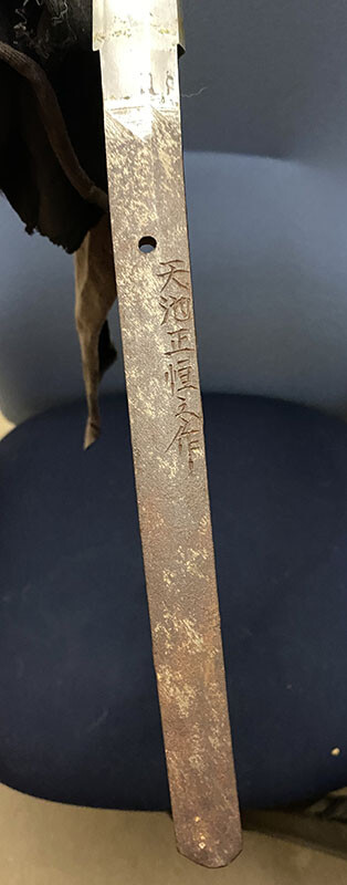

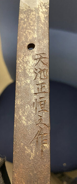

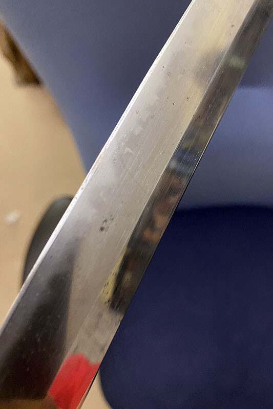

Brian Posted October 6, 2020 Author Report Posted October 6, 2020 Here we go. I waited until after dinner to open it. I am very pleased. It is a lovely sword in very good condition. Koshirae is tight and seems to have all the seppa etc, unlike what the pics showed. In fact, it is so tight on the tsuka that I had to use the wooden block to gently hammer it off. Habaki was also glued with oil. I don't think this has been apart much since the war. It's on its first polish. Ububa/ubuha. I did a bit of Googling, and seems it is signed Amachi Masatsune. Wartime smith. Many I see online are Showato, but this one appears to be a stunning Gendaito. Lovely hamon with plenty of tobiyaki and I can see some hada in the right light. Nagasa only about 623mm....but it has a LONG nakago. 245mm. Odd. The hamon is actually really stunning. Complete, with great boshi. Kissaki doesn't have the damage it appears to have in one pic. No flaws, some light stable rust stains. Nothing major. Needs a good clean and some uchiko. Will leave that for tomorrow. Tassel is nice condition as is the saya and combat cover. Habaki special order and original? Saya wood. But I'm not going to try take off the combat cover. Seen too many of those snaps tear out Will leave that alone. All in all, a very nice Gendaito. Not a masterpiece, but a good sword that I am very, very happy with. Thanks for taking this journey with me guys. Please can you just check my translation and if anyone has anymore info than what Markus has... Quote MASATSUNE (正恒), Shōwa (昭和, 1926-1989), Gifu – “Masatsune” (正恒), real name Amachi Reiichirō (天地鈴市郎, first name also reads Suzuichirō), born. September 23rd 1894, he worked as guntō smith and died May 12th 1949, Fourth Seat at the 6th Shinsaku Nihontō Denrankai (新作日本刀展覧会, 1941) 1 1 Quote
Stephen Posted October 6, 2020 Report Posted October 6, 2020 Well done looking forward to more info on smith. Quote
Stephen Posted October 6, 2020 Report Posted October 6, 2020 like this http://www.sword-auction.jp/en/content/as19436-刀:天池正恒-katana-amachi-masatsune and thats his low end work 1 Quote
Brian Posted October 6, 2020 Author Report Posted October 6, 2020 Saw that and a few others. Cute covered up Seki stamp I am always amazed how these wartime smiths' signatures can vary so wildly. There is no comparison with my mei and some of the others. I guess the "kore saku" also indicates forged. Did they have people signing for them for arsenal swords and maybe sign themselves for Gendaito? Quote
