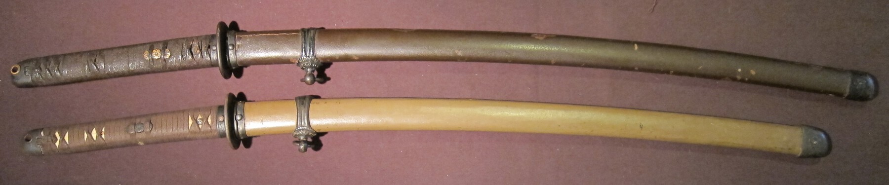

george trotter Posted September 24, 2020 Report Posted September 24, 2020 HI all, Just for fun I thought I'd ask about blade lengths in Rinji mounts. Now, I haven't really been taking notes on this, but GENERALLY speaking, I think I notice that the "government mandated" type rinji made in Seki/Nagoya/Gifu with steel scabbard, tends to have a (government regulation?) short blade c. 62 cm while the private order mounts with lacquered wood scabbard and hilt have longer blades c.64-66 cm. To illustrate this, here are two of my Rinji: 1. Privately made/mounted gendaito blade by Tsukamoto Masakazu (older bro. of Okimasa of Tokyo) with a blade length of 69.5 cm. This is the longest blade I have seen in a rinji mount. 2. Seki Sword Co. made Govt. mandated steel mounts with RJT blade of Nakata Kanehide at 62.5cm. Any comments...examples? (BTW, the long sword is much lighter than the short sword). Regards, 3 Quote

george trotter Posted September 24, 2020 Author Report Posted September 24, 2020 Interesting Bruce, I also do not have a showato Rinji sword so can't comment. My Rinji sets are all gendaito...maybe it would help if I set out the lengths: Remember, that first one by Masakazu is private order Rinji mounts and blade, so I suppose you could order any length you liked? So here the 5 are with dates/lengths - 2 private made blades...3 RJT blades: 4/17 private order rinji mounts, blade, by Masakazu, Fukushima ken = 69.5 cm blade (he became a RJT about this time). 1/19 private order rinji mounts, blade by Seisui, Tokyo (made Shinano ken) = 62.1 cm blade (unknown smith - one-off?) 5/18 private order rinji mounts, blade by Munetoshi Niigata ken RJT star 64.0 cm 5/19 govt mandated steel mounts , blade by Kanehide, Seki/Gifu ken RJT star = 62.5 cm. I should say that from 1941 Kanehide worked for the Seki Sword Co and was an RJT there. Obviously this company received govt. produced "stock standard" rinji mounting parts I have seen several Kanehide star blades in govt. steel mounts (but with 2 buttons). 8/19 private order rinji mounts, blade by Kunihide, Kyoto RJT star = 66.8 cm Not sure this tells us much...be interesting if members told us date, rinji mounts type and maker/length of their swords...maybe nothing, but they seem to be shorter in rinji mounts. Regards, Edit to add...wow Chris...excellent. All within the 62-67 cm range. This seems to fit my list here except for the Masakazu at 69.5...I wonder how many long ones will turn up? I think my 69.5 blade is just because it was private order...I don't think we will see a RJT blade that long? Great stuff. 1 Quote

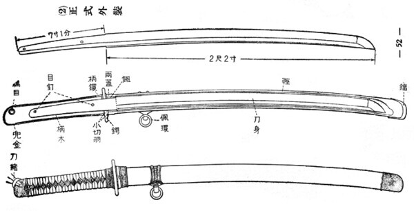

Bruce Pennington Posted September 24, 2020 Report Posted September 24, 2020 I got this from DaveR on one of the "Type 3" threads. If my math is right, isn't it saying that the nagasa is to be 2 saku 2 sun = 66.6 cm? That seems kind of long, doesn't it, and not lining up with real life blades (once we get some actual measurements!)? I must say, though, that often the mil specs didn't always pan out in real life for gunto. Nick Komiya posted a note from Tojo, himself, who stated the RS model should be made of tamahagane! I also find it interesting that the bottom sketch of the fittings seems to have a release button on the koiguchi. 1 Quote
george trotter Posted September 24, 2020 Author Report Posted September 24, 2020 Yes Bruce, you are right...I also have that drawing of "govt. mandated" RS mounts (pub. 1944) and the length given is 66.6 (maybe a maximum?) and it is what prompted me to ask about blade lengths as mine is only 62.5 cm. I also posted that pic above of my RJT Kanehide because it was in identical mounts (originally announced by Tojo in 1941) with 2 buttons. Also...what you say about Tojo saying the RS should be made of tamahagane makes sense as, if you look at any RJT blade in govt. mandated steel scabbard mounts, all RJT I have seen in these mounts have two buttons....but showato do not. My OP was a question about the blade lengths in govt. mandated steel scabbard RS mounts. Except for my RJT Kanehide blade above, we have not had any feedback details on these. I thought lots of NMB members had them? 1 Quote

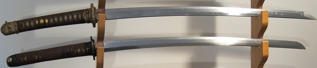

george trotter Posted October 2, 2020 Author Report Posted October 2, 2020 Just on the OP...I know I began this post as a query on the different blade lengths of Seki-made Rinji compared to private-made Rinji, but since we didn't get any responses concerning other Seki-made Rinji blade lengths, I thought I'd ask another question: (this is for your fact list Bruce) here is a pic of my two Munetoshi blades I referred to elsewhere as being different length blades according to their period/mounts...i.e. blades got shorter with the Rinji mounts (I know the picture in the OP shows a Rinji with a 69.5 cm blade, but maybe some feedback on Munetoshi might help us understand better) Details are (top) Type 98 - Yamagami Munetoshi 16/9 - o/n 308 - length 66.0 cm - med/long kissaki (private order). (bottom) RS - Yamagami Munetoshi 18/5 - o/n matsu 1080 - length 64.0 cm - short kissaki (RJT). The Rinji drawing above shows that the blade length should be 66.6 cm, but this one is 64.0 cm. (in fact the Type 98 is 66.0 cm)...so maybe if members send in some dimensions we can see if the Rinji rule was obeyed...or as is usually the case with things Japanese, never say always... 2 Quote

george trotter Posted October 2, 2020 Author Report Posted October 2, 2020 Yes, maybe Bruce means you Chris. You provided good info on your personal collection of Rinji blade lengths (all seem close to the 66.6 cm "rule"), but I thought maybe if we can get some blades by the same makers in both Type 98 and Rinji mounts we can see if a shorter blade "rule" was demanded. What you said earlier about maybe the blades under government control had to fit the government scabbard length but private order, even in Rinji mounts, could be whatever the customer wanted...just don't know how the system worked. Regards, Quote
