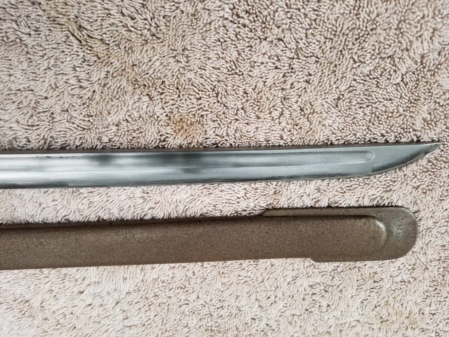

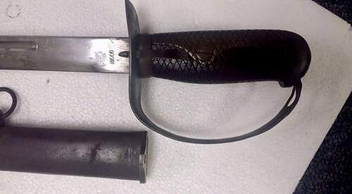

Skrag0 Posted September 21, 2020 Report Posted September 21, 2020 I bought this Type 32 Ko sword as a novice and I've taken more time more to research what the details are. It seems like this is a very strange version if not a fake. Here's what I noticed: 1. A strange serial number, the font is different, it's small, and the numbers are too close. 2. The clasp is a rounded point, not is a wedge shape. 3. There are no additional markings, not on the scabbard or on the guard. 4. No leather washer. 5. The throat has the bolt protruding. 6. The handle is shaped differently, it's more of a tube shape. 7. The fuller starts and ends far away from each end of the blade. 8. The blade doesn't have a clear edge, very dull and round. Is this authentic? It has so many things that I question now, but overall it looks like it could be real, although I have no idea. Quote

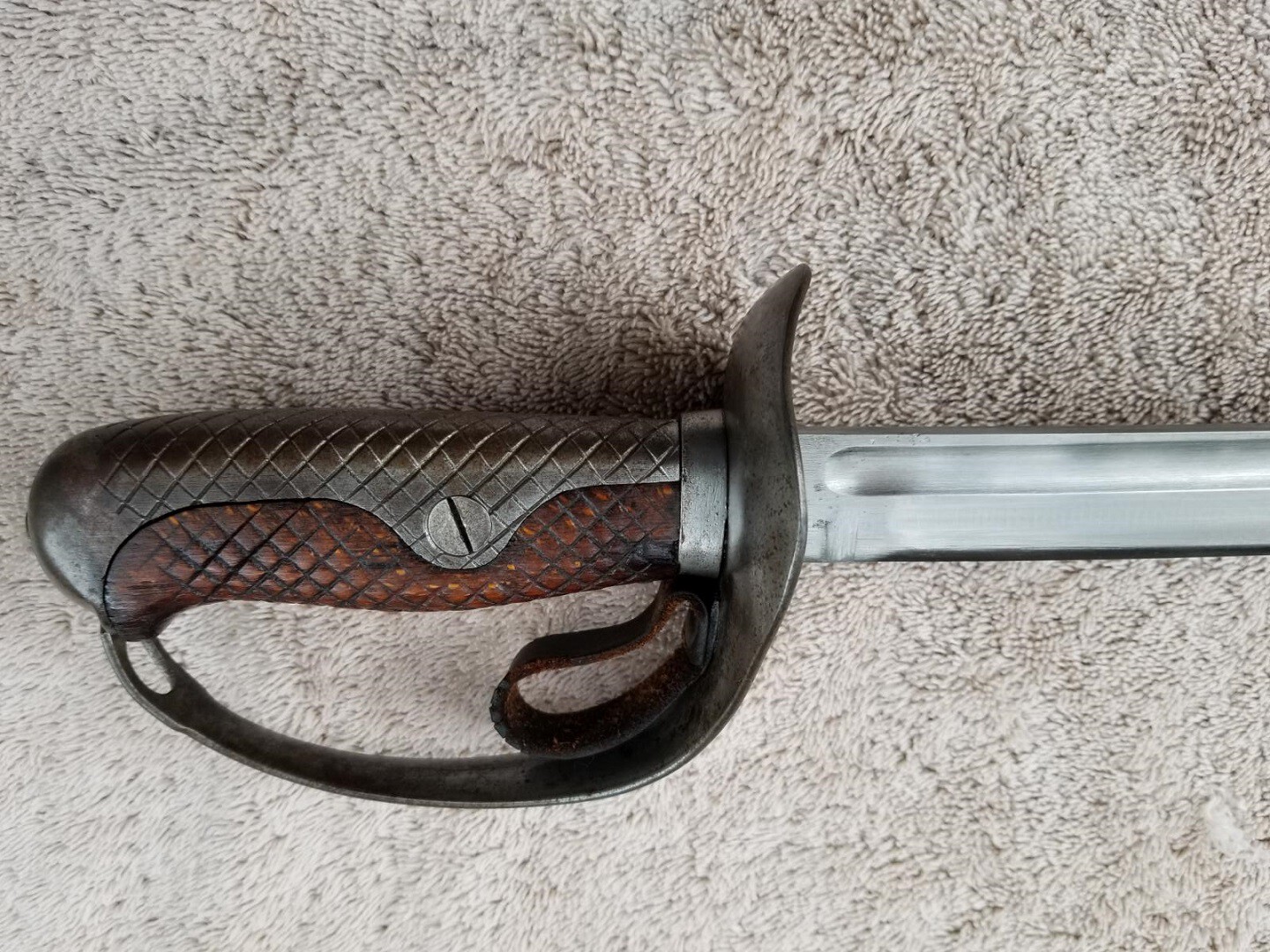

Bruce Pennington Posted September 22, 2020 Report Posted September 22, 2020 Alison, I will say up front, that I don't specialize in these, so someone more knowledgeable may correct me, but I agree with you on all your points. I've looked at the one in Dawson's book, and at my own, and yours differs in all the ways you've mentioned. Additionally, the lip of the handguard doesn't curve out enough, and the spacing on the belt loop is too far down the saya. The drag doesn't look right either. Now, there are always exceptions, but unless someone with knowledge of these chimes in, I'd say it's an imitation. I do recall a recent discussion of the Chinese, producing their own version of the 32, during the war, so maybe that's what you have. Here are some pics of mine for reference: 1 Quote
BANGBANGSAN Posted September 22, 2020 Report Posted September 22, 2020 Alison Your Type 32 looks like a replica. One of my friends got a 4 digit Type 32, it is a little different than the others, shorter blade,lighter in weight, hanger ring in different position,and the blood grove is no the same way. But you can tell from the detail compared to yours, not the same quality, and the style of numbers is different even If his also a replica. 1 1 Quote
Skrag0 Posted September 22, 2020 Author Report Posted September 22, 2020 @Bruce Pennington Thank you! @BANGBANGSAN My sword looks very similar to your friend's sword, albeit a few differences. Have you confirmed your friend's sword a replica? I can't shake the feeling that it feels real when I hold it, it feels solid. But if it's a replica they made it look pretty authentic with rust. Quote
Bruce Pennington Posted September 22, 2020 Report Posted September 22, 2020 Maybe someone with better search skills can find the thread where it was discussed about the Chinese military being authorized to produce their own version of the type 32 during the war. The handles were normally painted green, but I still wonder if this is what we are seeing. 1 Quote

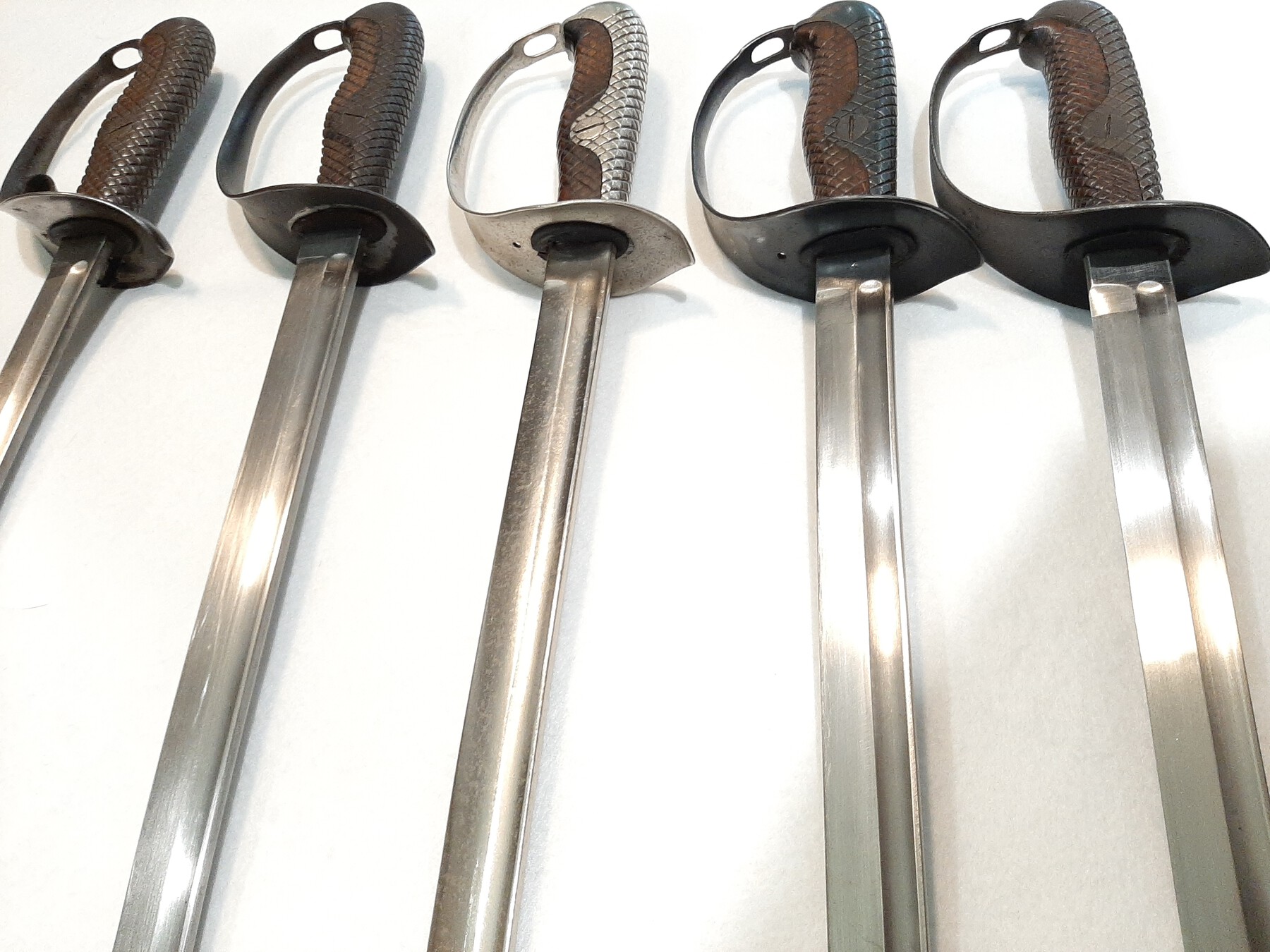

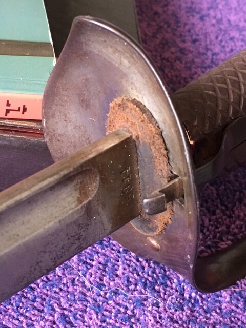

Shamsy Posted September 22, 2020 Report Posted September 22, 2020 You have done an excellent job of already picking the issues! well done, so I put some extra effort in and grabbed some photos for you. I'll comment on what I feel are the more apparent tells of the sword. Now, I'm looking at photos so don't jump on me and savage if it's not easy to tell. The saya throat is not even, the screw is incorrect and it looks crude. The fuller/bohi starts in the wrong place, is the wrong width, depth and design and terminates in the wrong place. There should be stamps on the guard. The serial numbers are in the wrong place; they are always much further towards the hilt, making them hard to photograph. Regarding the other issues... these are tells but not to be solely relied on. The handles can wear and were hand carved I believe, so there is some variation. Serial numbers come in a range of fonts Washers are sometimes missing, it's old leather after all. Blade sharpness varies, not sure that's a huge give away. Grabbed 3 Ko and 2 Otsu to demonstrate. They are all pretty consistent. Damn I'd forgotten my love affair with Type 32s. Oops, reached upload limit... ah well, that's all you get then! 2 Quote

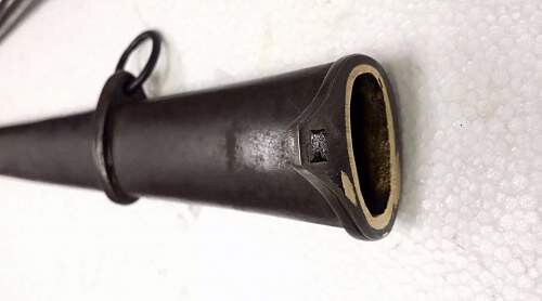

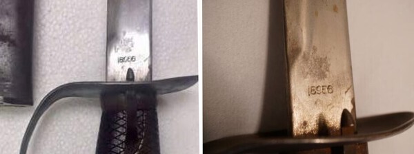

Bruce Pennington Posted October 8, 2020 Report Posted October 8, 2020 Well, the plot thickens. A guy over at Warrelics just bought a similar 32 ($195), and is waiting for it to arrive, but he's posted pics: https://www.warrelics.eu/forum/Japanese-militaria/type-32-sword-cosmoline-776160/#post2112925. It's not the first one, in cosmoline, but the second one at the bottom of the thread. I'm adding the pics here. Something I noticed on his is the saya throat. It's clearly made of brass, then coated/painted/blued with something to make it look like steel with a brass insert. Why would a legit sword-maker artificially make the throat to look like an insert? Seems more like something a faker would do. The handle work is really good and looks actually aged. The blade has the same problems with the ricasso and bo-hi. The numbers are a good distance apart. I mention that because on 95s the fakers seem to keep using the same numbers over and over. So, either these numbers are far apart because they really were on a real production line, or the faker was just smart enough to care about that. It has the same pointed latch tip, and squared latch receptacle on the throat Quote
Shamsy Posted October 8, 2020 Report Posted October 8, 2020 Just looks like another fake to me Bruce, with a few touches to try and make it look older. All the same issues as the first. I don't think there's anything of interest here I'm afraid, no new discoveries (except that people are still buying swords without any research or effort prior to purchase). Quote
