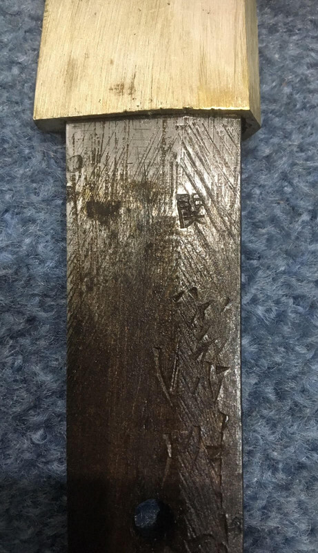

NinjaBear Posted September 19, 2020 Report Posted September 19, 2020 I am as new as it gets when it comes to my knowledge of these military swords. I work for a pawn shop and I purchased this sword. I was told it was a Naval Kai Gunto. I believe its a Chounsai Emura. It does have a wide kissaki which, if what I read is correct, was a style that Emura used. the Tsuba and its parts all have matching serial numbers "499" Any info I can get would be much appreciated. This stuff is so fascinating. Here is a link to the gallery if needed. https://imgur.com/a/PhJUZvY Quote

Bruce Pennington Posted September 19, 2020 Report Posted September 19, 2020 Officially a Type 97 Navy Officer sword, or Kai-gunto. The smith, shown in Dave's reference, is Masahiro. Brian's link will show you the origin of this style of blade, heavy, shorter, more mass in the tip for greater impact. Designed to kill with one blow. I have one too, and they are impressive in the unexpected weight for a shorter blade. The six characters down the left side should be the name of the togishi, or polisher. I can't read them, so maybe someone will for you. The material under the ito (handle-wrap) seems to be sharkskin and the covering on the saya (scabbard) might be polished sharkskin. I have a saya like that and have been told that if you look closely at the white dots, they have small points indicating shark, whereas the eel-skin has round dots. But I'm no expert on the skins. Both, though, indicate a paid-for upgrade from standard navy fittings. Nice find! 1 Quote

SteveM Posted September 19, 2020 Report Posted September 19, 2020 Polisher is 伊藤六助 - Itō Rokusuke 1 1 Quote
NinjaBear Posted September 19, 2020 Author Report Posted September 19, 2020 On 9/19/2020 at 3:09 PM, PNSSHOGUN said: Yes it is a Kai Gunto but not made by Emura, it is a Takayama-To. I'm not sure of the exact translation but that is the type of sword. These were made from Stainless steel so they are not traditionally made. There is a fair bit of info out there about these swords, this example also has a fairly rare retention cord present. Expand Interesting. So the sword Style is a Takatyama-To? But the sword smith himself is unknown. Im to understand the engraving is the name of the polisher? I also thought the retention cord was maybe someone trying to replace a lost one. It didnt look like any photos I saw. On 9/19/2020 at 9:56 PM, SteveM said: Polisher is 伊藤六助 - Itō Rokusuke Expand Is this entirely what it says or only partially? I cant seem to remove this screenshot for some reason. Quote
SteveM Posted September 19, 2020 Report Posted September 19, 2020 謹作高山刀 Kinsaku Takayama-tō (Diligently made Takayama sword) 刀匠 服部正廣 Tōshō Hattori Masahiro (Smith: Hattori Masahiro) 研師 伊藤六助 Kenshi - Itō Rokusuke (Polisher: Ito Rokusuke) Its nearly identical to the signature that Dave posted, except for the polisher. 2 Quote
NinjaBear Posted September 19, 2020 Author Report Posted September 19, 2020 On 9/19/2020 at 10:19 PM, SteveM said: 謹作高山刀 Kinsaku Takayama-tō (Diligently made Takayama sword) 刀匠 服部正廣 Tōshō Hattori Masahiro (Smith: Hattori Masahiro) 研師 伊藤六助 Kenshi - Itō Rokusuke (Polisher: Ito Rokusuke) Its nearly identical to the signature that Dave posted, except for the polisher. Expand OH! Thank you so much! Quote

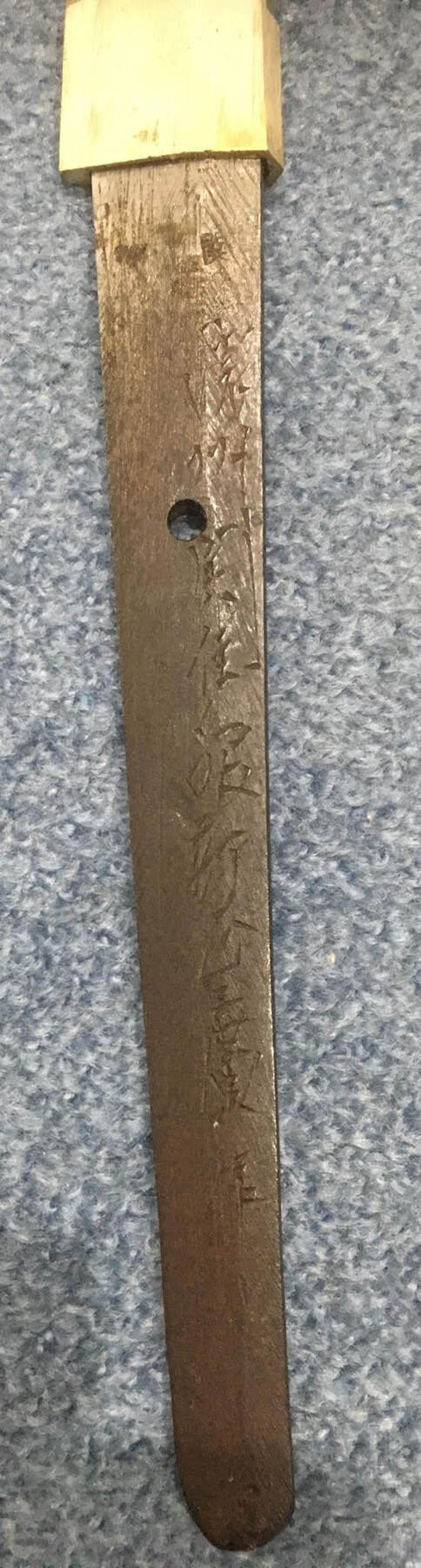

IJASWORDS Posted September 25, 2020 Report Posted September 25, 2020 This subject piqued my interest in my Hattori Masahiro to see if it was signed the same (been years since I looked). Photos attached. Up market Kai Gunto fittings, Seki stamp, not made of stainless steel, no date. Think it owes me 1200 bucks. 2 Quote

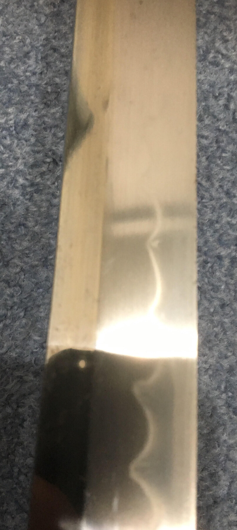

NinjaBear Posted October 2, 2020 Author Report Posted October 2, 2020 On 9/27/2020 at 7:13 AM, PNSSHOGUN said: They were all issued with tassels, however carrying them without a tassel is certainly possible as I'm sure some officers found them annoying or got in the way in the field. One of the more famous instances of this is General Kuribayashi removing all insignia ranks from his uniform, including his tassel, before leading the final charge on Iwo Jima. Expand Oh wow, this is really cool! Thanks for sharing! I wish there was a way to tell the difference. On 9/25/2020 at 8:22 AM, IJASWORDS said: This subject piqued my interest in my Hattori Masahiro to see if it was signed the same (been years since I looked). Photos attached. Up market Kai Gunto fittings, Seki stamp, not made of stainless steel, no date. Think it owes me 1200 bucks. Expand The Hamon on this is very different from mine. It leads me to think that they werent made by the same person. If I read right, Hattori Masahiro didnt personally make the swords, sometimes prisoners would sign his name? Or something to that extent. Quote
