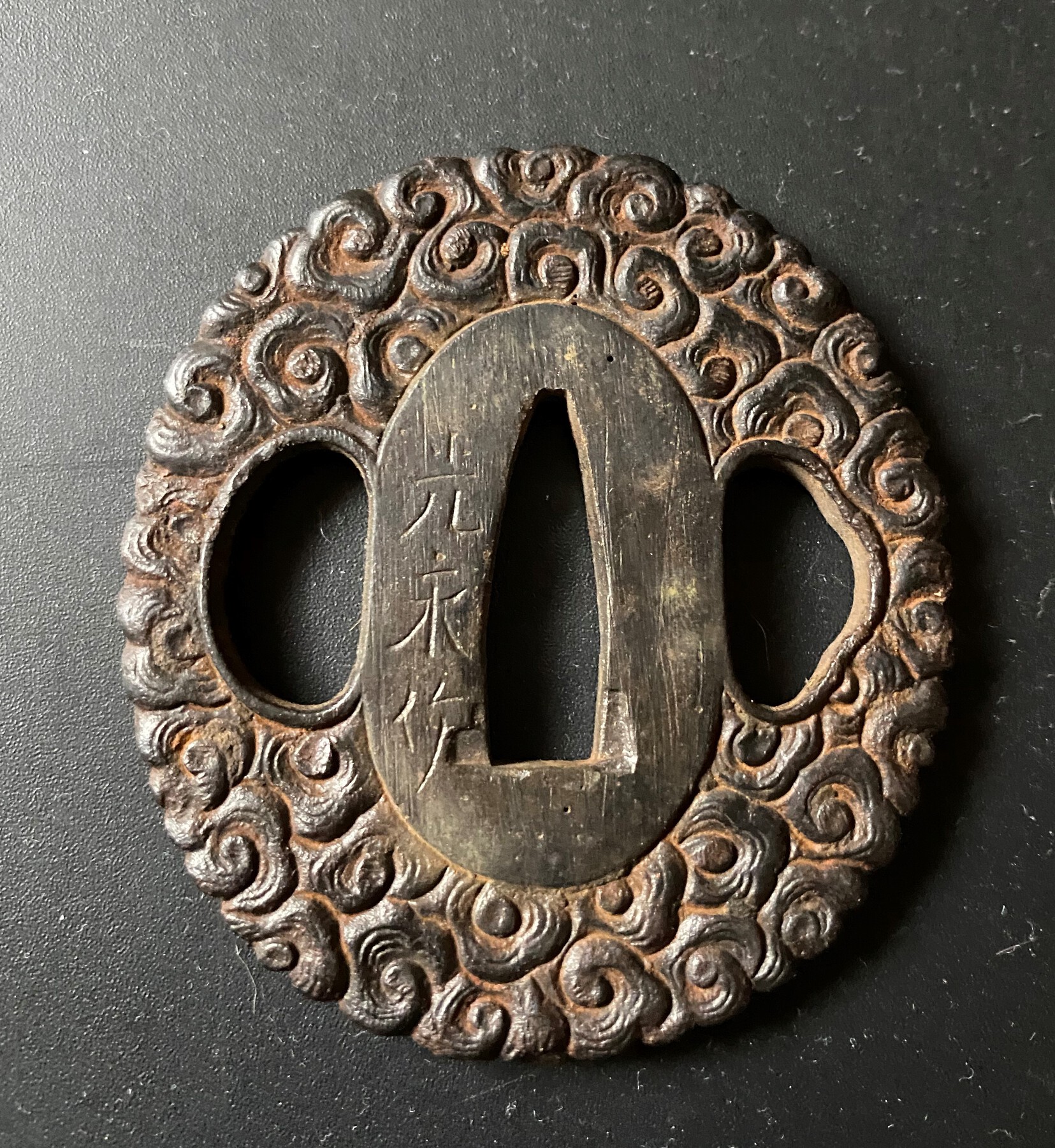

Bruce it's a nice tsuba.
but, as I'm sure your aware the inclusions if air forming small surface bubbles and the lack of any real definition or detail seems to make it appear to be cast.
So the mei could be genuine in that it's possible it's carved but it isn't indicative of any real quality.
I may be wrong and I'm sorry if I am but it looks cast then hand finished to me.
Regards Adam
It's Kanji Bruce for sure.
Mitsu X Saku.
X= I'm not at home to check this Kanji.
Ah that's a bitsa sword I believe. Nice Samegawa and raiden?? Saya.
Cast tsuba, showa WWII tsuka.
All Cobbled  together?
Quite like the saya.

Probably a similar one presented in this thread
Bruno,
So MITSUNAGA SAKU.  Does this mean it's Japanese made?  But maybe for souvenir? Or by Mitusnaga for real purposes?  Sorry for the rookie-style questions, but I don't know the tsuba world.
Tsuba looks OK to me Bruce but I'm not an expert. Can't say if the kanji are cut or cast. To test if tsuba is cast, hold tsuba lightly (horizontal) with your first finger and thumb on the nakago hole and 'flick' the edge of the tsuba with your other hand. If there is a fine ring it is forged, if a dull thud, it is cast...then nothing is legit.
Let us know,
1 hour ago, george trotter said:
........ To test if tsuba is cast, hold tsuba lightly (horizontal) with your first finger and thumb on the nakago hole and 'flick' the edge of the tsuba with your other hand. If there is a fine ring it is forged, if a dull thud, it is cast....
Let us know,
This why bells are cast. (irony off). This test does not work. It is mainly the form of a metal object that makes it ring (or not).
OK thanks. Yes a good point.
Over the years I have done this test on a lot of tsuba that I KNOW are either forged and cast and the resulting 'ring' or 'thud' was consistent with this.
Of course there may always be "variations"...which I can't explain....it is always up to the member to use or not use this test.
