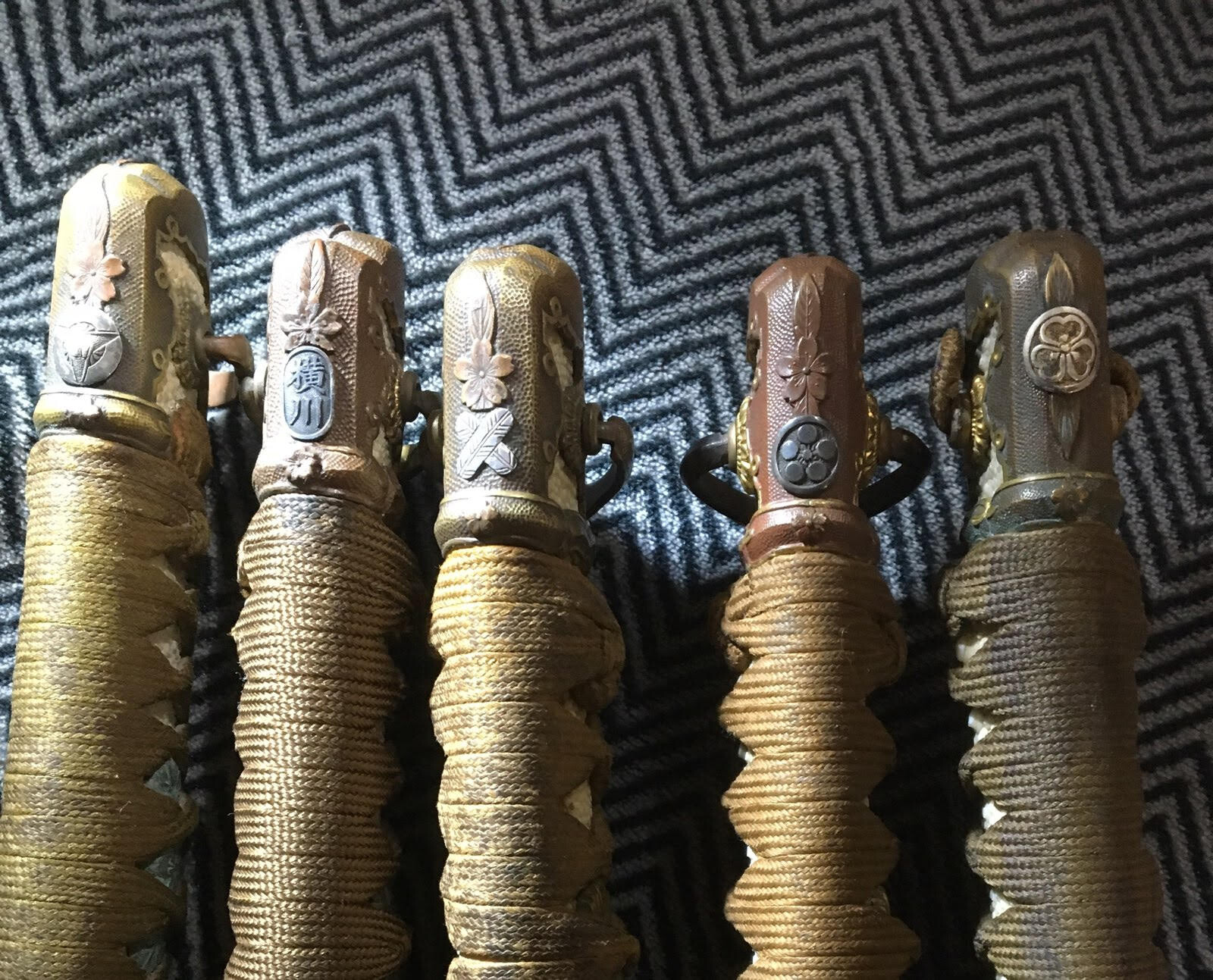

PNSSHOGUN Posted September 13, 2020 Report Posted September 13, 2020 Thought it may be of interest to see how Mon are distributed among different types of swords, I know it will be difficult to ascertain any reliable data but I'm sure there will be a trend or something interesting discovered(?). I would have attempted to collect data from the Identify our Mon thread but many examples don't have the types of blade listed. Obviously this can be skewed by the nature of how everyone collects but please indulge me for now. One thing I have come to recognize is they are most regularly found on Shin Gunto of all types with old blades, followed by Gendaito, quite rarely on Kai Gunto and very rarely on Showato. An observation on swords from Yasukuni & Minatogawa Jinja is that they rarely seem to carry Mon, however that could very well be a matter of smaller sample size and this was based off swords listed for sale over the years. For simplicity Showato can encompass all non traditional blades such as Koa Isshin Mantetsu, Zohei-To & Murata-To, special steel swords, stainless and any bearing the usual Seki/Showa stamps. So please, if you like, list your swords with Mon here as such. Of mine: Old blades: 6 (two are only Koshirae) Gendaito: 2 (one a Yasukuni) Kai Gunto: 0 Showato: 0 Kyu Gunto: 0 4 1 Quote

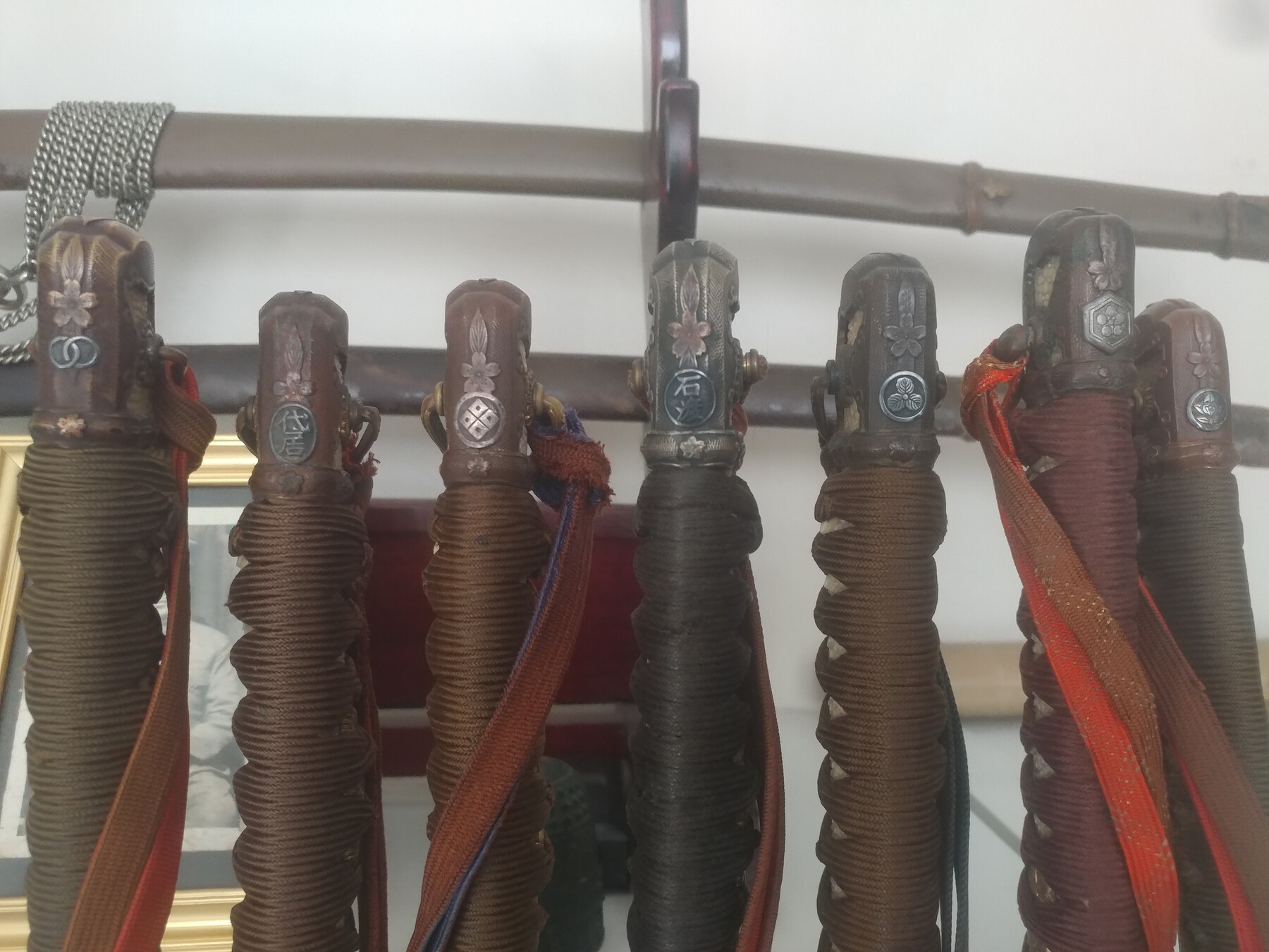

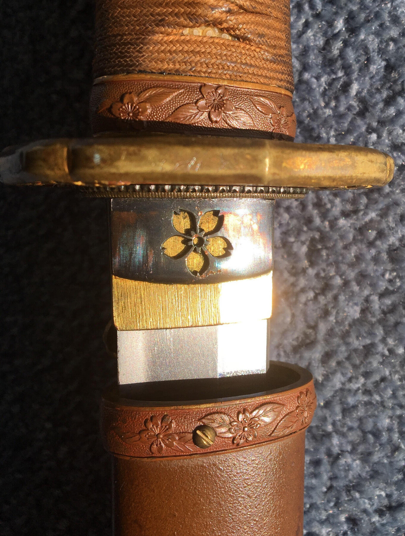

m4l700 Posted September 13, 2020 Report Posted September 13, 2020 Hi John, Interesting indeed! I have only one Gunto(98) with a mon and it is a showa seki blade! Atleast on the higher end of the Showa scale I think. You might have seen it before but i'll post it anyway Oh, sorry for the photo spam 🙃 2 Quote
PNSSHOGUN Posted September 13, 2020 Author Report Posted September 13, 2020 What a fine example David, mounted in very good quality Type 94 or early Type 98 mounts as well, is it dated? Quote
IJASWORDS Posted September 13, 2020 Report Posted September 13, 2020 Mostly old blades, a Yasukuni, and Gendai. Will dig out more later. 2 2 Quote

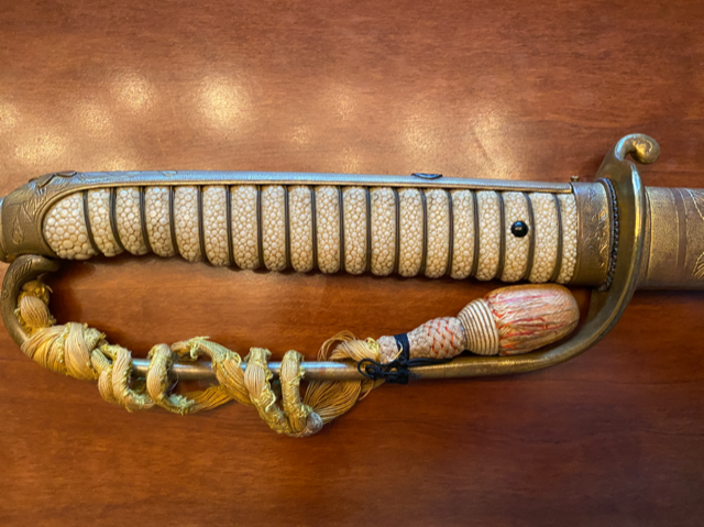

Bruce Pennington Posted September 13, 2020 Report Posted September 13, 2020 On a kyu for sale by Randall: HERE Quote

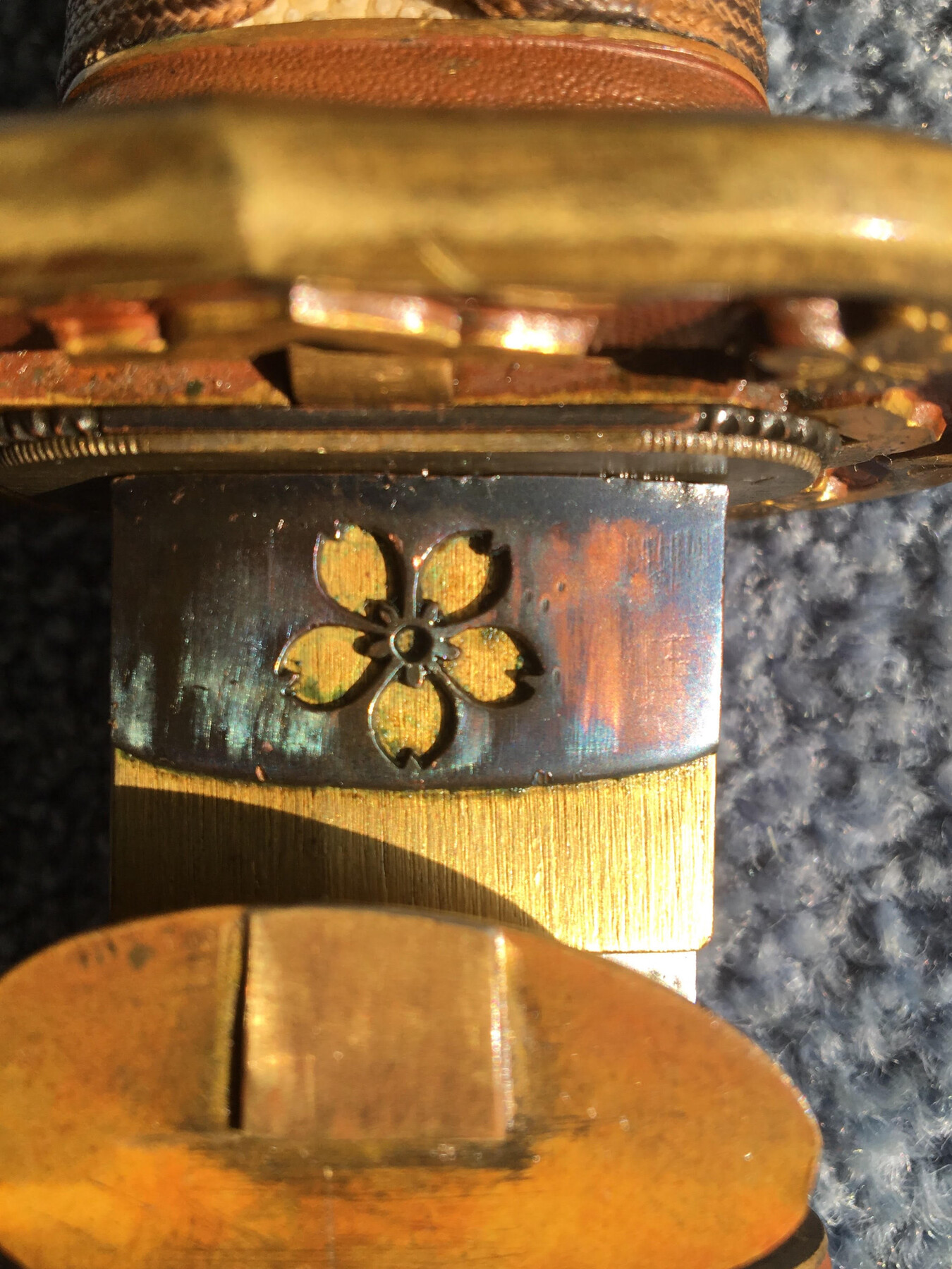

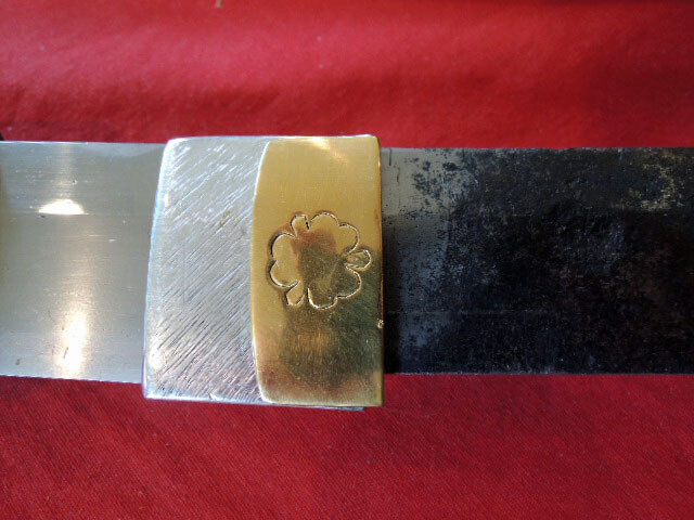

IJASWORDS Posted September 15, 2020 Report Posted September 15, 2020 Habaki Mon. On both sides. 2 1 Quote
Bruce Pennington Posted September 15, 2020 Report Posted September 15, 2020 8 hours ago, IJASWORDS said: Habaki Mon. On both sides. Did you say what kind of blade this is with? Quote

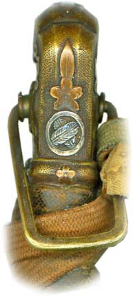

JAL Posted September 15, 2020 Report Posted September 15, 2020 Hi all, Mon on my Naval kyu gunto. Maru ni katabami crest I believe. The kyu gunto contains a papered dated Eiroku 5 Bizen no kuni ju osafune Tadamitsu blade. Best regards, John L. 2 Quote

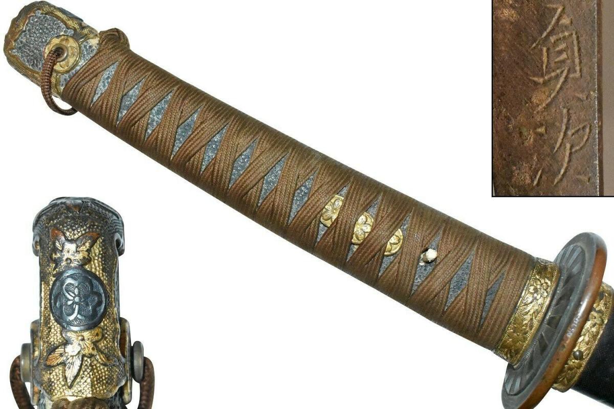

IJASWORDS Posted October 15, 2020 Report Posted October 15, 2020 Don't know if this has been put up. 2 Quote
Bruce Pennington Posted October 15, 2020 Report Posted October 15, 2020 1 hour ago, IJASWORDS said: Don't know if this has been put up Neil, For George's survey - is the blade showato or gendaito? Also, I don't recall ever seeing a mon on a Rinji-seishiki model before. Seems like this was asked about in an older thread, but I don't recall if there have been examples. Quote
IJASWORDS Posted October 15, 2020 Report Posted October 15, 2020 Thought that would throw you. It's on a '98, no date, no stamps, mumei. Don't know if it's old or early war. 1 Quote

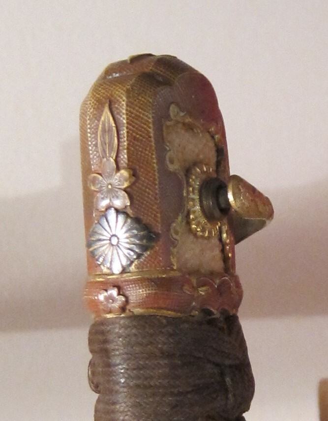

PNSSHOGUN Posted October 15, 2020 Author Report Posted October 15, 2020 Kiri Mon from the looks of it, some kind of Imperial connection, if memory serves me right the number of leaves above hold some significance. I bet it was owned by a higher rank officer, did it come with an original tassel by any chance? As for the blade maybe one of us could give you some details if we can see the Nakago. Quote

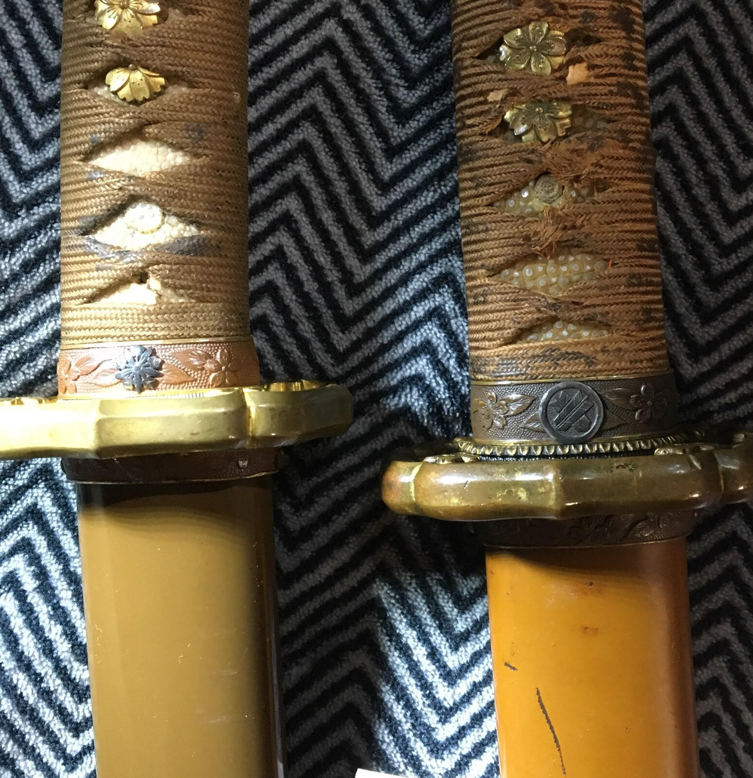

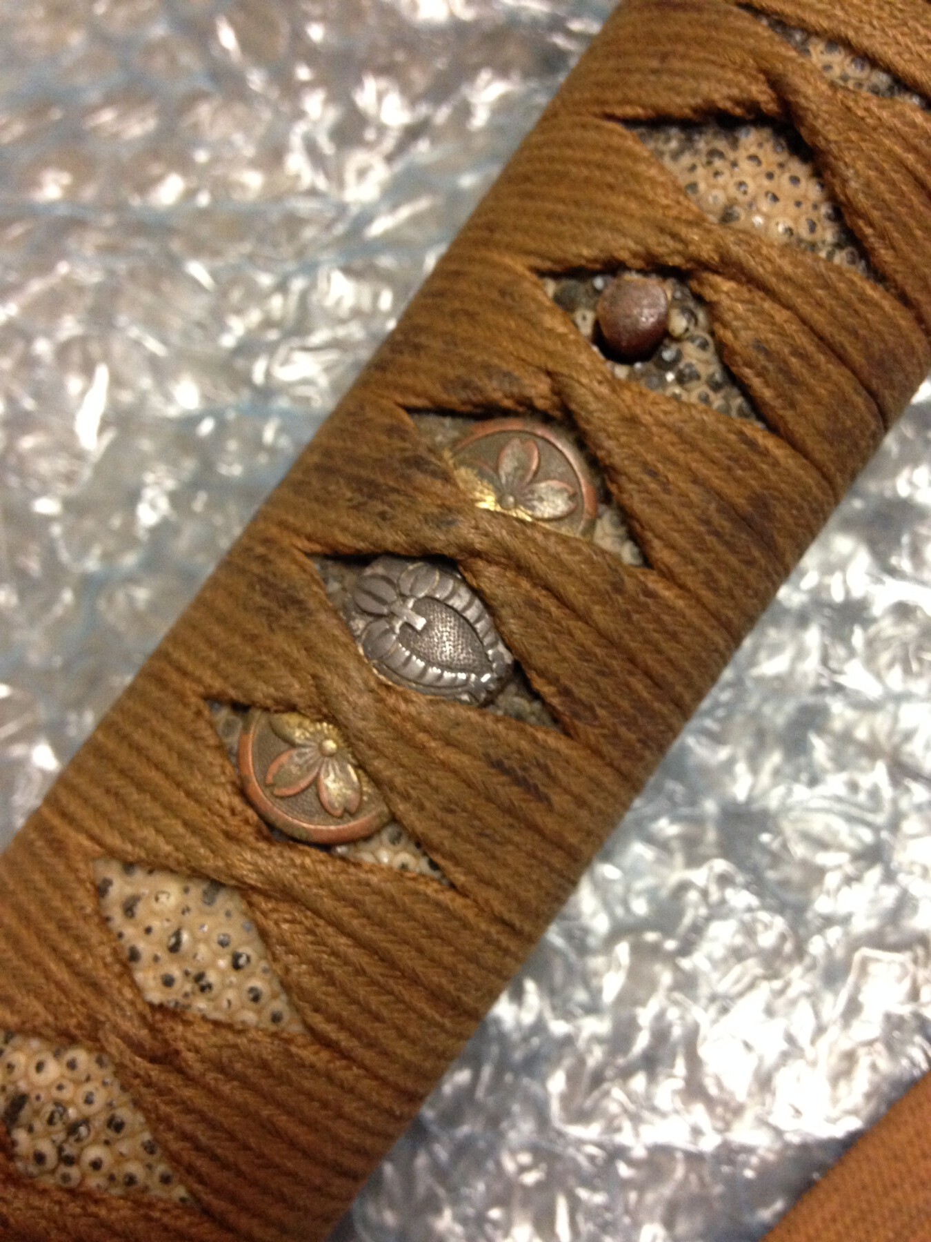

drb 1643 Posted October 15, 2020 Report Posted October 15, 2020 Here you go Bruce, mon on a Rinji-seishiki. Tom 1 1 Quote
PNSSHOGUN Posted October 15, 2020 Author Report Posted October 15, 2020 Knew someone had to have one! Is there a nice blade inside? Quote
drb 1643 Posted October 15, 2020 Report Posted October 15, 2020 Yes, John, there is a nice star stamped gendaito by Kaneshige. 1944 Tom Quote
