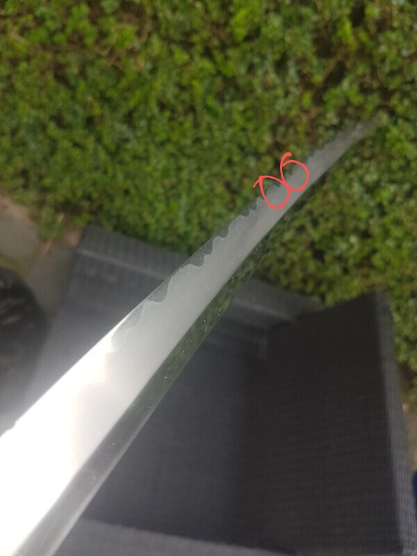

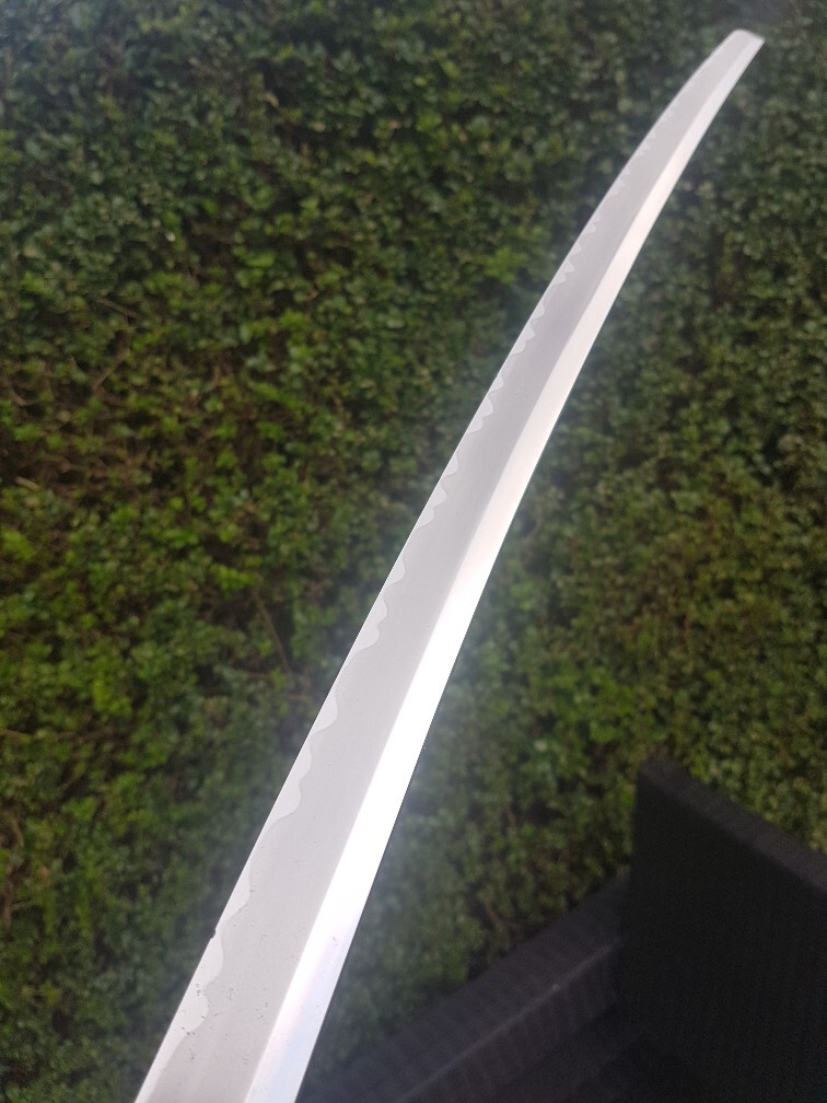

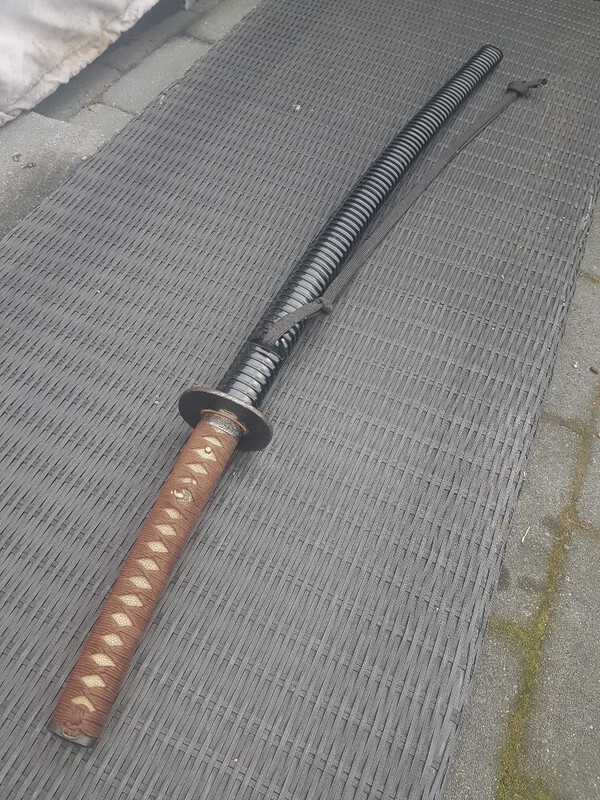

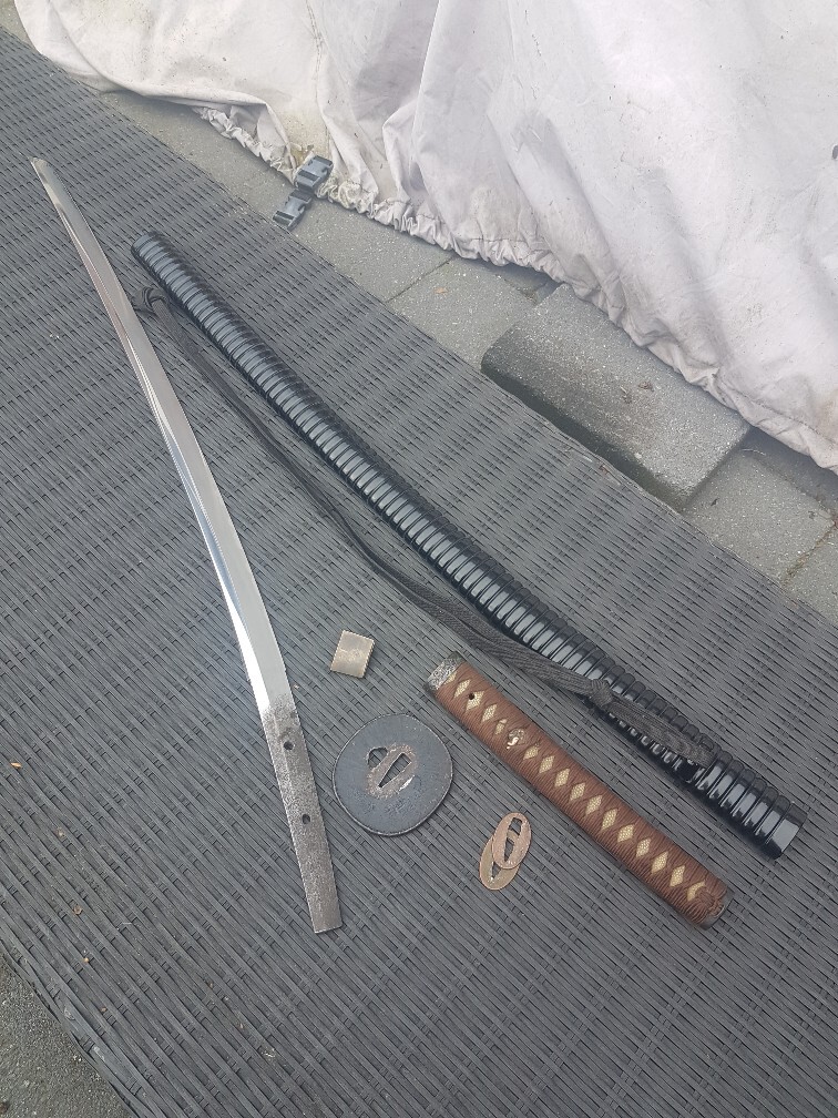

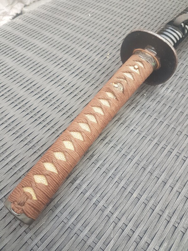

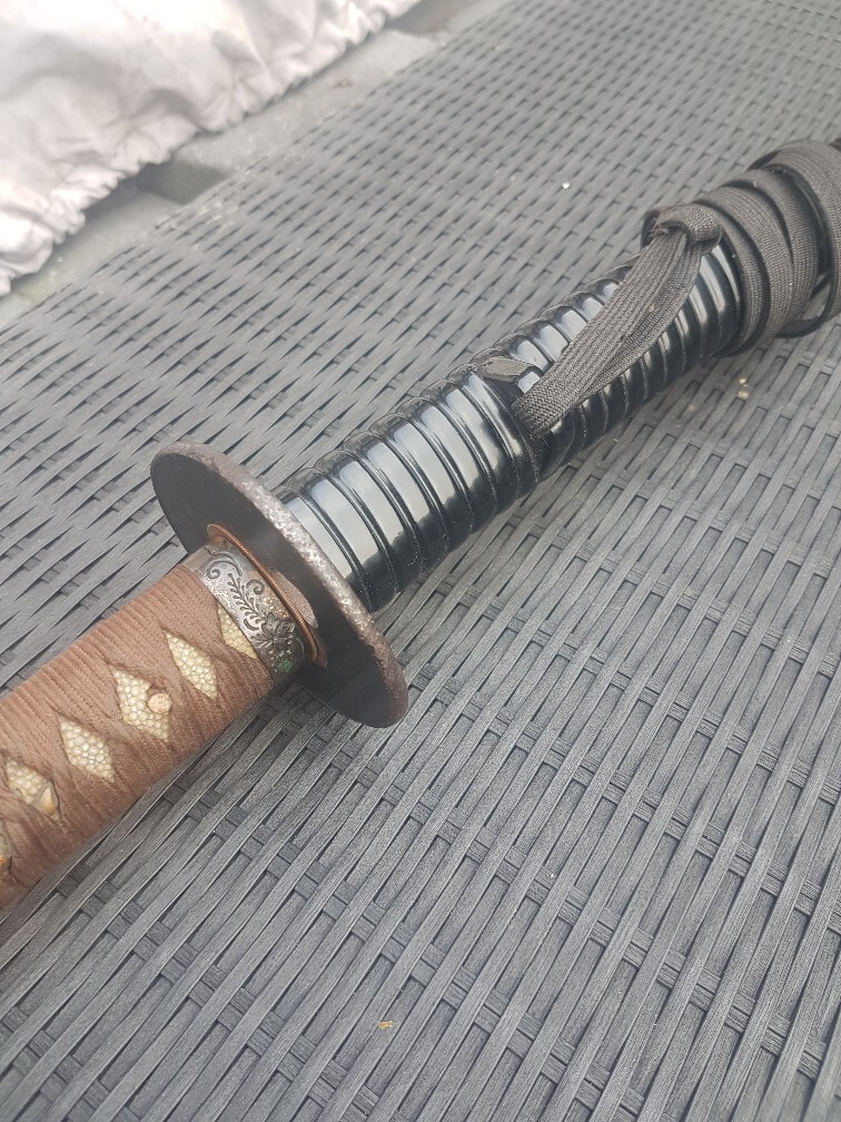

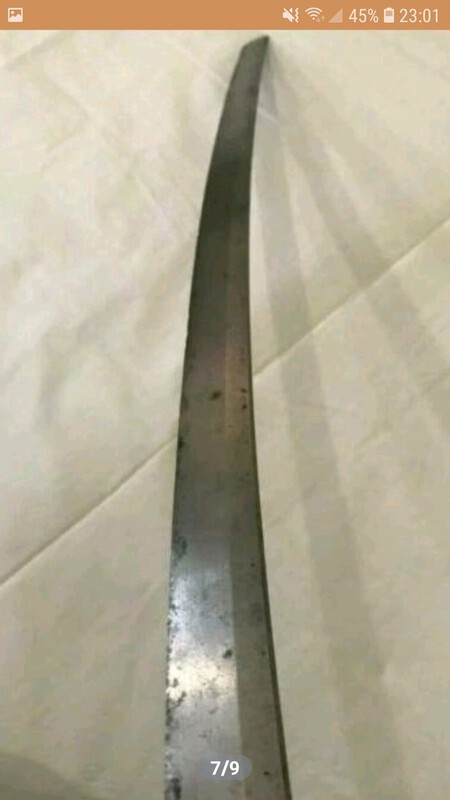

Geoffry Persoon Posted September 9, 2020 Report Posted September 9, 2020 Hello my name is Geoffry from Holland. I have bought this old signed blade years ago. It had some bends and it had lost a lot of steel at the cutting edge. I had noticed that it was signed on the side as they usually signed tachi swords. So i asked my friend to gave it a nice polish. And i have remounted it in a antique koshirae. So now i like to know who made the sword. So please help me out with this one. The blade is in total 83,5 cm long. I have uploaded two pictures of the blade before polishing. Best regards Geoffry. Quote

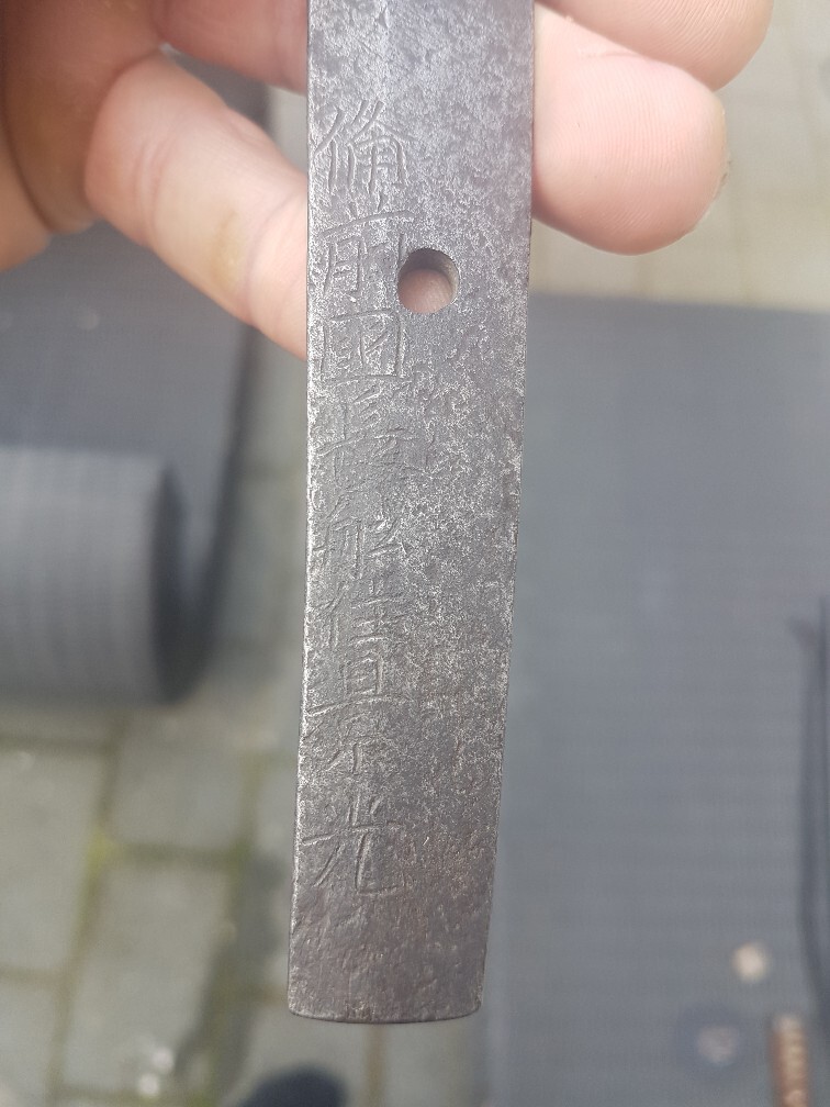

Geoffry Persoon Posted September 9, 2020 Author Report Posted September 9, 2020 Sorry but i can only upload 6.84 mb and that is just one picture guys. So i have only post the tang of the sword. Cheers Quote
Brian Posted September 9, 2020 Report Posted September 9, 2020 Geoffry, 6.8Mb is insane for one picture. You aren't publishing a billboard. I edited your post and reuploaded the pic, which displays the same at 270kb Please edit your pics. If you don't know how, there are plenty of free online image resizers if you Google. Quote

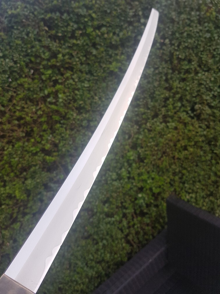

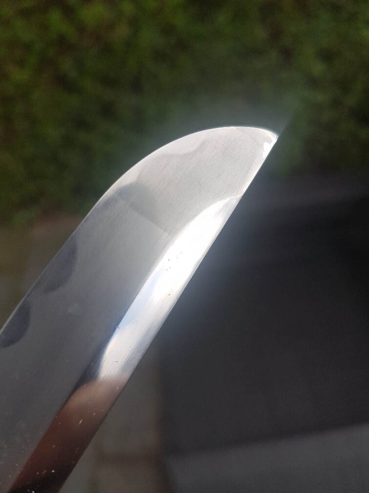

Geoffry Persoon Posted September 9, 2020 Author Report Posted September 9, 2020 I know it is an amateur polish sir. But it looks a lot better then how it was before sir. 1 1 Quote
Geoffry Persoon Posted September 9, 2020 Author Report Posted September 9, 2020 And it has to be finished with hazuya and jizuya finger stones sir. Quote

Babu Posted September 9, 2020 Report Posted September 9, 2020 Hamon runs off at the kissaki by the looks of it and in a few other places along the ha. If you look closely you will see this. These are classed as fatal flaws. The kissaki sustained damage and was reshaped .sadly in doing so your polisher has destroyed the blade. (If it was him) Sorry... no really happy ending here. 1 Quote
Grey Doffin Posted September 9, 2020 Report Posted September 9, 2020 Hi Geoffry, What Christian said is so true. You have saved money on a polish and done serious damage to the sword and significantly reduced its value. Your friend has no business polishing Japanese swords; he doesn't have proper training. You said it looks a lot better than how it was before. When I look at your before picture I see a fine old blade with real potential. When I look at the pictures after polish I see a mess that may not be repairable. Grey 1 Quote
Geoffry Persoon Posted September 9, 2020 Author Report Posted September 9, 2020 Trust me guys the kissaki was in this form allready. There wasn't almost any hamon in the kissaki sir. And the blade is not reshaped at all sir. My friend took out some very tiny chips sir but the ones that were to big they were left in the cutting edge sir. And you can all have some comment on my friend because of the polishing but it is not possible only to judge from the pictures. If you had seen the blade in your hands and had seen it in realtime then you would believed me sir. Greets Quote
Brian Posted September 9, 2020 Report Posted September 9, 2020 Geoffry, If you spent time on this forum, you'll know that amateur polishing is forbidden completely here. No matter what the circumstances. Please drop that subject now, as it is not negotiable, and rather discuss the sword. Btw, your friend doesn't know what niku means. Although polite, no need to call any of us sir, as we are all equal here 1 1 Quote
Jussi Ekholm Posted September 9, 2020 Report Posted September 9, 2020 The signature seems to me to be 備前国長船住景光 - Bizen kuni Osafune jū Kagemitsu, unfortunately I believe signature to be gimei (forged signature). Quote
Babu Posted September 9, 2020 Report Posted September 9, 2020 I forgot to add sir. The jihada is darker the hamon is milky. Your polisher has it the wrong way around. The kissaki may have sustained historical damages, but the hamon runs off so the sword now ,to a collector, is valueless. I am sorry I hope you learn from this. It may have been salvaged by a top togoshi or it may not,we will never know . I've just had a sword returned to me by an amateur polisher and I now see everything that the good people on here were telling me but I could not hear. I lost the money in my own poor polish in the UK and will now send it off to a professional to get it done properly . Gents in way of an apology my hitatsura tachi came back looking buffed and soul less and it wasn't even out of polish by much when I sent it off. I am astonished at the lack of skill and the front to still take my money. UK collectors ,You have been warned! 1 Quote
