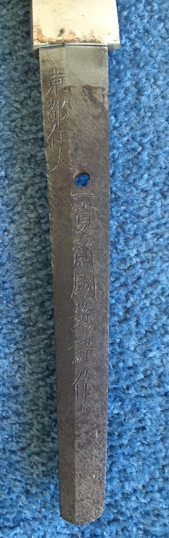

Hello.  I am new to this forum. I posted, in the Military Sword section of the forum, some pictures of a sword. In case this is the more appropriate place to post a request for assistance with the translation of the inscription of the sword, I am also posting here. Thank you for any assistance!
4 minutes ago, Bruce Pennington said:
Tōto-Jūnin Ikkansai Kunimori Kinsaku
Struggling with the first part - is it "Resident of Tokyo"?  Then "Ikkansai Kanimori carefully made this"?
Thanks!
Hi Bruce:
I did a search on this forum using "Kunimori". It came up with a topic started on July 23, 2018 titled "Help With Miyaguchi/ikkansai Kunimori Please". In July of this year someone posted the attached picture of the tang of another sword.  The inscriptions appear to be the same as the tang picture that I posted, don't you agree? I went ahead and posted the sword pictures on this older topic as it seems that there is an interest in knowing more about Kunimori. I am told that the steel is not tamahagane and that these types of swords were not made in the traditional method and were produced during WWII. I have also been told that these swords are valued from 3K to 5K, which I found somewhat surprising. I thought they would be about 1/2 that amount.
Steve
Yes, it is the same inscription
東都住人一貫齊國護謹作
東都住人 -  Tōto jūnin  (Resident of Eastern Capital: aka Tōkyō)
一貫齊 -  Ikkansai  (this is an "art name", a sort of pen name that the artist adopts. In Japanese its called a "gō". )
國護     -  Kunimori  (this is the artists name. Actually it is an adopted name, often different from the artists birth/given name).
謹作    -   Kinsaku (made diligently)
