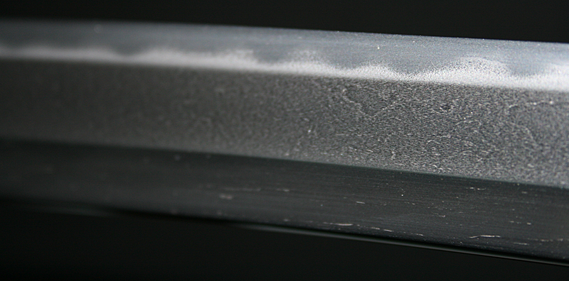

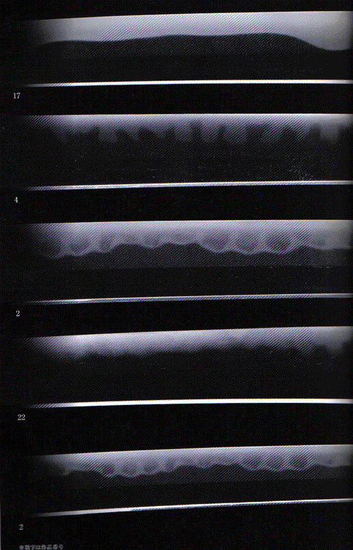

Hi John, I have been researching this for you. At the exhibition I didn't notice the boshi being particularly weak. They seemed well defined to me being mostly ko-maru and a medium kaeri turnback. As to Rai copies, I have difficulty differentiating Rai from Soshu and what I would say showed Soshu influence may indeed be Rai. I'm not educated in this aspect enough to make that call. Some had yakidashi and some koshiba. No swords show that pea-like thing you mention, but, one had a small protuberance that may be what you mean, that came directly nfrom the hamon. I assume you mean the knobs that Nagayama (or his translators) calls 'fushi'. Actually I think this may be a typo and should be called 'hushi' or 'notto'. I include a pic of some of the typical hamon of Nosada. Also a pic of your sword that shows what looks like quite open grain where-as Nosada had a quite tight ko-mokume or ko-itame (I always have trouble wih these two terms). Ko-nie very apparent there, good. John

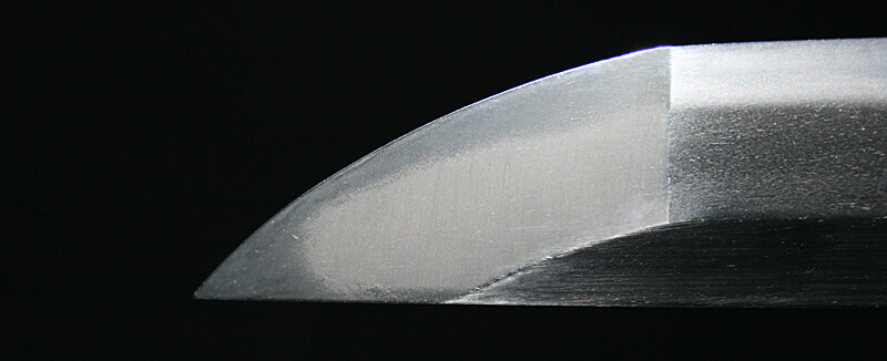

Here are some pics of the blade i have... there is some indications that it could be Nosada Rai, or perhap Sue Tegai... any help/ comments appreciated.
Please note the boshi... is this similar to the Nosada rai boshi, or has this been reshaped?

Tanobe sensei mentioned that in Kanesada's Rai copies the boshi is not as strong and leans slightly to one side. Rai blades have a rather symmetrical boshi.
