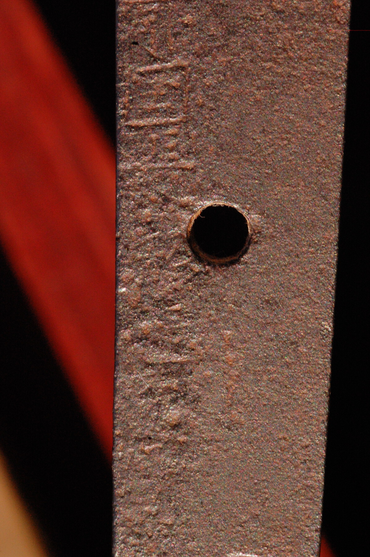

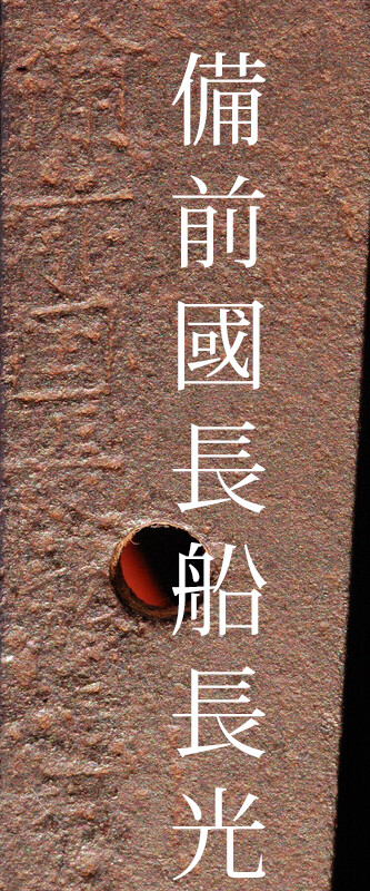

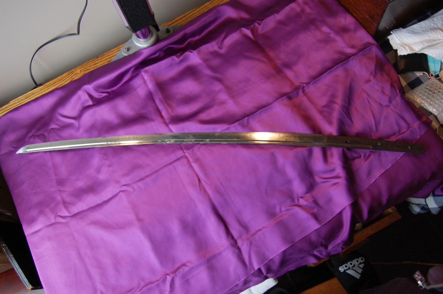

Surfson Posted September 4, 2020 Report Posted September 4, 2020 Hi All. I wasn't sure whether this post should go in the translations section or here. I chose here because it is more an issue of being able to stare at the tea leaves and discern what is written rather than read kanji. This blade is over 27", is koshi sori, has a ko kissaki, has four holes in the tang, has what appears to be an early Bizen style hamon and what resembles a san saku boshi. I will work on getting some photos of the rest of the sword for later. For the time being, I am having trouble reading the last two characters of the mei due to the presence of rust. I have worked on it a bit with ivory and it is better than it was. I am posting some photos here. They are large, and I think that I can only post two per posting (at least by dragging them), so I have used three posting pages. I have seen some of you (for example Ray Singer!) display amazing ability to look at the remnants of a mei and come up with a very likely fit. I can clearly see that the first kanji are Bizen Kuni Osafune....followed by XX: 備前国長船 The usage of Bizen rather than Bishu is a clue, as is the usage of the kuni with this certain style. I have looked through the Bizen taikan and am getting swept away with hopes and dreams, so I thought I would put it out there for some fun. Clearly the last two kanji, which comprise the name, are the most important, part of the puzzle. Any and all suggestions are welcomed. Quote

Shugyosha Posted September 4, 2020 Report Posted September 4, 2020 Bizen Kuni Osafune (maybe) can’t make it out At all beyond that. 1 Quote

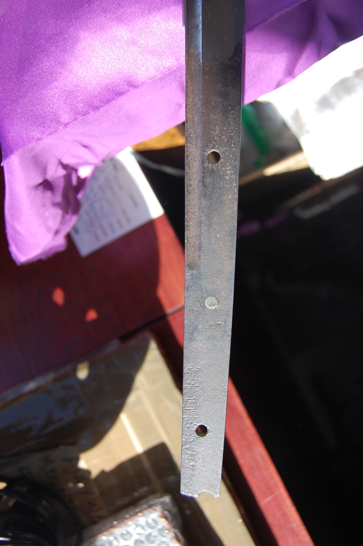

Surfson Posted September 4, 2020 Author Report Posted September 4, 2020 Me neither John! Here are a couple more photos. Quote
Surfson Posted September 4, 2020 Author Report Posted September 4, 2020 Funny Ray, that was my best guess too, but I worried that it was too hopeful. The signatures of Nagamitsu that I found seemed to have a different kuni character. This one looks to me like this style 国 rather than this style 國, but I guess it is a little hard to tell. My plan is to send it to Japan for polish and papers. Would you paper it first if it were yours? Quote
Ray Singer Posted September 4, 2020 Report Posted September 4, 2020 If current visibility allows for it, I always recommend having it put through shinsa or Tanobe's evaluation first. Quote
Surfson Posted September 5, 2020 Author Report Posted September 5, 2020 It has some spider rust but otherwise the visibility is good. I will try to take some photos, but my sword photography is far from good. I suppose that if it happened to get a gimei call (which I sincerely doubt that it would), I would resubmit it. If it got a second one, I guess I would have two choices - either have the mei removed and resubmit (which would break my heart since I think that the signature was made during Kamakura) or just keep it and enjoy it. The big question would be whether to invest in a polish in that case. I am open to any other readings or interpretations! Quote

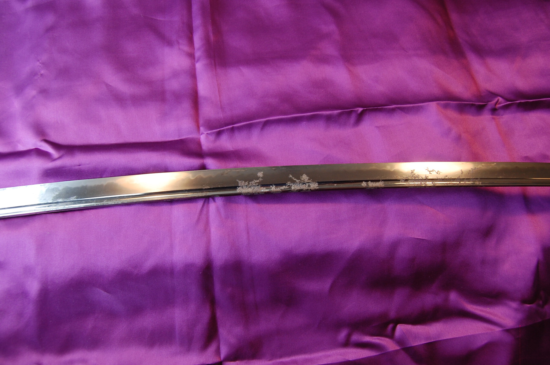

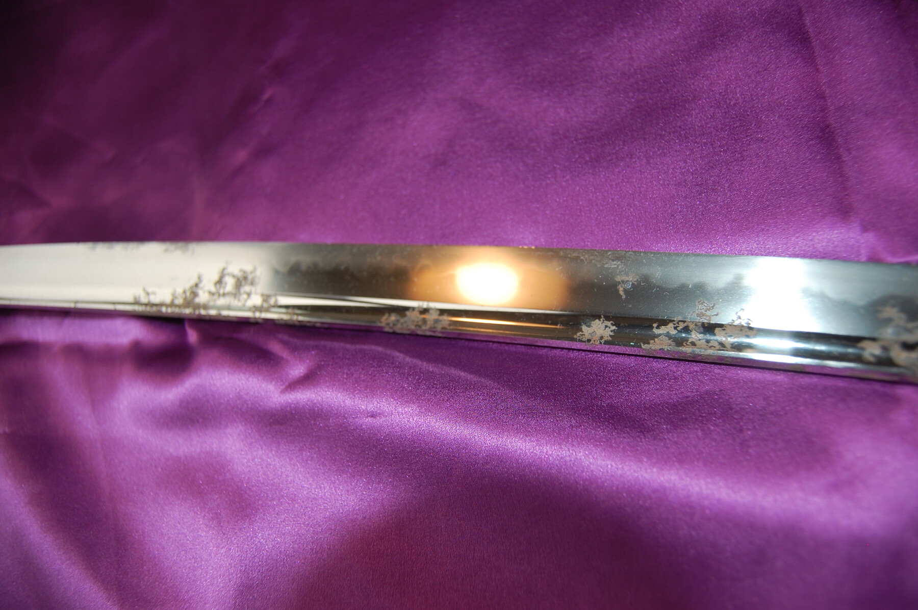

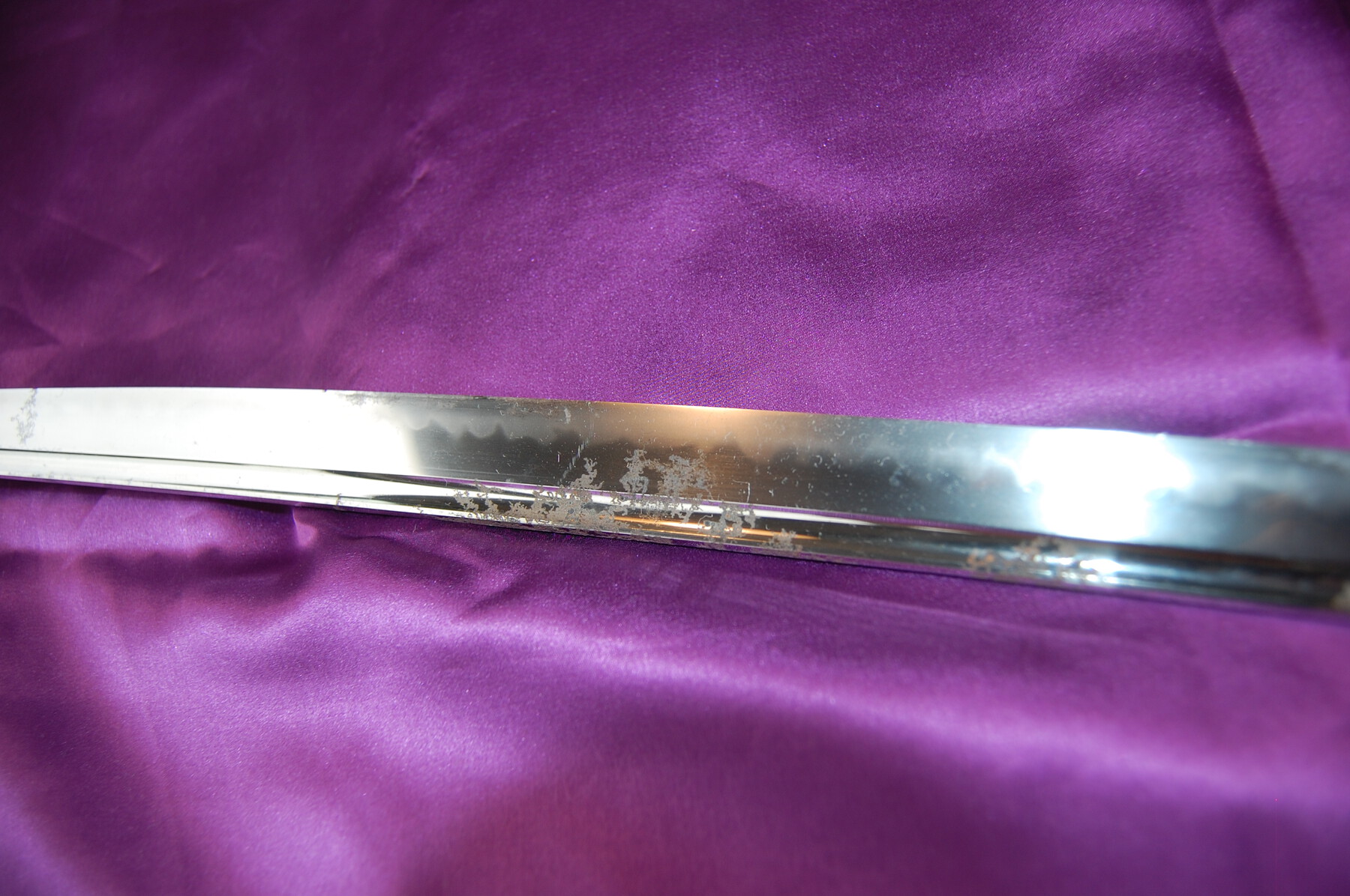

Surfson Posted September 6, 2020 Author Report Posted September 6, 2020 Jussi et al., here is my pathetic first attempt to take some photos. The shame is that I had Kirill visit and show me how he does it with his equipment. I just don't have the equipment, technical knowledge or, dare I say, willingness to work that hard. So it is with great humility that I share these photos with you in the hopes that you can get some idea what the shape and hamon look like. I must say that these really don't capture the amazing nioiguchi, the hataraki or the other subtle features of the hamon. Also completely missing from these, except in a few small areas, is the utsuri that the blade has. I expect that a good polish will make the utsuri quite amazing. I did my best to capture the boshi, but oh well. I will post more in a subsequent message, since they are big. Quote

Ken-Hawaii Posted September 7, 2020 Report Posted September 7, 2020 Looks like it has some decent bones, Bob, but it could sure use a little loving. Too bad its former caretaker didn't spend a few cents on choji oil. Quote
Surfson Posted September 7, 2020 Author Report Posted September 7, 2020 I agree Ken. At least there is no pitting rust, at least by my judgement. It will definitely be going to Japan for some serious love and affection! Quote
Brian Posted September 7, 2020 Report Posted September 7, 2020 Love the sword and think it has big potential. Nothing there that looks overly concerning for a decent polisher. Love to see the result. 1 Quote
Tom Darling Posted September 9, 2020 Report Posted September 9, 2020 Robert, It should have a strong (visible) midare utsuri in the tight skin Ji , which is the hallmark of the early Bizen school. You have very nice tachi. Tom D. Quote
