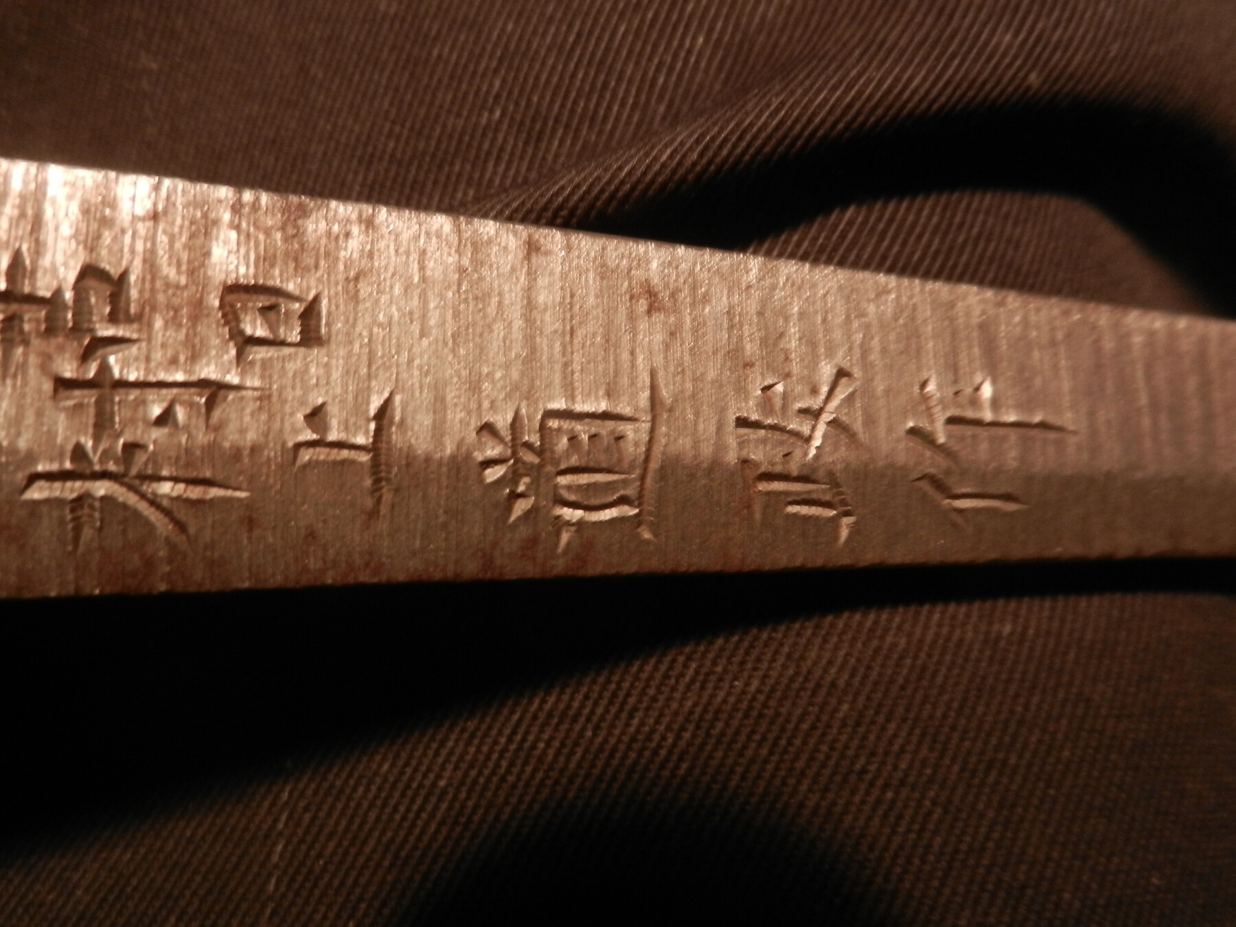

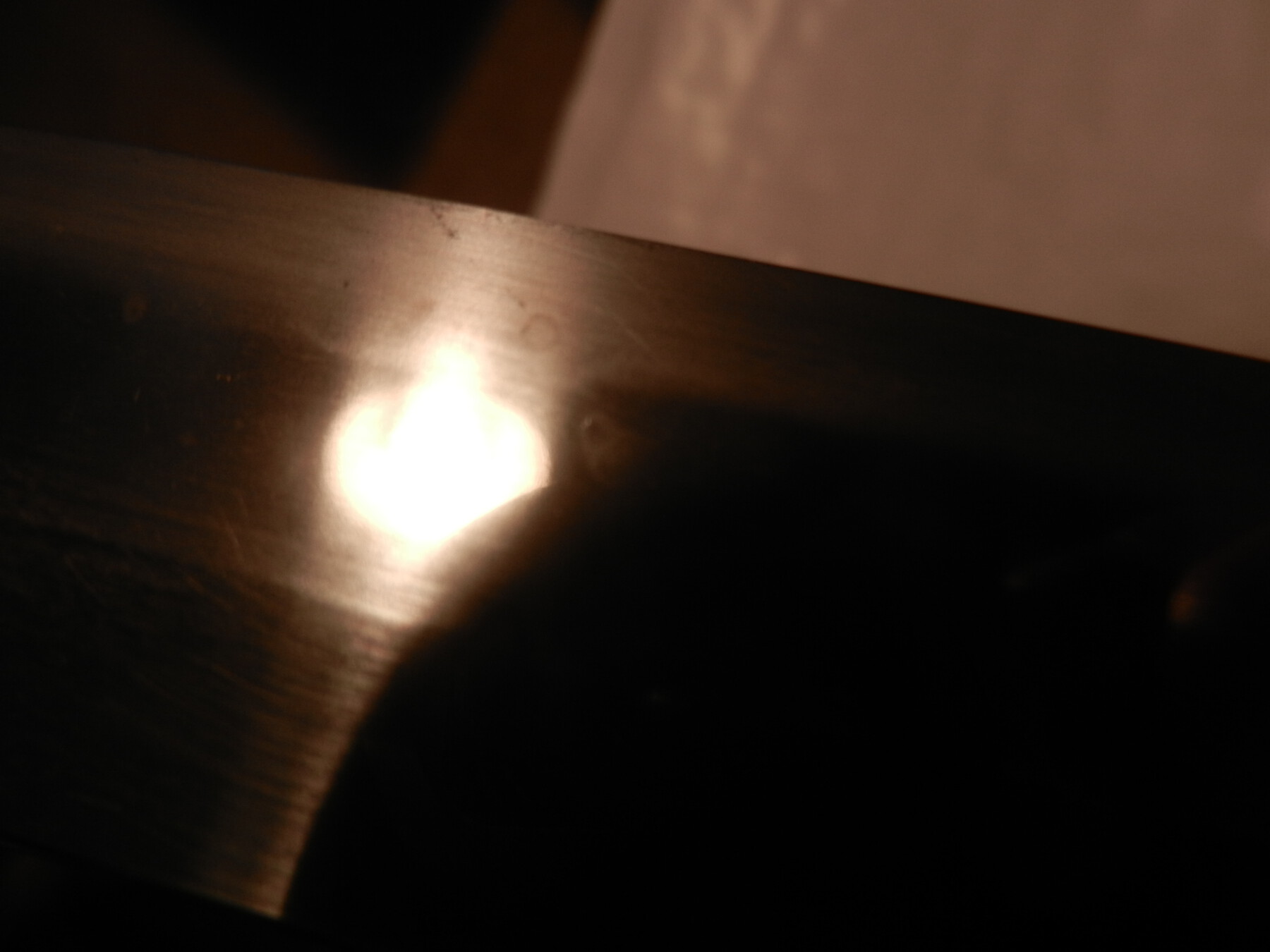

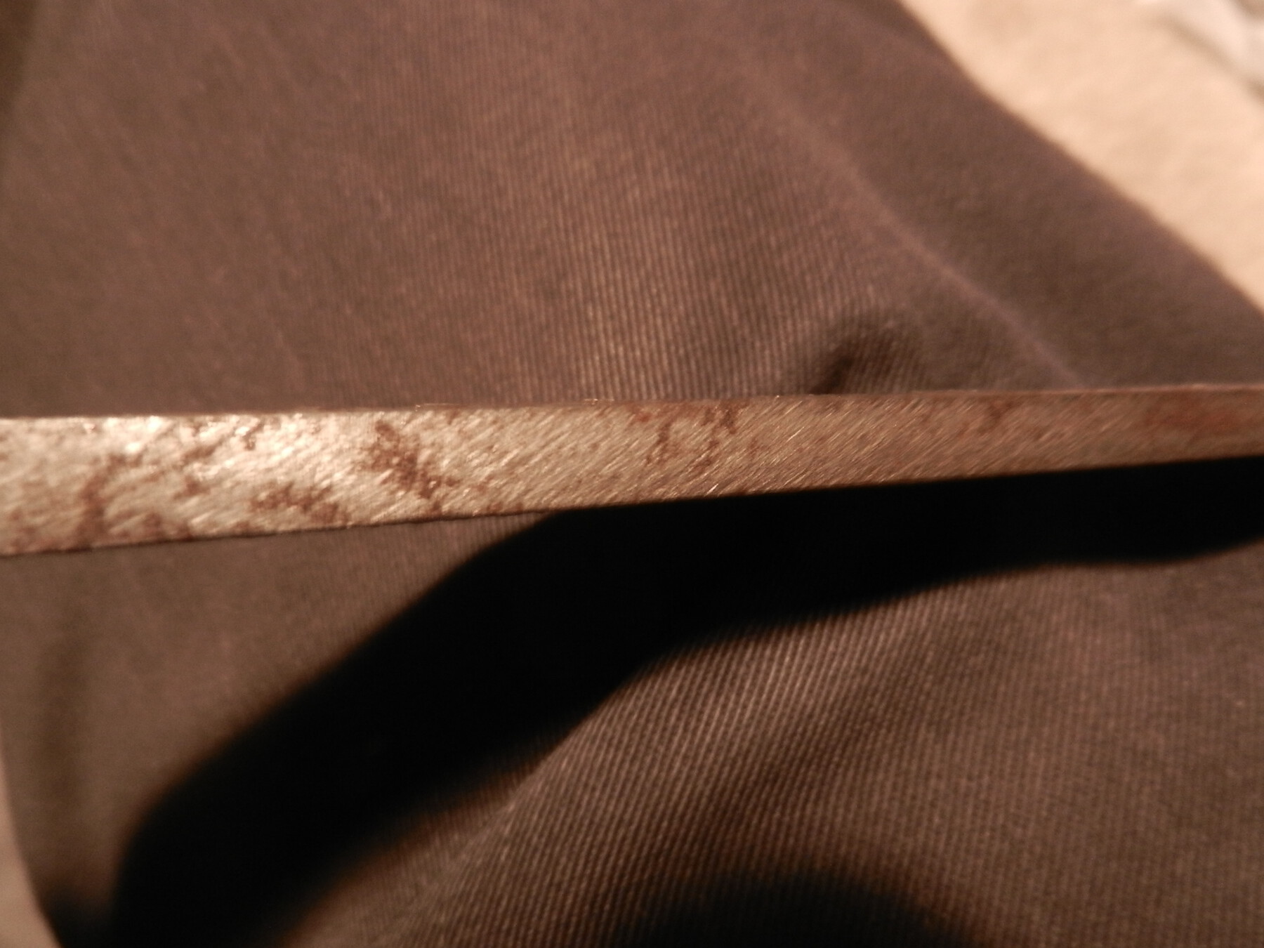

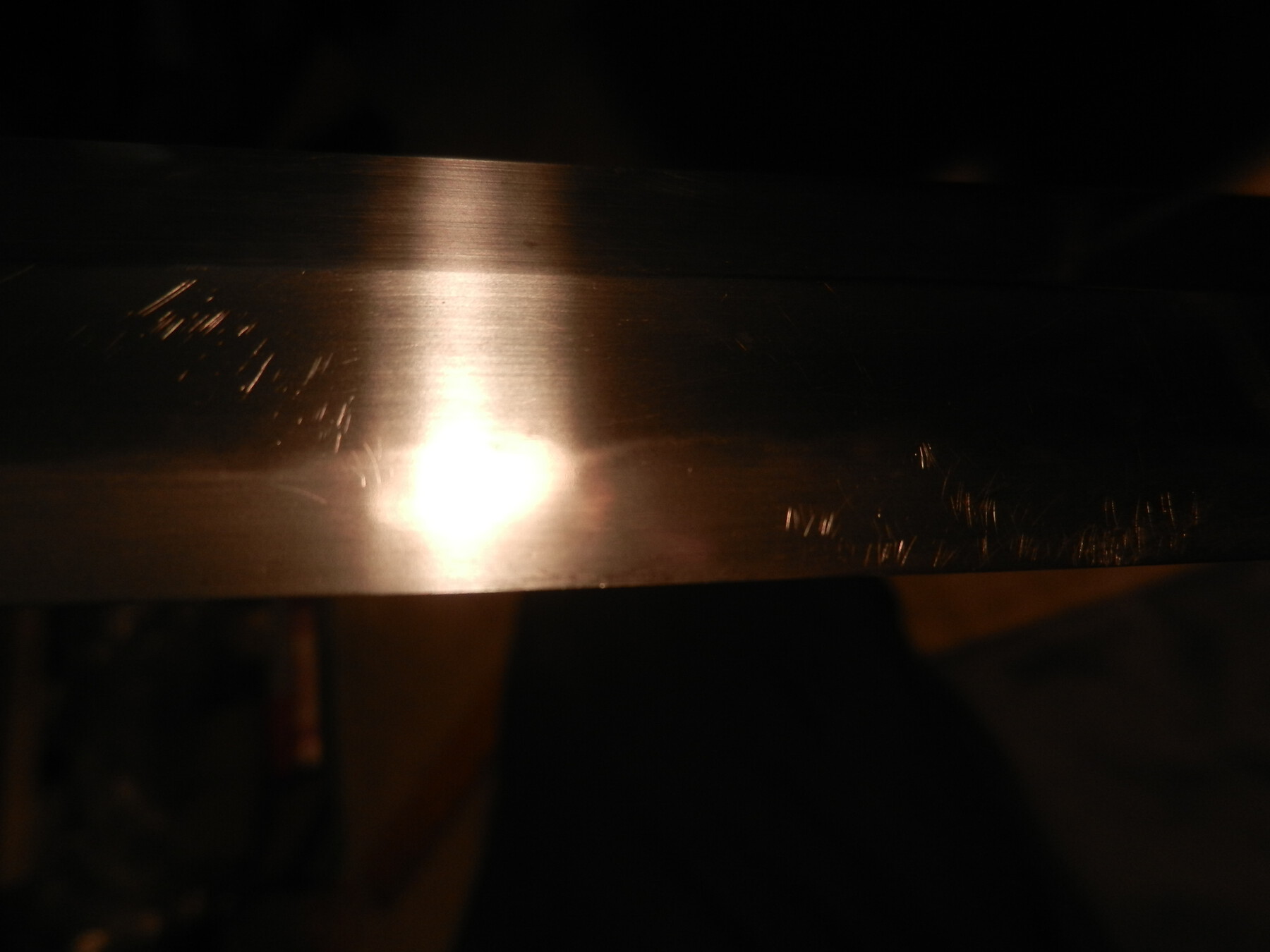

Tom Darling Posted September 30, 2020 Report Posted September 30, 2020 The yasuri-me, I believe is the give away, made by mill steel , as the yasuri appears to be (evident ) on very hard steel, not deep and sharp, factory made. But, still is a nice sword. IMHO. I'd like a clear pic of the ji and ha. Thank you. Tom D. 1 Quote

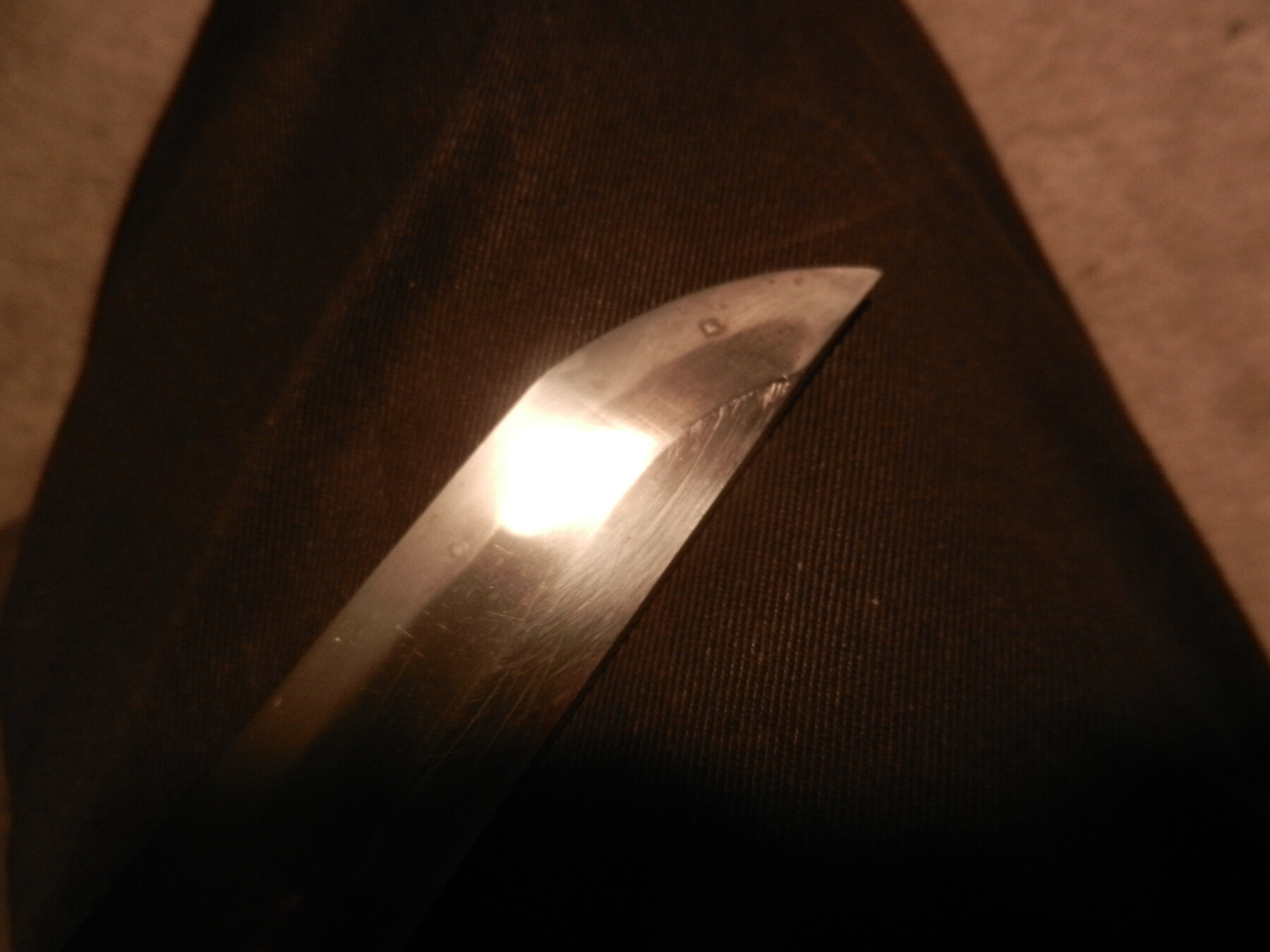

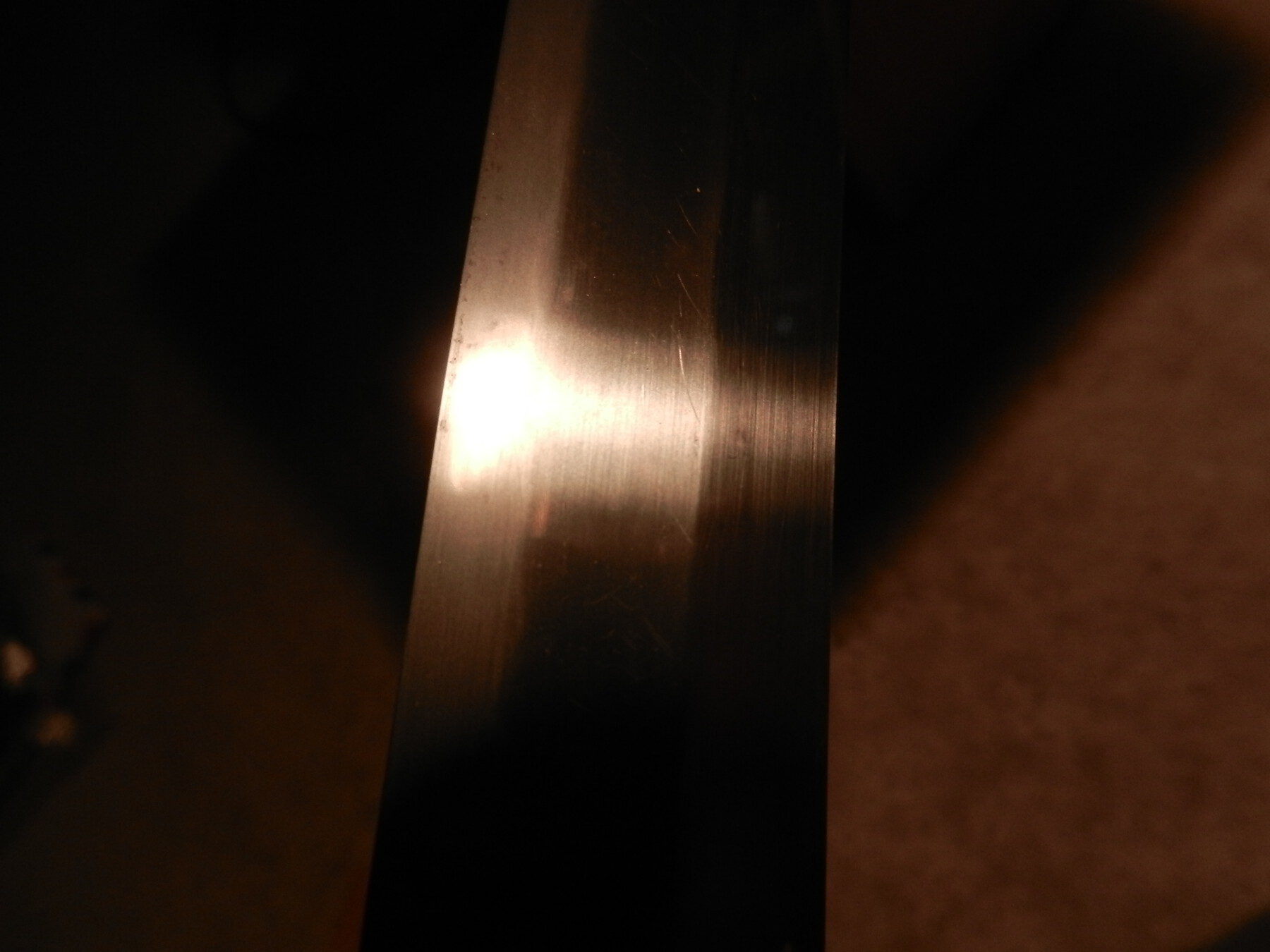

baldi1942 Posted October 3, 2020 Author Report Posted October 3, 2020 Well, sorry fellas , but sold the sword and it will go to Japan and be polished and papered or not - will be a while but will definitely let u know the outcome of the shinsa. In the mean time I'm gonna go for a PHD in metallurgy so I can understand the difference between tamahagane and common ol mill steel and how the yasurime is so easy to clue one on the difference. I can't get a good photo of the hada or hamon but did compare this sword to the other Minatogawa I had and also a Yasukuni-to and the hada looks the same on all 3- very tight very fine itame IMO not muji but the hada on all 3 blades just is so tight and this presentation Minatogawa-to hamon resembled the Yasukuni-to hamon more than the Masatada Minatogawa-to. Anyway, stay tuned and maybe next year we will know the results of Ol Haruto's presentation Minatogawa Jinja katana. 1 Quote

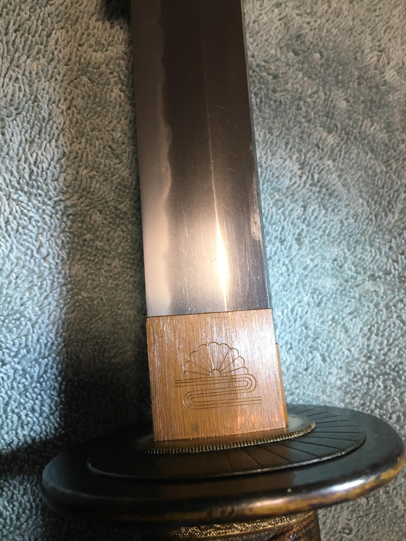

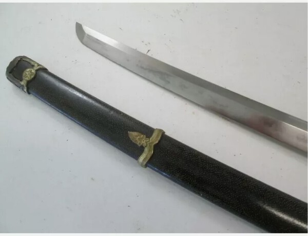

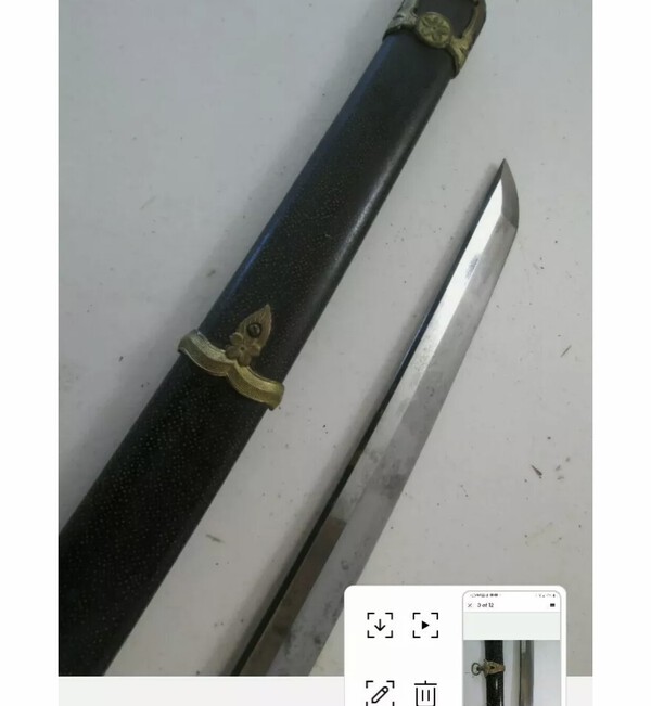

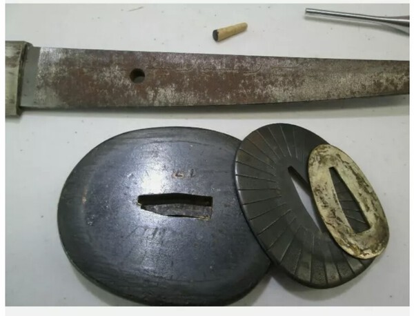

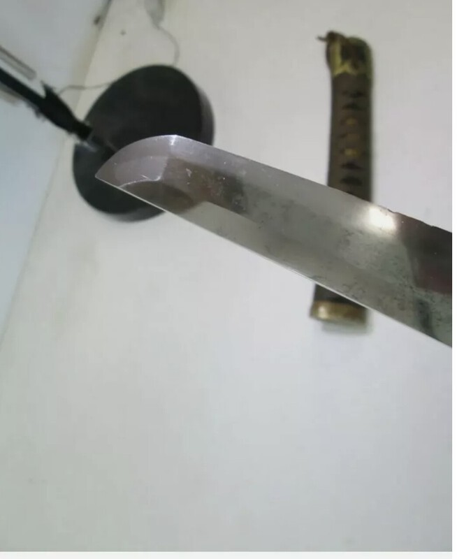

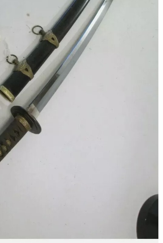

Swords Posted August 9, 2021 Report Posted August 9, 2021 Hi I have been reading this thread about this WW2 Japanese SWORD KATANA this ones SIGNED MASATADA 1943 DATE MINATOGAWA not the early 1941 I wanted help the blade it has no nicks some dark spots but seems not too bad orverall! any help ?! Is it a worthy sword thinking of buying it had to shrink pictures to get them so hopefully it’s enough steve Quote
Volker62 Posted August 9, 2021 Report Posted August 9, 2021 Hi Tom I don't know of any earlier date of a "kikusui blade". once had one of his own, that was dated August 1941, that a "GOOD Collector Friend took from me, and then sold it to a lawyer in china for more than double the price , against his promise. Nice find Tom! Volker 1 Quote

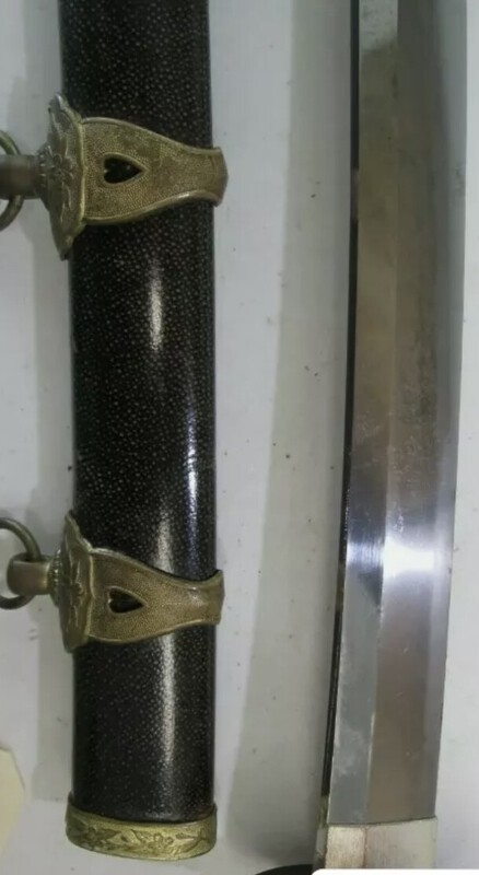

Bruce Pennington Posted August 10, 2021 Report Posted August 10, 2021 On 8/9/2021 at 5:34 PM, Swords said: MASATADA 1943 DATE Expand Looks like a nice Kaigunto, Steve. Can you give a clear pic of the date? Looks like Showa 10 7, if I'm seeing it right, which is 1942. Minor point. Quote

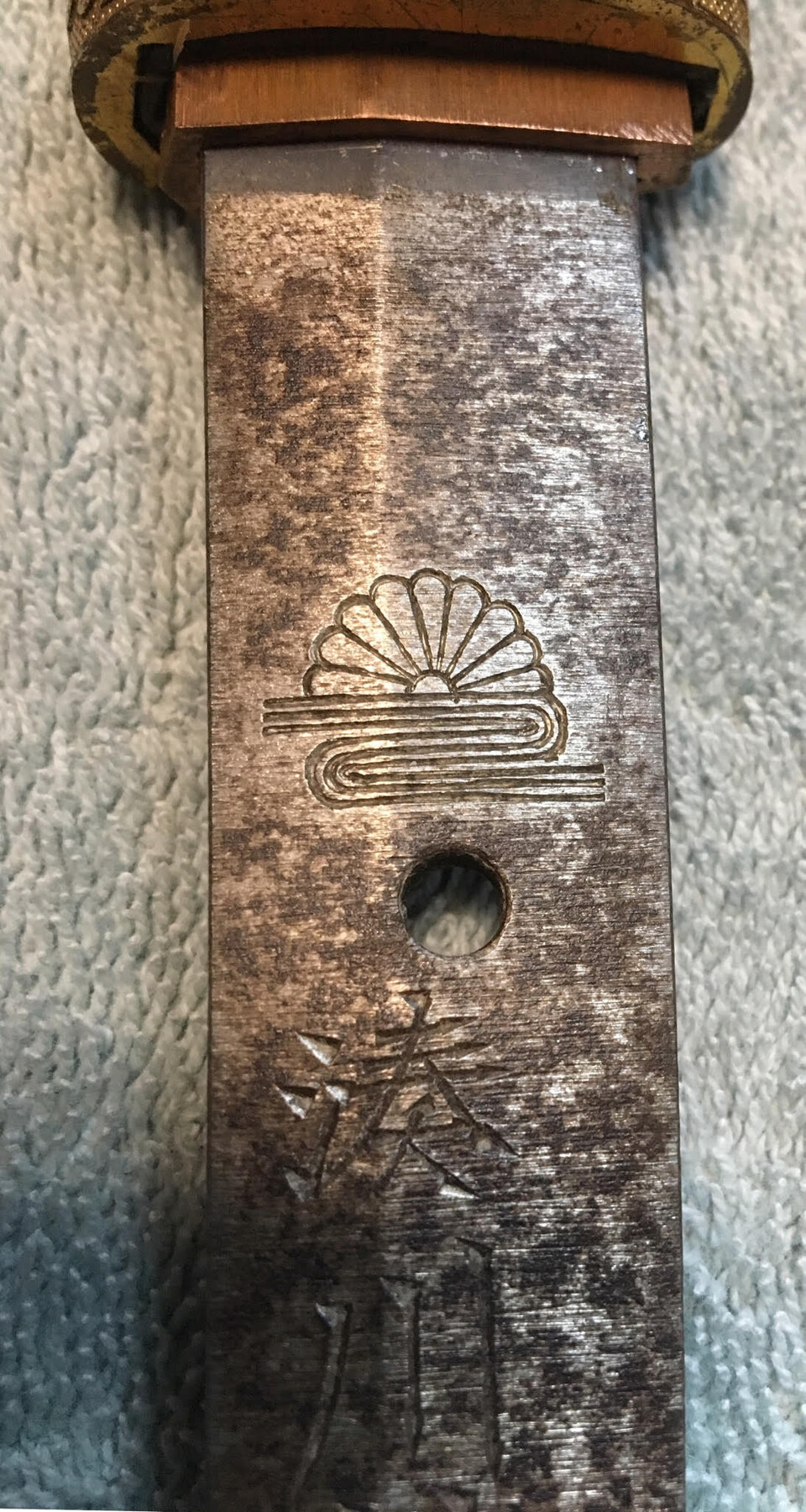

PNSSHOGUN Posted August 10, 2021 Report Posted August 10, 2021 With no Kikusui on Habaki or Nakago it's difficult to classify this one. If you are buying a Minatogawa Shrine sword you don't want any asterisks next to it. This has also been listed for some time, usually Minatogawa Shrine swords sell very quickly as demand is always high. 1 Quote
Swords Posted August 10, 2021 Report Posted August 10, 2021 Hi I’m trying to get more pictures including the Habaki what’s the Nakago and-asterisks 🤔 I should know that! hopefully will get more perspective I do have some doubts It has dark spots no nicks from what I was told I can always return if there’s issues what makes you think it’s not a Minatogawa Shrine sword thanks for your help steve Quote
IJASWORDS Posted August 11, 2021 Report Posted August 11, 2021 Steve, without seeing these on a MINATOGAWA, at your stage of collecting I wouldn't take the risk, unless it has been papered. 3 Quote
Swords Posted August 11, 2021 Report Posted August 11, 2021 Hi I agree I’m going to pass I also noticed a couple of chips after I asked if there were nicks he said there wasn’t any! Never got more pictures I asked for I think I will buy from someone on the forum Too many bad swords on EBAY You can list a piece of junk and some one will buy it! I have seen a couple that I really liked on the forum but a little pricey So I will keep looking for a good one There was one that was a special order that I really liked but a little pricey for my pocket Now that I can get good feed back from others on the forum I won’t make a huge mistake Thanks for your help steve 1 Quote
