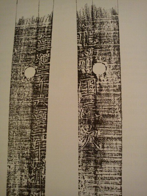

Bruce Pennington Posted August 31, 2020 Report Posted August 31, 2020 From an old post on the Arsenal Stamps thread. I'm starting to log RJT star-stamped blades and would appreciate a mei translation on this one. I think the year is 1943, right? Thanks!!! Love you guys! Quote
uwe Posted August 31, 2020 Report Posted August 31, 2020 I would say “肥前国正次” (Hizen no Kuni Masatsugu) Nengo seems right: “皇紀 2603” as far I can tell.... 1 Quote
mecox Posted August 31, 2020 Report Posted August 31, 2020 Yes it is Taguchi Masatsugu. Hizen no Kuni Masatsugu Koki ni sen roku hiaku san nen u-zuki kichi jitsu (uzuki is April, year of the Hare , U Nen) “lucky day 4th month 2603 years Japanese Empire” (April 1943) This old oshigata is from Mr Han Bing Siong of Netherlands Token Society. I believe they got NBTHK papers from Japan for it. 1 Quote
Bruce Pennington Posted August 31, 2020 Author Report Posted August 31, 2020 Thank you gentlemen! Quote

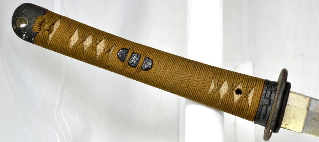

davidequis Posted September 8, 2020 Report Posted September 8, 2020 This is additional research info for those interested in munetoshi swords. This sword came back from PNG sometime during the war. Original Australian owner was a medic. its acquisition history is not known. Possibly from Milne bay. blade is in as new condition, which I assume is a reflection of the quality of the steel. Handle, leather scabbard cover and fittings are showing their age. 1 Quote
Bruce Pennington Posted September 8, 2020 Author Report Posted September 8, 2020 That's a great example David! Racking my brains for another leather covered Rinji seishiki model, but I can't recall seeing one. No reason a guy wouldn't want to protect his RS saya, I just don't recall seeing it before. Very Cool! Is the blade star-stamped? If so, could I get a pic? Also any other stamps on it? 5 hours ago, davidequis said: munetoshi swords Quote
george trotter Posted September 8, 2020 Report Posted September 8, 2020 Nice sword David, I have one by him in the same mounts (no leather cover) with star stamp. Mine is 7 months after yours being date 18/5 (May 1943) and matsu in a circle stamp is number 1080. BTW (for our US friends) Milne Bay in PNG was one hell of a battle (25 Aug-7 Sept 1942) and the Aussies stopped the Japanese there...didn't stop the war, but drastically weakened the Japanese army in PNG. Going by the date on your sword David (17/10 = Oct 1942) your friend's dad (while being a medic at Milne Bay himself) probably got the sword some time later, at one of the later battles/surrender. Great stuff, Regards, 3 Quote
davidequis Posted September 9, 2020 Report Posted September 9, 2020 Thanks Bruce and George, There is no sign of a star. What was posted is all we can see. There was another post that mentioned that munetoshi started using the star in November 1942, one month after the production of this sword. I have read that we should not do anything with the rust on the tang...is this correct? Quote
Bruce Pennington Posted September 9, 2020 Author Report Posted September 9, 2020 1 hour ago, davidequis said: I have read that we should not do anything with the rust on the tang...is this correct? Your rust is orange which means active rust. I've seen two approaches, either oil it and leave it, stopping the advance of the rust; or use a deer antler (you can by these at pet shops) to scrape the active rust off. The antler won't damage the nakago nor will it remove worthwhile patina. Quote
davidequis Posted September 9, 2020 Report Posted September 9, 2020 Thanks Bruce, another question... The fittings need care and the lacquered silk on handle is “crazed” (looks like mouse droppings) clean and stabilise fittings? polish fittings? restore crazed lacquer? aaand suggestions to clean blade? It has a very sticky grease on it - might be gun barrel grease. All guns were shipped to PNG full of the stuff. My Pa’s troops received bren guns on the Kokoda track that couldn’t be used until they were cleaned...not much fun when they were in the thick of battle. Quote
Bruce Pennington Posted September 9, 2020 Author Report Posted September 9, 2020 Maybe someone will chime in with their favorite cleaning compound to remove 80 yr old grease. If not, search the word "cosmoline" and you'll get a few pages where guys discussed its removal. All the metal parts show active rust, so I'd definitely use a rag and some oil (choices vary - sewing matching oil and choji oil are most mentioned. I just choji oil which is a mix specially made for Japanese blades of clove oil and mineral oil with a pleasant aroma mixed in). Another search for leather protection will reveal several products guys like. Quote
