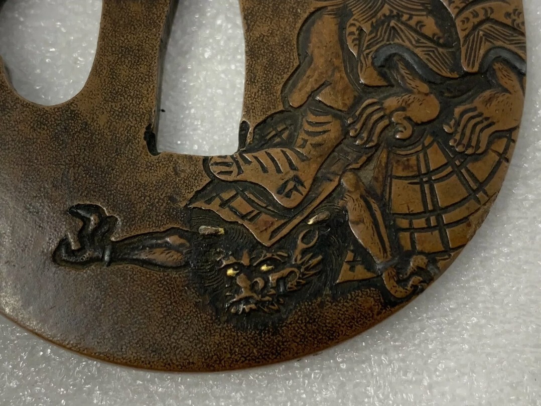

Oni tsuba, nara school early 19th century. Is this any good?
I posted in WTB a while back looking for an oni tsuba.  I didnt get any bites there and since then have been hovering over the idea of purchasing this tsuba.  I will attach photos and the description used by the seller.  In hoping more honed tsuba eyes can tell me if this is a quality tsuba as the asking price is not cheap.  Is the description accurate and is it considered a finely made tsuba worth acquiring as a quality item?

In my humbled opinion:  On this tsuba the design is partially on the seppa-dai.  There are 2 types of tsuba where this is expected: Very late Edo/ Meiji pieces made by top quality kinko artists who were working largely for a western, tourist audience because the Japanese market for swords and kodogu had dried up, and modern fakes.  This tsuba isn't one of those in the 1st category.
I know this is a great generalization and there are exceptions to every rule but, in this case I think I'm right; this is a stinker.
Grey
Ok, thank you Adam and Grey.  I will pass on this tsuba.  My gut was telling me to pass hence sitting on it for months but I needed that more experienced eye to confirm so I appreciate the feedback.

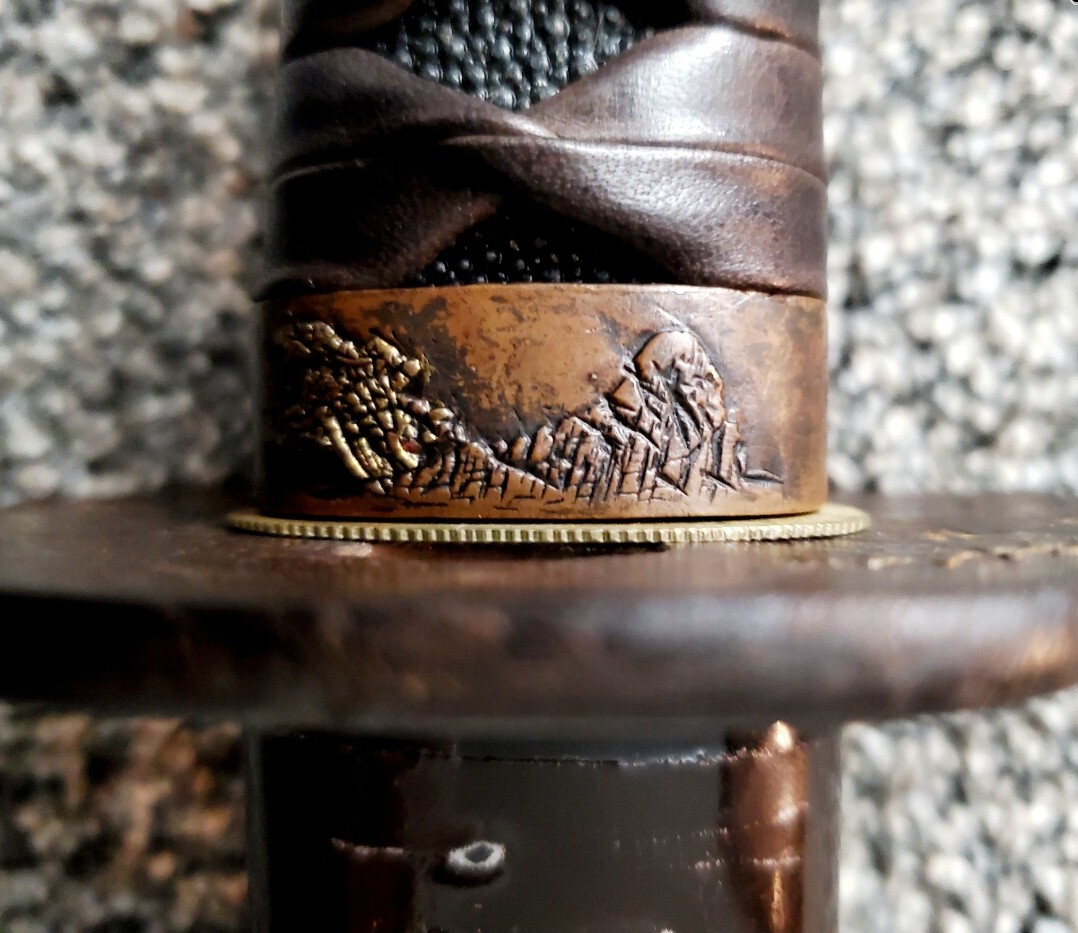

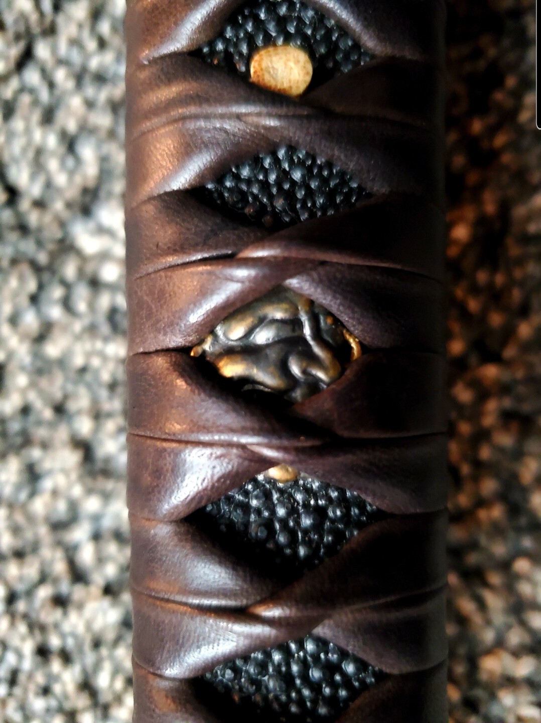

Adam, I do have a ghost/oni themed tsuka and the tsuba has a nature theme.  The tsuba that is there works and I like it but if I found the right oni/ghost themed tsuba I would be pretty tempted to change it out keeping the one it has as a display/decoration item.  I attached the photo of the one that came with it and its oni fittings.
Also does anyone know what that menuki is that looks like an anchor?
The tsuba I posted definitely seemed to have some good etching and I do like what was done with the surface of the tsuba but I did feel it had more of an "art" therefore touristy piece vibe that didn't match the other used "functional" tsuba I've seen.

Dare I say it Adam without offending the masses. Your fuchigashira is modern repro from what I can see.If its not I apologize but it certainly is one I would have passed on. It's not high level workmanship that's a given.
The menuki also seem to fit this vein.
On a personal note I greatly dislike leather Ito and black Samegawa.
Whilst most of your stuff I like, this one sadly is not for me. It's got no "history" or presence to it . It's all too new.
The tsuba being tetsu and mid Edo is certainly a functional item. I don't think it's specifically for the tourist trade. Or are you talking the copper tsuba which is for the tourist?

Adam, the copper one felt artsy therefore touristy.  Yeah, the tsuka and saya were recently made  which was stated in the ad (the habaki might be new as well).  The ad for the sword when my brother bought it also said all fittings were antique (but I think the unofficial rule is to make something an antique it only has to be 50 years old?).

Yes, that's the way.  The chief decorative element should face out when the sword is worn in the obi.  This seems to be a nice blade that has been mounted very recently, the seller was up front with that.
I am sure most of us would suggest getting a decent shirasaya made for the blade.   The mounts are a distraction and a good example of why one should always be careful of the urge to fix up some koshirae for a blade.  Unless you are prepared to go the whole way, buy good quality and appropriate fittings and spend the money on good craftsmanship, you tend to end up with something that just doesn't feel right.

blade and habaki are ok, fuchi, kashira, menuki, and seppa are terrible modern stuff.
Depending on the saya quality, maybe you can keep the tsuba, saya and tsuka, if the quality is ok (wood only)
You remove same, fuchi, kashira, menuki and ito.
Then,find nice fuchi-kashira-menuki, antique ones, put them on the existing tsuka, if actual tsuka is bad, make a new one.
After that you make new seppa from brass sheet, seppa are easy to make, you can also try to find antique seppa, don't use existing modern seppa.

but just the menuki could be good, and simple design fuchi-kashira, would be ok, adding nice samekawa, a 5000 or 8000 JPY quality from namikawa, with good polish and weathering, and final nice tsukamaki using silk ito.
I may revisit this sword down the line.  Right now the tsuka and the saya were specifically made for this blade commissioned by the previous owner who obviously had a taste/vision for it.  The tsuka is made of wood and actually feels quite good quality to be honest.  Its tight, real rayskin, the leather ito wrap looks consistent/pretty competently done and feels really great in the hand/grip.   Both saya and tsuka seem to house the blade well and keep it safe but I will look into having a shirasaya made.
Bummer to find out the menuki, fuchi and kashira are all just modern blah pieces.  Hoped for a some age on them but shyoganai...(one of my favorite Japanese phrases, means "can't be helped, it is what it is type meaning).
