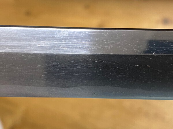

I maybe should be the one to not speak on this, but could the Tachi be what Markus Sesko calls on his website "itame mixed with masame"? Playing around with the mobile phone I captured the attached shots which should show more details.
I see no hamon, sorry. Only a rough mokume hada. Hamon line could be etched.
Take a good light if you find a white line between the hada and that hamon.
I think the hardned edge is outpolished.

Well done George those images help a lot and I can see the hamon is there

Basic midare hamon, & more nioiguchi than I expected. The thinness of the hamon indicates a lot of earlier polishes, & that's backed up by the kasane photos. This might well mean an older blade.

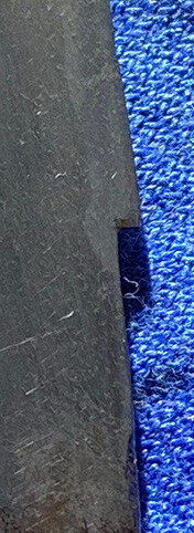

Georg, firstly, please do not sell the sword yet. Part of the fun in spending very little for a lottery is winning big later. You already did this with your Masayuki 😃
Second, on the hamon, looking at this hamon it seems to clearly end right on the hamachi, if the sword was osuriage then i would not expect that in most cases. I would be interested to hear opinions now that we can see masame, sugu - midare hamon and this sugata, what the consensus is on school? If older i would lean to Naminohira or direct Yamato, but, if shinto onwards, any other opinions?
If it ends right on the hamachi then it surely is a re-temper.  The odd-looking hamon tends to suggest that.  The odd little bump at the hamachi is how some smiths end their hamon (my Gassan Sadakatsu, for example). Georg did say that the hamon continued into the nakago and I looked very carefully at this feature at the hamachi.  I cropped the image (attached) and it appears to me to continue into the nakago...

If a blade has gone through many polishes it loses its ha machi I would guess so machi okuri would at some point be a necessity.... or are my assumptions wildly off?
Polishing is a matter of necessity in most cases so are we also to assume that a sword with machi okuri has been well used in battle or perhaps abused?
Adam
You are right that a blade can indeed lose its hamachi. A machi can be created by chiselling into the nakago and slightly reshaping the nakago. You can see that occasionally. In fact I had a sword that had that
Another way of maintaining the hamachi is to polish the blade down a little leaving the hamachi intact.  In other words, in-curve the ha in a new polish.  We have seen this feature in a recent thread.  It usually indicates a Koto sword, but I once had a hirazukuri wakizashi signed Bizen Morimitsu and dated to Oei that was a Shinshinto utsushimono.  It had an in-curved ha to make it look old...  And the kasane was also thinned relative to the nakago to make it look old.
BaZZa.
I'm pretty sure even that process has to be done on heated metal that is not Martensite any longer ,but becomes once again Austenite then perhaps Pearlite as martensite could shatter relatively easily.
Interested in knowing how you can perform Machi Okuri without affecting the rest if the ha near the Machi.
If we have Osuriage then a much larger area must be reheated or you will struggle to reshape and file the new nakago.

Thanks to all who had replied after my post. Attached a picture from above with markup. Note how perfectly smooth the surface in this area is, the first and very few file streaks become visible at height of first hole. Wouldn't this be a sign that it formerly was polished in this area and the blade originally was much longer? Secondly, I marked (or at least tried to mark) the line I was able to see .. it seems to extend back. Or do I see something wrong?

Hey Georg, what could you do to make the hamon visible:
1) use etchants (from lemon juice all the way to proper acid): in one word, “forbidden”
2) use polishing stones: reserved for polishers, so again, for the vast majority of us,  “forbidden”
3) use uchiko: for blades out of immaculate or stabilised polish, one can argue, as the one in this topic here, it is OK, if the blade will hit the polishing stones referred to in 2) above anyway. However, plenty of posts on that topic in this forum. So, why do you need to refer to this anonymous “Kevin” is not clear.
4) oil, wipe, oil, wipe, oil, wipe,oil, wipe, etc. Repeat numerous times.
Also mentioned on this forum numerous times. Again, no need for Kevin, but thank him anyway.
5) take photos at an angle, with the main light coming from behind you and another light source ahead of you and the sword tip pointing toward that other tip ahead of you.
if there is no hamon (eg blade heated in some way and martensite decomposed back into austenite and pearlite) or the hamon has been polished away, you cannot see it.
  • Haha 1
I think the hamon is there to be seen.  Wait until it is dark outside and just put on one incandescent light across the room.  Point the sword at the light and slightly adjust it until the light bounces off the hamon.  You should be able to see it I would think.   You want to look for a nioiguchi (temper line) that is uninterrupted and goes the length of the sword.
