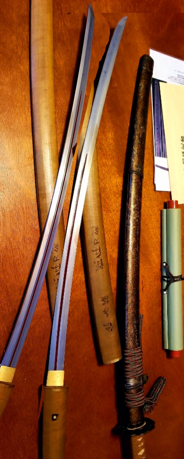

Bazza Posted August 25, 2020 Report Posted August 25, 2020 Yasaka san wrote: > BaZZa san. Please make up for a little confusion and unclear understanding of terms, and I want to ask for forgiveness with my weird English. Yasaka san and all, please forgive my confusion - I'm old and often put my keyboard into gear before engaging my brain, in other words I thought without thinking!! Even having an asymmetric katana with shinogi tsukuri/kata shinogi tsukuri I still get confused... Here is my sword: BaZZa. 1 Quote
waljamada Posted August 26, 2020 Report Posted August 26, 2020 Don't have anything to add of depth to this but I find the asymmetry of those blades absolutely beautiful. I personally find a little asymmetry amongst symmetry draws attention to the human hand/mind within the symmetry. Like seeing a painting in logic or something. My examples are just aesthetically assymetrical. One or both of which the horimono added much later. BaZZa, if you ever want to sell that blade please think of me. =|:^) 1 Quote
