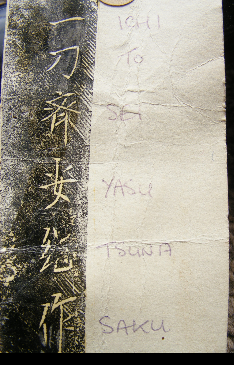

Babu Posted August 16, 2020 Report Posted August 16, 2020 Hi I've got a katana with this mei I'm struggling to find any reference to a Smith of the late 19th C to early 20th at all. Can anyone help? Thank you Quote
16k Posted August 16, 2020 Report Posted August 16, 2020 Could it be Namika no ju Tachibana yastsuna (settsu bunsei)? Quote
Babu Posted August 16, 2020 Author Report Posted August 16, 2020 16 minutes ago, 16k said: Could it be Namika no ju Tachibana yastsuna (settsu bunsei)? Any reference you know of JP? That name gets a zero on a web search. Quote
16k Posted August 16, 2020 Report Posted August 16, 2020 No, nothing more, sorry. A French référence book gives a listing of many swordsmiths active during the Shinshinto period and only lists two Yasutsuna. The other one uses different characters, so I suggested it might be this one. However, there’s no way for me to tell how exhaustive that list is. Have you tried here? https://nihontoclub.com/view/smiths/meisearch?type=All&mei_op=contains&mei=Yasutsuna Quote
chi fan wong Posted August 16, 2020 Report Posted August 16, 2020 Hawley has an entry on ichitosai yasutsuna from mino dated 1935. 1 Quote
Babu Posted August 16, 2020 Author Report Posted August 16, 2020 Gendaito Smith Chi Fan? The yasureme is consistent. Quote
Jussi Ekholm Posted August 16, 2020 Report Posted August 16, 2020 I think mei is 一刀斎安綱作 - and smith Ittōsai Yasutsuna. He was born 1924 and died 1990. Here is one reference sword: http://kako.nipponto.co.jp/swords2/KT215546.htm 4 Quote
Babu Posted August 16, 2020 Author Report Posted August 16, 2020 Gentlemen thank you that helps a lot. The mei is a bit different though. And that reference sword Jussi has a seki type stamp on it . Still looks traditional made though. This one is in it's original civilian mounts. Quote
