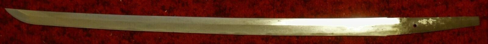

mtexter Posted August 14, 2020 Report Posted August 14, 2020 I'll have a lot more pics once I get it in a couple of weeks, but if anyone can take a look with more experienced eyes, how do you think I did? https://www.ebay.com/itm/203072504206 Thanks! And if I messed up, be gentle, it's my first attempt at buying a real blade Quote

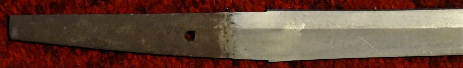

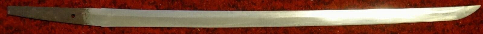

Katsujinken Posted August 14, 2020 Report Posted August 14, 2020 You got what you paid for. As long as you weren’t expecting a better sword to come out of the woodwork here then I expect you got what you wanted. It does look authentic, but it’s loaded with flaws and has seen a ton of abuse (I see fingerprints) and was “polished” (or something) by someone unqualified to do so. You can see that the width of the blade is inconsistent along its length, one side has a yokote and the other doesn’t, etc. The proportions are now a bit strange overall. Maybe others can speculate on the age and the signature, but at this price point neither really matters. 2 Quote
mtexter Posted August 14, 2020 Author Report Posted August 14, 2020 yep, I wasn't exactly shooting for the moon here. If I bought an authentic, possibly traditionally-made tamahagane Japanese blade, then my goal was achieved. Could definitely make out a sort of funny shape and several flaws, but as a start to a someday-modest collection, this would be enough to make me happy 3 Quote

Babu Posted August 14, 2020 Report Posted August 14, 2020 I second you got what you paid for but you won't find out it's the lost masamune. Someone should tell you who's the mei is. Still I think at that price and budget you did as expected. Congratulations. 2 Quote
Rich S Posted August 14, 2020 Report Posted August 14, 2020 Mike I think the boshi is all there and obviously several ware'. I would think for the price you got a true Nihonto even if in rather poor condition. Congrats you got your first real blade. Rich 1 1 Quote
Grey Doffin Posted August 15, 2020 Report Posted August 15, 2020 Hi Mike, The mei is Jumyo. It is a real sword but not even close to being worthy of restoration; don't spend any more money on it. Learn what you can from it and then try to move up to something in much better condition. Grey 1 1 Quote
mtexter Posted August 15, 2020 Author Report Posted August 15, 2020 Thanks Grey. This is definitely meant to be a blade that I can study, figure out best practices for care, rust removal (NOT polishing!), and can study up close to learn more of the terminology and look for certain characteristics. I hope it's useful for these things. All in all, as a budding collector with a limited budget (and before I go back to my family's collection and handle some real pieces again) I think this is a good step for me. Thanks all 1 Quote
Mister Gunto Posted August 15, 2020 Report Posted August 15, 2020 I think Grey and the others have prety well summed it up. All collections have to start somewhere. You bought a thing, and it's a real , original, and old Japanese Nihonto thing. And that's very cool. Better than being totally ignorant and starting off with a Chinese replica (which is what I did, years ago). 1 Quote

Surfson Posted August 15, 2020 Report Posted August 15, 2020 I agree with Grey, study it but don't invest further in it. Jumyo is a very common mei and there were many of them over the centuries. There's no reason to think that it is not a genuine mei, though once you get the talcum powder out of it you can look to see if it was cut hundreds of years ago or more recently (in part by looking for recent rust in the signature). Congratulations on breaking the ice with a decent inexpensive starter sword. 1 Quote

SAS Posted August 24, 2020 Report Posted August 24, 2020 Shinto probably.... would look nice polished, but the polisher would have to correct some geometry issues from an amateur's fiddling. 1 Quote
