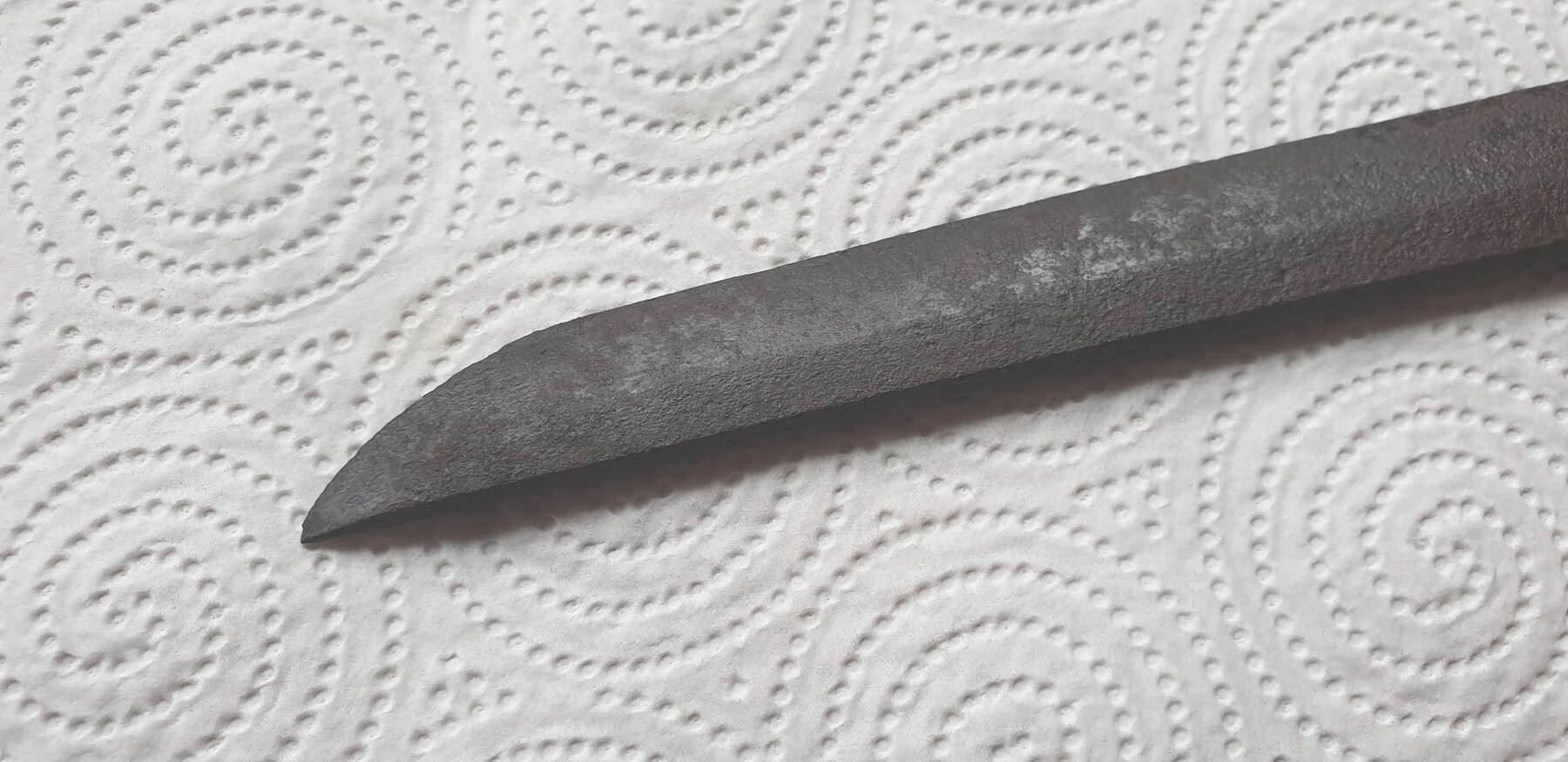

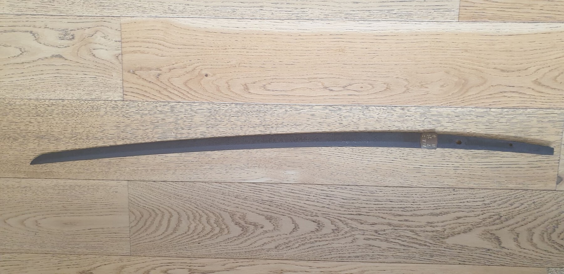

Steve D Posted August 14, 2020 Report Posted August 14, 2020 Hi all Japanese sword virgin here.. Following on from this post... I thought I'd see if anyone can recommend some tips on what I would need to do to preserve this blade to prevent any further damage or decay until I am able to get a professional to look at it. It's a sugata that was given to me when my mum cleared out the garage of dad's old things. Been in the family for over 40 years but know no history and has not bee cared for so is in pretty bad shape. Here's some pics: Quote
Ken-Hawaii Posted August 14, 2020 Report Posted August 14, 2020 Steve, sugata is the shape of the blade. If it's two feet or longer from the notch to the tip, it's a katana. If 1-2 feet, it's a wakizashi. Looks like a katana, from its proportions. My guess is that it's been in salt water for awhile, & the only help you can give it is to cover the cutting area with some oil. Quote
Steve D Posted August 14, 2020 Author Report Posted August 14, 2020 On 8/14/2020 at 7:19 AM, Ken-Hawaii said: Steve, sugata is the shape of the blade. If it's two feet or longer from the notch to the tip, it's a katana. If 1-2 feet, it's a wakizashi. Looks like a katana, from its proportions. My guess is that it's been in salt water for awhile, & the only help you can give it is to cover the cutting area with some oil. Expand Thanks Ken. It's approx 32 1/2" overall, about 25" from the habaki(?). It's not been in salt water, just stored in a damp garage unfortunately. Quote
Ken-Hawaii Posted August 14, 2020 Report Posted August 14, 2020 So, a katana, & quite badly pitted. Too bad, because the sugata is interesting. Looks Muromachi, so at least 400 years old. Quote
Steve D Posted August 14, 2020 Author Report Posted August 14, 2020 On 8/14/2020 at 7:33 AM, Ken-Hawaii said: Looks Muromachi, so at least 400 years old. Expand Seriously? 😲 Quote
Ken-Hawaii Posted August 14, 2020 Report Posted August 14, 2020 I own several blades almost twice that old, so, yes, seriously. Not very unusual, as the Muromachi period was almost constant wars, so many blades were made. 2 Quote
16k Posted August 14, 2020 Report Posted August 14, 2020 On 8/14/2020 at 7:33 AM, Ken-Hawaii said: So, a katana, & quite badly pitted. Too bad, because the sugata is interesting. Looks Muromachi, so at least 400 years old. Expand I believe it might been even older, Ken. Looks koshi zori to me. That's why I advised Steve to keep it until better can be said. If it can be saved, it looks very promising. Quote
Ken-Hawaii Posted August 14, 2020 Report Posted August 14, 2020 Too much funbari for Nambokucho, JP, & of course we can't see the boshi. Quote
16k Posted August 14, 2020 Report Posted August 14, 2020 Actually, I was thinking even older. It is suriage so the shape is altered. Or I am completely wrong and it’s a Shinshinto utsushi. Quote
Alex A Posted August 14, 2020 Report Posted August 14, 2020 Cant remember ever seeing a blade that evenly rusted. Quote
Babu Posted August 14, 2020 Report Posted August 14, 2020 That's the point gentleman.it could be anything at this stage even something not worth spending on. Best advice smother it in top quality machine oil to allow it to penetrate the rust completely. Clean off the excess oil and store blade naked of everything including the habaki (it comes off) in a dry place. When you have the funds and joined a polishers waiting list,get him to open a window. This should cost about £200. If he thinks it worth polishing then that's your decision to make.expect IRO £700-1000 to get it done in the UK. He will deduct the cost of the window if you proceed. Remember it's just a random window it tells you a little but not the whole condition of the blade,and with a blade that you cannot see anything of, you could still end up paying for the polish and the sword comes back with several deep pits,openings or kizu which will make it practically worthless in terms of your cost to this point. The hamon may also run off the sword somewhere. You won't see any of this until it's polished.Then have to get a shirasaya made £300-400 to protect the sword. Find a Koshirae that fits if you want and is half decent quality £600-700 After the polish unless you get the habaki reworked you will need to have a new habaki made as that blade will be much thinner than it is now. So the reality is you may spend on a non Japanese polish and shirasaya IRO £1100-1400. You MAY get back a very nice sword. Worth £2000 (minus your £1400 outlay You may NOT get back a sword of any value as although the windows said it's possible to salvage, it's still a huge gamble. Now there are members who do have this money and would get the work done to TRY to restore it but they would be taking on your gamble. If you are offered anything like £500 for that little lot personally I think that's your best bet unless of course you're an enthusiast with deep pockets and you like to gamble. The buyer has the potential to lose £1500 in that sword. Now if you wish for a quality Japanese polish then your looking at what, a two or three year wait and £3000? £4000? So truly what sort of money could you gamble on that sadly neglected,time ravaged sword. No offense meant here. 1 Quote
Babu Posted August 14, 2020 Report Posted August 14, 2020 I think that's a reaction with something put on the blade it's so even. But bare in mind it's been a totally exposed blade & been damp for 40 years and if they lived by the sea or near a factory etc.... Quote

Brian Posted August 14, 2020 Report Posted August 14, 2020 Les is not a traditionally trained polisher. And if it turns out to be a Kamakura tachi, then value would easily cover a full polish with a decent profit left over. I think it is restorable, but the window is to tell if that is true and what activity we see. Btw @Steve D post a picture of that habaki on it's own in the translation section, there are some who can read that. Let's see what it says. Don't go for complicated schemes unless you have the option of retaining the sword after if it has possibilities. Get a window first. You do NOT want to find out it is a 1300's nice sword that has a UK polish and then needs to go to Japan for another polish. Of course it would end up as a mumei average sword..with those fittings you still have $1000+ ONLY thing that would kill it is fatal flaws or it is too badly rusted to polish, and I don't think it is. Send a few pics of the full sword etc to Darcy at https://yuhindo.com/ Ask what he would do in this situation and what he thinks of the shape. 3 Quote

Bruce Pennington Posted August 14, 2020 Report Posted August 14, 2020 On 8/14/2020 at 7:12 AM, Steve D said: I thought I'd see if anyone can recommend some tips on what I would need to do to preserve this blade to prevent any further damage or decay Expand To get to the original post: As rough and pitted as it is, I"m not sure applying oil is a good idea, as you'll never completely be able to wipe it clean. I'd just do my best to keep it clean and dry. If you are in a humid climate, and have central A/C and heat, the room that gets the most conditioning would tend to be the driest. Lots of guys use 90% alcohol on blades. Don't know what effect it would have on this one, though. Quote
Alex A Posted August 14, 2020 Report Posted August 14, 2020 Also bare in mind it might have hagire (crack). Quote

Oshy Posted August 14, 2020 Report Posted August 14, 2020 Nice sugata. Im no expert but that looks like far too much material would need be removed to bring it back to health. Wouldn't be much of a kissaki left. Quote
SAS Posted August 14, 2020 Report Posted August 14, 2020 In my opinion there is no way to make that determination^^^^ without the sword in hand and with experience in polishing rusty damaged swords. Quote
Babu Posted August 14, 2020 Report Posted August 14, 2020 I agree Oshy just looking at the flakey kissaki it looks dire indeed. It's such a huge gamble as blisters and pockets can appear in an apparently good blade at polish stage. Quote
Surfson Posted August 14, 2020 Report Posted August 14, 2020 Steve, I take it that it has a handle but not a scabbard - is that true? Do you live close to the sea or ocean? I am guessing that you may have salty fog near you and salt will accelerate the pitting process. It appears that the handle prevented the pitting from occurring on the tang. The pitting appears to be fairly deep in some places (though this is a important question that requires looking at it in hand). If a polisher tries to polish it, the deep pits will remain and be visible. I have seen this several times when friends have sent swords for polishing. In some cases, even with pits, a sword can be worthy of a polish. One problem with your sword is that it is not possible to see the steel or the tempered edge pattern. The purpose of polishing a window would be at least two fold; 1, to see the pattern of temper and steel to assess age and to determine whether it is beautiful or uninspiring, 2, to see if the pits are too deep to be polished away. The temper and steel would be clues, along with the shape, as to whether it was made in the 1200s, 1300s, 1400s or 1500s. My impression is that it was made before 1600. Quote

Steve D Posted August 15, 2020 Author Report Posted August 15, 2020 Thanks for all the replies guys. I'm in the Midlands so not near the sea and not aware of any salt water. There was a scabbard but that fell to bits a few years ago. I've just another look at the blade and the it looks more like surface rust rather than pitting so, maybe, not as bad as it could be. I'm only a few days in to trying to understand the blade and get a grip in the different names of all the pieces so there's no rush from me to do anything drastic with the blade. My plan is to see if I can get someone Paul recommends to have a look and go from there. Hopefully it will be good news but we shall see. I'll update as I find out more. 🌲🌑🌲 2 Quote
