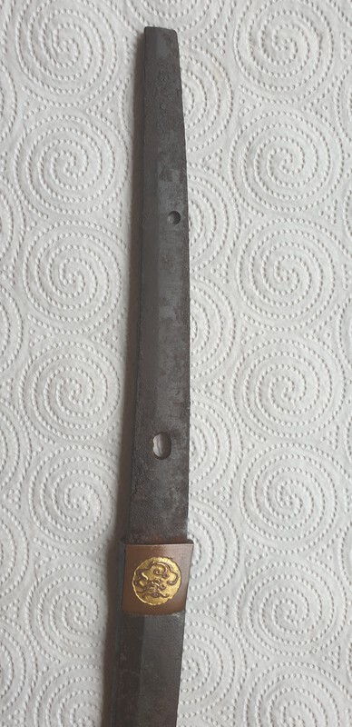

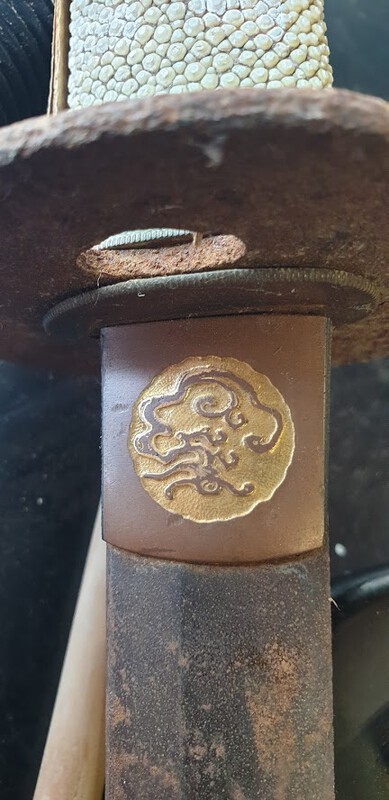

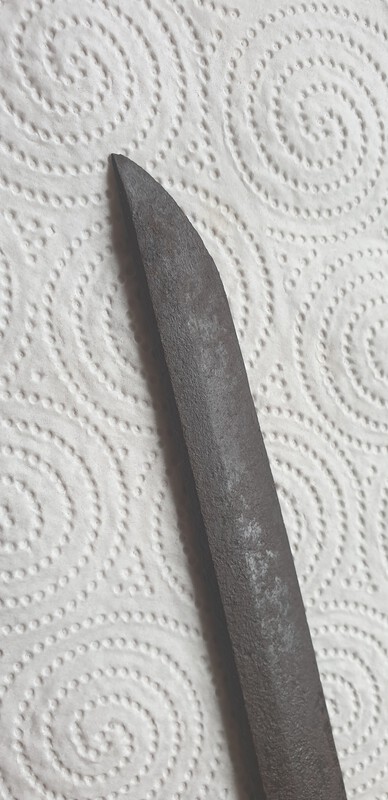

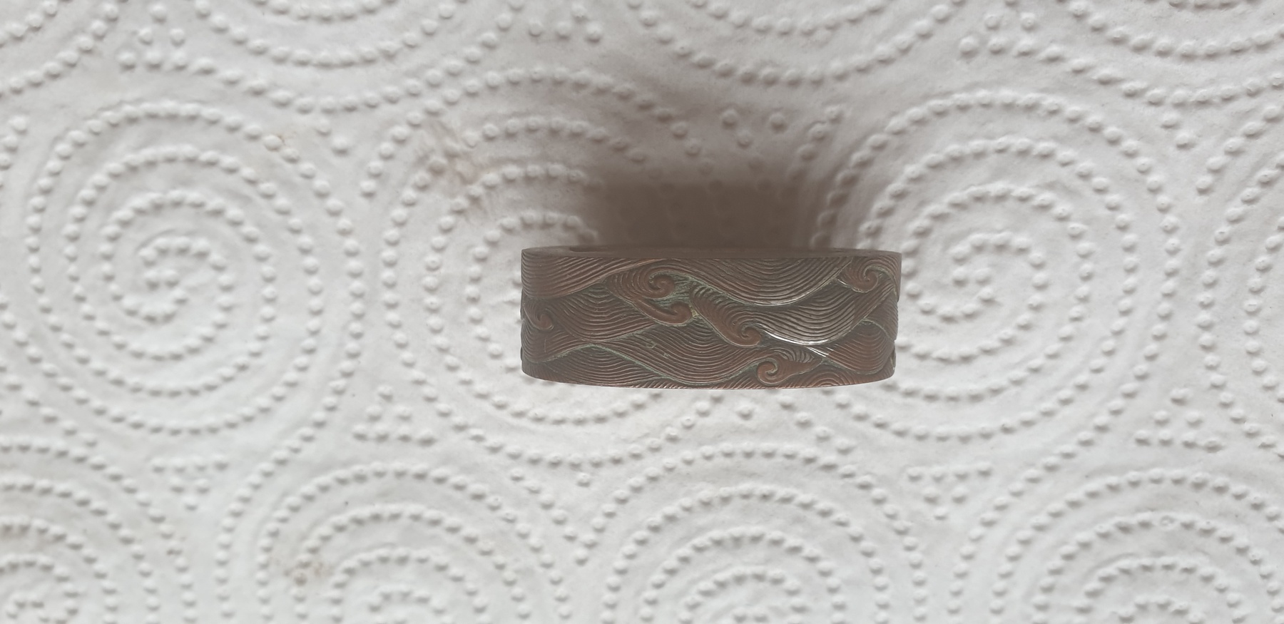

Steve D Posted August 13, 2020 Report Posted August 13, 2020 Hi I'm a new member and have been given an old sword that my late father acquired many years ago. I'm trying to find out some info on it but not sure where to start. It's not in very good condition unfortunately and the chord and handle are in bits and the blade is very rusty. There are no marking that I can see on the tang but there are markings around the collar. As I was trying to remove the handle the chords fell apart but I did notice that there were pieces of paper under the chord which, I believe, helps with the wrapping of the handle. I was hoping someone may be able to help with any info on it. Thanks Steve Quote
SAS Posted August 13, 2020 Report Posted August 13, 2020 Condition is poor but there may be a lot of potential there.....the habaki is quite fancy, which usually indicates a good sword. More knowledgeable people will comment soon, I am sure. Quote
Steve D Posted August 13, 2020 Author Report Posted August 13, 2020 On 8/13/2020 at 7:03 AM, SAS said: Condition is poor but there may be a lot of potential there.....the habaki is quite fancy, which usually indicates a good sword. More knowledgeable people will comment soon, I am sure. Expand Yeah, it's not in great condition. Still very sharp though.. Quote
Shugyosha Posted August 13, 2020 Report Posted August 13, 2020 Hi Steve, Welcome to NMB. I don't think that you're going to get a lot of help from the pictures you have posted: if you are able to post a picture of the whole blade with the guard and habaki off that would help and maybe close-ups of the point and any detail visible along the blade you are more likely to get some comments. Quote
Steve D Posted August 13, 2020 Author Report Posted August 13, 2020 On 8/13/2020 at 8:27 AM, Shugyosha said: Hi Steve, Welcome to NMB. I don't think that you're going to get a lot of help from the pictures you have posted: if you are able to post a picture of the whole blade with the guard and habaki off that would help and maybe close-ups of the point and any detail visible along the blade you are more likely to get some comments. Expand Thanks for the advice. I'll post some more pictures later. Quote

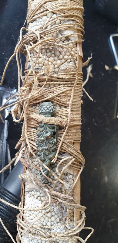

Geraint Posted August 13, 2020 Report Posted August 13, 2020 Dear Steve. There are one or two of us not too far from you , it may be that someone will offer to look at the sword in hand which would be ideal. The handle was wrapped in a very stylish way before it fell to pieces, look after all the bits and see what we can make of it. Above all do not try to clean it up without guidance from someone who knows what they are doing. Looking forward to seeing how this develops with some more pictures. All the best. Quote

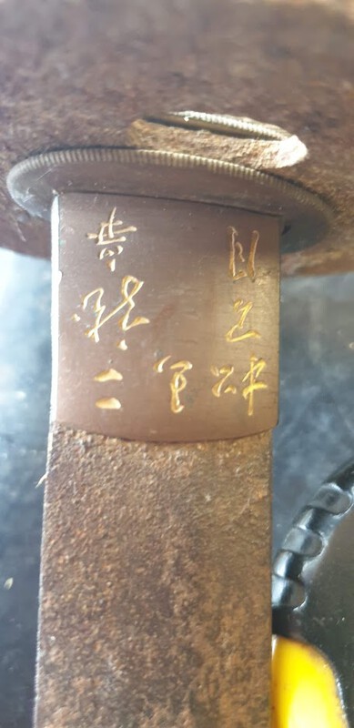

Nobody Posted August 13, 2020 Report Posted August 13, 2020 二龍争玉 – Two dragons fighting for a gem 松間月? – Shokangetsu? (an art name?) – The Moon through pine needles I’m not sure about “間”. 4 1 Quote

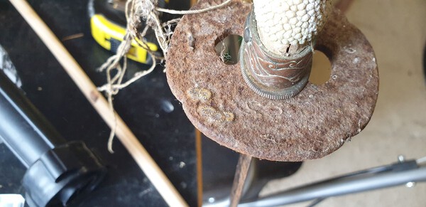

Steve D Posted August 13, 2020 Author Report Posted August 13, 2020 On 8/13/2020 at 10:43 AM, Nobody said: 二龍争玉 – Two dragons fighting for a gem 松間月? – Shokangetsu? (an art name?) – The Moon through pine needles I’m not sure about “間”. Expand Thank you. I've been trying to look through Japanese figures. Here's another pic (with an 1810 du Klingenthal French Napoleonic sword also in the garage): Quote

Brian Posted August 13, 2020 Report Posted August 13, 2020 Is that a tiny part of a Fairbairn Sykes dagger I see in the one pic? 🙂 As mentioned, the wrap and some other details of this sword means it needs to be checked out properly. It looks very interesting. Press out the wooden peg in the handle and the handle will slide off showing the tang, which will tell us a lot. 1 Quote
Steve D Posted August 13, 2020 Author Report Posted August 13, 2020 On 8/13/2020 at 11:07 AM, Brian said: Is that a tiny part of a Fairbairn Sykes dagger I see in the one pic? 🙂 As mentioned, the wrap and some other details of this sword means it needs to be checked out properly. It looks very interesting. Press out the wooden peg in the handle and the handle will slide off showing the tang, which will tell us a lot. Expand Don't have any daggers unfortunately.. I've removed the handle as the chord just fell to pieces but cannot see any markings on the tang. I don't want to try running any rust off just yet... Quote
Brian Posted August 13, 2020 Report Posted August 13, 2020 You can wipe off any loose rust with a soft cloth, and gently wipe until no more rust comes off. But use NOTHING abrasive and don't clean the tang any more than that. Some light oil with a cloth will stabilize the rust. I thought I saw the FS here...no worries 🙂 Quote

k morita Posted August 13, 2020 Report Posted August 13, 2020 On 8/13/2020 at 10:43 AM, Nobody said: 二龍争玉 – Two dragons fighting for a gem 松間月? – Shokangetsu? (an art name?) – The Moon through pine needles I’m not sure about “間”. Expand Hi, 二龍争玉松間月 Ni ryu tama o arasou sho-kan no tsuki. Meaning is: The Moon between two pine trees looks like Two dragons fighting for a gem. 7 Quote
Steve D Posted August 13, 2020 Author Report Posted August 13, 2020 On 8/13/2020 at 11:59 AM, k morita said: Hi, 二龍争玉松間月 Ni ryu tama o arasou sho-kan no tsuki. Meaning is: The Moon between two pine trees looks like Two dragons fighting for a gem. Expand Thank you 😀 Quote
Babu Posted August 13, 2020 Report Posted August 13, 2020 The Ito that's come undone was jabbara I think which is more decorative than a functional wrap. As you can see it's not very durable. Even though rusty if it's all on the surface it might be salvageable by a good polisher. Quote

Brian Posted August 13, 2020 Report Posted August 13, 2020 That is really, really sad that it got into that condition. It would take a good polisher if it can be saved, But the shape hints at something good. Get it to a good polisher and ask his opinion and to open a window. It may be worth it. Get it well oiled asap. NO abrasives. Quote
Brian Posted August 13, 2020 Report Posted August 13, 2020 Hmm..just saw the second pic. Nice sugata. I wonder how many pm offers are coming in? I like it. Hopefully it wasn't burned. Take your time on this. 1 Quote
Steve D Posted August 13, 2020 Author Report Posted August 13, 2020 Thanks for the kind words. Just given the blade an oil & wipe down as instructed.. Here's the handle & collar (tsuka & fuchi?) Quote
