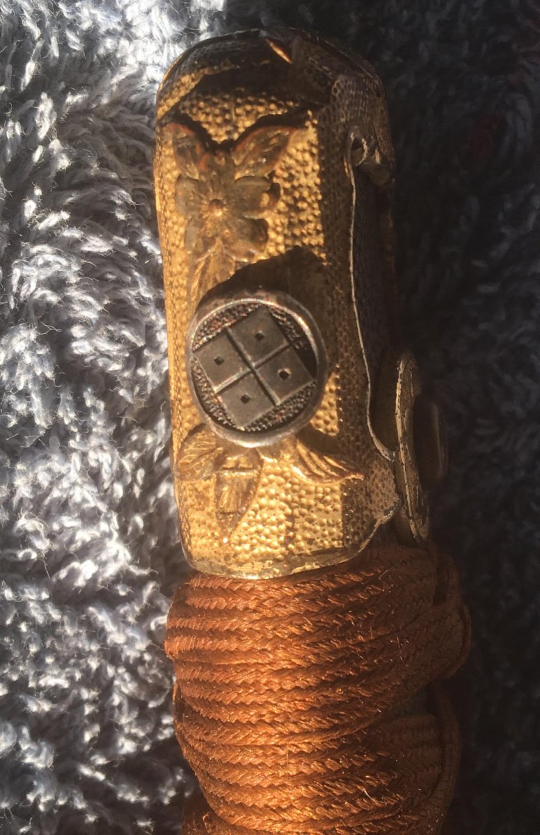

IJASWORDS Posted August 11, 2020 Report Posted August 11, 2020 Dave, I can't disagree with you, but following your explanation, surely a Navy officer from a Samurai family would be more inclined to put his clan mon on his sword? None of my Minatogawas have mons, and these are senior officers that could afford it. Any way here is one of mine, on a family blade. 5 Quote

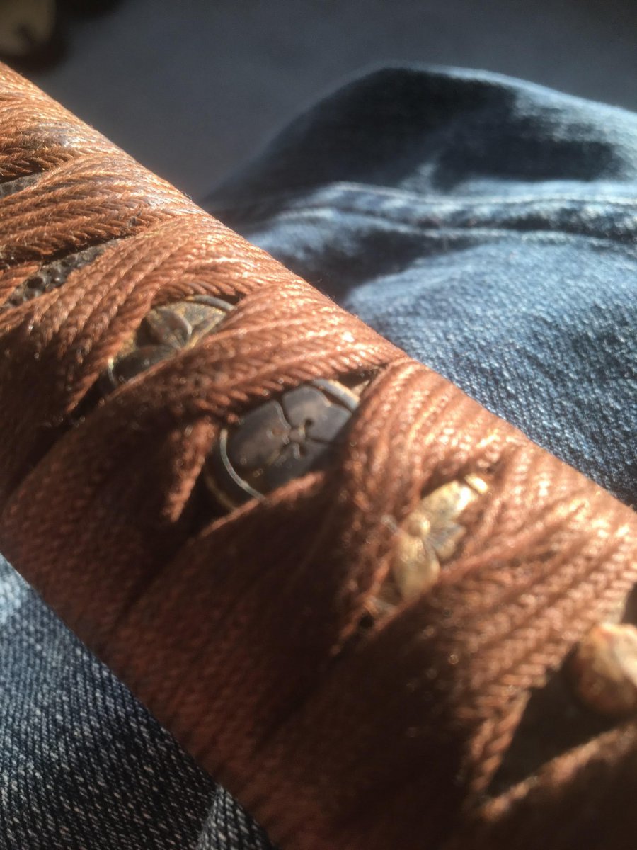

IJASWORDS Posted August 11, 2020 Report Posted August 11, 2020 Ok, did a double check on my Kais, and found a another mon on a menuki. 5 Quote
Geraint Posted August 11, 2020 Report Posted August 11, 2020 Neil. I love that you have only just noticed that mon on the menuki! All the best. 2 Quote
PNSSHOGUN Posted August 11, 2020 Author Report Posted August 11, 2020 Two fine examples, thank you Neil. I think Mon on the Kashira are even rarer still, most examples seen have them on the Menuki. You also touch on something interesting, considering how many high quality Kai Gunto you have in your collection and only two of them have Mon, if you set aside the same number of equal or comparable quality Shin Gunto how many of them would have Mon? There has to be some determining factor in why we don't see them as often on Kai Gunto, perhaps it is just a matter of numbers but I suspect there is something deeper and more interesting at work. 1 Quote

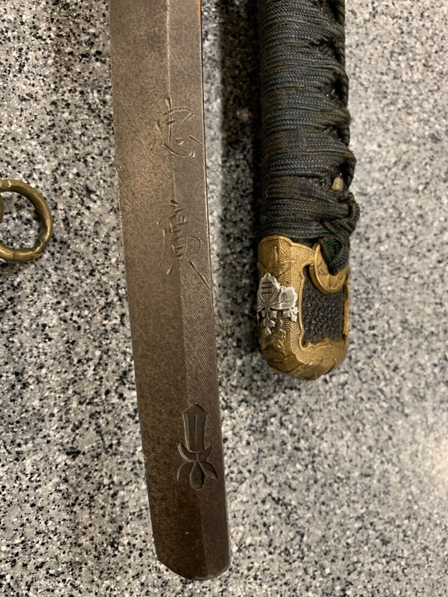

Bazza Posted September 2, 2020 Report Posted September 2, 2020 (edited) I have only one Kaigunto for all my years of collecting and it has a mon on one of the menuki. The other menuki has been swindled out so I cannot comment on that one. There is also a stamp on the seppa against the habaki that I'll include here for interest. I'll post the entire sword and suite of photos in the "Show us your high quality gunto" thread when I can find the right Round Tuit. BaZZa. Edited September 2, 2020 by Bazza spelling error corrected 8 Quote
Bruce Pennington Posted September 3, 2020 Report Posted September 3, 2020 15 hours ago, Bazza said: There is also a stamp on the seppa Barry, Richard Fuller says that is the Toyokawa Navy Arsenal stamp on fittings. It might be, but I'm starting to investigate the idea that it's an actual stamp from a koshirae shop, associated with the arsenal, sure, but a separate shop like Tenzoshan was. The Toyokawa stamp on blades is an anchor in a circle, not a sakura. Thanks for the nice example! Quote
