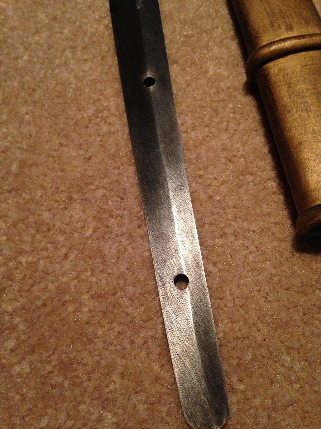

Can you show us the nakago, close-up of the NCO Type 95, and the serial number on the blade?  It should have a small inspector stamp along side the number, too.
Is is coincidence that the 95 is missing a tsuka, and there is a lone tsuka, though officer, in his collection?  Most likely grabbed from a pile to go on the bare blade, but I wonder if the mekugi holes line up when you put the tsuka on the 95?

Bruce, I will get close ups of your requests on Tuesday.  Regarding the type 95, the tsukas in our possession and mekugi ana do not align :( As far as I understand it, that officer tsuka was "attached" to the 95, but probably by grease or rust or something.

No notable markings on either side of the 95 nakago that I could see, but there's your serial number and stamp, as requested.

So, the blade IS a late-war Type 95 NCO blade, made by Seki shops for the Nagoya Army Arsenal.  The saya is correct and likely original to the blade.  The end of the nakago (tang) has been cut off, and the original handle (tsuka) should be wooden.  I have one just 2,000 numbers earlier than yours (211894 Seki) and I'm posting pics of the tsuka and nakago for comparison.  It's possible yours took some battle damage and the repair team cut the end off.  Many of these war trophies came home missing parts.  If the tsuba (hand-guard) is correct, then all you're missing is the tsuka.

That's what I thought.  With mixed items like this there are usually 3 choices: 1. All original, 2. G.I. has a gunto with missing parts, scrounges the sword piles to find stuff to fit, and 3. Post-war piece-together.  Since you know the full story of this one, Choice 3 is out, leaving the first two.  The most obvious choice is #2 - he picked up the gunto, missing parts, and scrounged around to find some that fit.
The small black seppa is correct for a late-war Type 95, so we only have the tsuba and tsuka to wonder about.  I haven't seen a habaki.  Is there one, or is it missing?  If it's missing, it could explain why the mekugi ana don't line up.
I'm plagued by the shortened nakago, though.  There was a program early in the war for officers to buy Type 95 (or rent) gunto because of shortages.  What little we know of the program, though, makes is seem to be during the early years.  I haven't heard of it lasting into the end of the war, but that doesn't mean it wasn't still being done.  This, to me, has the appearance of a blade that was intentionally shortened to take the officer tsuka (and Oh, BTW, it's got an officer tsuka on it!).  Another purely speculative idea is that an NCO, just graduating from officer candidate school, had his 95 modified for the officer handle.  But I'm WAY into pure speculation.
All we know, in fact, is you have a late-war Type 95 with a modified nakago and an officer tsuba and tsuka!  And you know some Bubba didn't do this to the sword post-war.
Nothing wrong with the lack of markings on the nakago.  The blade is coming from a Seki made Type 95 Military Sword, serial number 関213182.  The handle should be made of wood and the handle fittings of iron as Bruce indicated in post #20.  If possible, can you post a picture of the scabbard mouth opening (鯉口 koiguchi)?  There could be some markings in that location.
